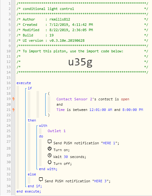

I’m a newbie to webcore and I’m trying to figure out the subtle nuances of the system. What I’m trying to do with this piston is turn on a light for 30 seconds after a door opens (and potentially closes)
Door opens, light comes on and stays on for 30 seconds regardless of whether door closes or not
Open Sensor is read, light comes on and timer starts, but once door closes, timer stops thus light never goes off (unless door is left open > 30 seconds)

I’m sure there is a simple solution to this but I’m just not seeing it. Any assistance is appreciated !!!
I would start with something like this:
IF
   Contact Sensor CHANGES TO open
   and
   Time is between X and Y
      With Outlet  (TCP set to Never)
      Send PUSH
      Turn on
      Wait 30 seconds
      Turn off
END IF
If you really want to use an ELSE, then I would program a bit differently.
You need to use NEVER CANCEL TASK when using WAIT.
LIne 24…
Click in the WITH
You’ll see a wheel icon - Click
scrool down and choose NEVER CANCEL TASK
once done, you’ll see an orange cicrle next to WITH.
And change line 19 to CHANGES TO OPEN
*blows smoke from his fingertips* :sunglasses:
You beat me to it with seconds LOL
works like a charm now. Thanks everyone for their input and education!
