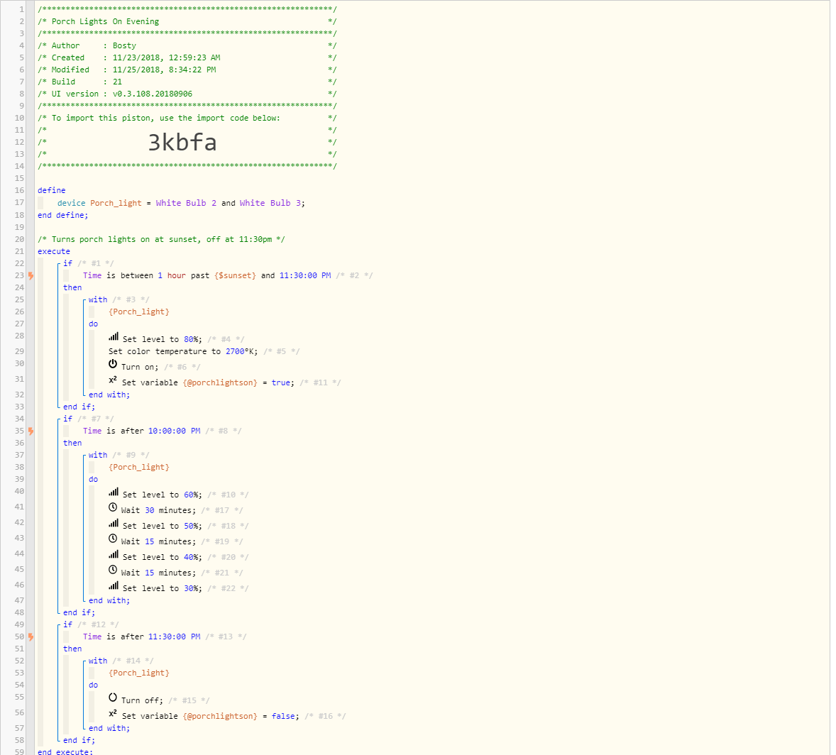

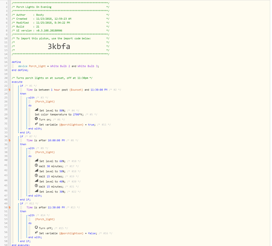

Light Piston loops
The piston starts fine and runs through the scenario but at the end, 11:30pm, it starts over at the 10:00pm settings.
The piston starts at 1 hour past sunset, then at 10:00pm, the lights starts to dim and shut off for the night at 11:30pm.
The lights dim at 10:00pm then at 11:30, it restarts at the 10:00pm dimming again.
11/25/2018, 11:32:09 PM +923ms
+81ms ╔Stopping piston…
+201ms ╚Piston successfully stopped (121ms)
11/25/2018, 11:29:59 PM +87ms
+1ms â•”Received event [Home].time = 1543206600000 with a delay of -913ms
+85ms â•‘Runtime (40404 bytes) successfully initialized in 44ms (v0.3.108.20180906) (83ms)
+86ms â•‘â•”Execution stage started
+359ms â•‘â•‘Executed [Porch Light Left].setLevel (14ms)
+372ms â•‘â•‘Executed [Porch Light Right].setLevel (12ms)
+377ms â•‘â•‘Executed virtual command [Porch Light Left, Porch Light Right].wait (1ms)
+378ms â•‘â•‘Requesting a wake up for Sun, Nov 25 2018 @ 11:59:59 PM EST (in 1800.0s)
+982ms â•‘â•‘Executed [Porch Light Left].setLevel (10ms)
+994ms â•‘â•‘Executed [Porch Light Right].setLevel (10ms)
+998ms â•‘â•‘Executed virtual command [Porch Light Left, Porch Light Right].wait (1ms)
+1000ms â•‘â•‘Requesting a wake up for Mon, Nov 26 2018 @ 12:00:00 AM EST (in 1800.0s)
+1009ms ║╚Execution stage complete. (923ms)
+1013ms â•‘Setting up scheduled job for Sun, Nov 25 2018 @ 11:59:59 PM EST (in 1799.367s), with 5 more jobs pending
+1034ms ╚Event processed successfully (1034ms)
11/25/2018, 10:59:56 PM +59ms
+1ms â•”Received event [Home].time = 1543204797211 with a delay of -1152ms
+63ms â•‘Runtime (40402 bytes) successfully initialized in 30ms (v0.3.108.20180906) (61ms)
+65ms â•‘â•”Execution stage started
+106ms â•‘â•‘Executed [Porch Light Left].setLevel (10ms)
+118ms â•‘â•‘Executed [Porch Light Right].setLevel (10ms)
+145ms ║╚Execution stage complete. (81ms)
+148ms â•‘Setting up scheduled job for Sun, Nov 25 2018 @ 11:30:00 PM EST (in 1803.794s), with 2 more jobs pending
+156ms ╚Event processed successfully (156ms)
11/25/2018, 10:44:57 PM +58ms
+0ms â•”Received event [Home].time = 1543203898285 with a delay of -1228ms
+85ms â•‘Runtime (40402 bytes) successfully initialized in 45ms (v0.3.108.20180906) (84ms)
+132ms â•‘â•‘Executed [Porch Light Left].setLevel (15ms)
+146ms â•‘â•‘Executed [Porch Light Right].setLevel (13ms)
+151ms â•‘â•‘Executed virtual command [Porch Light Left, Porch Light Right].wait (0ms)
+152ms â•‘â•‘Requesting a wake up for Sun, Nov 25 2018 @ 10:59:57 PM EST (in 900.0s)
+160ms ║╚Execution stage complete. (74ms)
+163ms â•‘Setting up scheduled job for Sun, Nov 25 2018 @ 10:59:57 PM EST (in 899.991s), with 3 more jobs pending
+172ms ╚Event processed successfully (171ms)
11/25/2018, 10:29:58 PM +64ms
+1ms â•”Received event [Home].time = 1543202999718 with a delay of -1654ms
+126ms â•‘Runtime (40402 bytes) successfully initialized in 66ms (v0.3.108.20180906) (123ms)
+128ms â•‘â•”Execution stage started
+191ms â•‘â•‘Executed [Porch Light Left].setLevel (18ms)
+210ms â•‘â•‘Executed [Porch Light Right].setLevel (16ms)
+218ms â•‘â•‘Executed virtual command [Porch Light Left, Porch Light Right].wait (1ms)
+220ms â•‘â•‘Requesting a wake up for Sun, Nov 25 2018 @ 10:44:58 PM EST (in 900.0s)
+231ms ║╚Execution stage complete. (104ms)
+236ms â•‘Setting up scheduled job for Sun, Nov 25 2018 @ 10:44:58 PM EST (in 899.986s), with 3 more jobs pending
+246ms ╚Event processed successfully (245ms)
11/25/2018, 9:59:59 PM +122ms
+0ms â•”Received event [Home].time = 1543201200000 with a delay of -879ms
+101ms â•‘Runtime (40404 bytes) successfully initialized in 46ms (v0.3.108.20180906) (99ms)
+103ms â•‘â•”Execution stage started
+212ms â•‘â•‘Executed [Porch Light Left].setLevel (23ms)
+223ms â•‘â•‘Executed [Porch Light Right].setLevel (8ms)
+441ms â•‘â•‘Executed [Porch Light Left].setColorTemperature (211ms)
+468ms â•‘â•‘Executed [Porch Light Right].setColorTemperature (25ms)
+476ms â•‘â•‘Executed [Porch Light Left].on (5ms)
+490ms â•‘â•‘Executed [Porch Light Right].on (12ms)
+500ms â•‘â•‘Executed virtual command [Porch Light Left, Porch Light Right].setVariable (3ms)
+575ms â•‘â•‘Executed [Porch Light Left].setLevel (22ms)
+588ms â•‘â•‘Executed [Porch Light Right].setLevel (11ms)
+594ms â•‘â•‘Executed virtual command [Porch Light Left, Porch Light Right].wait (1ms)
+595ms â•‘â•‘Requesting a wake up for Sun, Nov 25 2018 @ 10:29:59 PM EST (in 1800.0s)
+615ms ║╚Execution stage complete. (513ms)
+619ms â•‘Setting up scheduled job for Sun, Nov 25 2018 @ 10:29:59 PM EST (in 1799.978s), with 3 more jobs pending
+629ms ╚Event processed successfully (628ms)

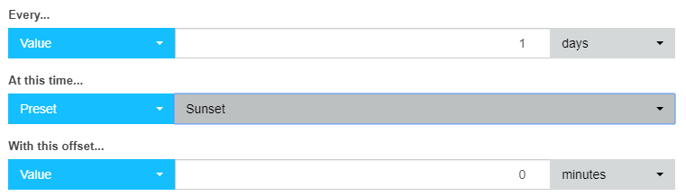

Try using every day at 10:00 PM instead of Time is after. I believe it will loop since after 11:30 PM when the time changes it is still after 10:00PM so the statement becomes true and then it performs your tasks.
Makes sense. I’ll try that tonight.

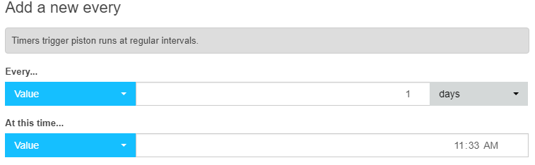

ok, silly question. Is that Time happens daily at 10:00 PM? If not, how do i get that statement?

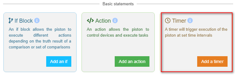

There’s another one… I think it’s under Timer? Will verify.
Edit: Like this one…

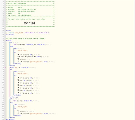

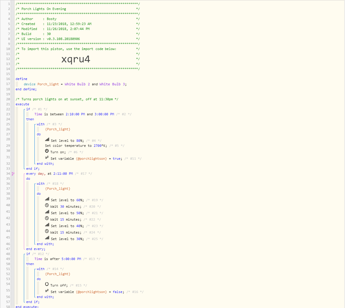

So I changed the statement to every day and now the first statement doesn’t run. It starts with the every day statement. So in this example, it starts at 2:11 PM not 2:10 PM.

You can change the first statement to the everyday at Sunset (and corresponding offset). Also, if your bulbs turn on when the set level is sent, you can drop the Turn on task.
That seems to work… I actually just changed all if statements to every day. Thanks for the help eibyer.
