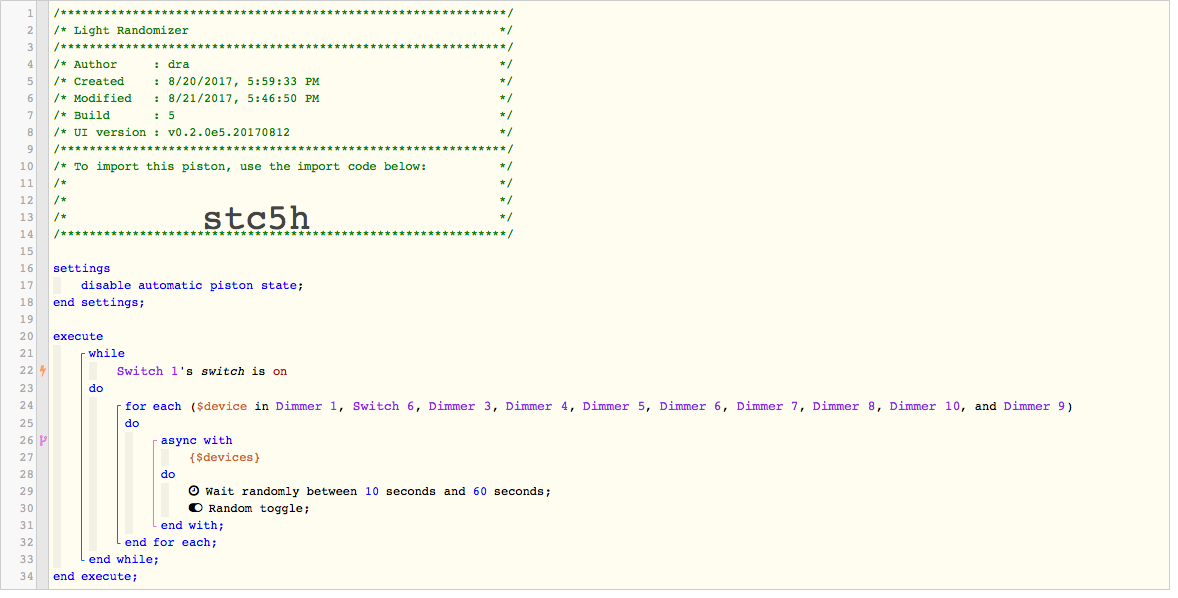

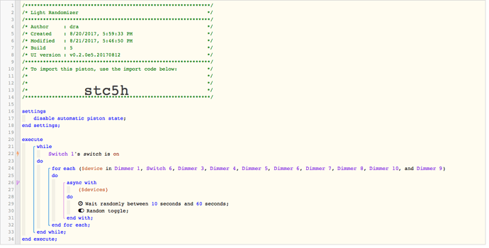

I’m trying to create a piston that will randomly turn a set of lights on and off when a virtual switch is set to ON. I’m trying to do this with a “while” statement and a “for each” statement, but so far I’m not having success with lights actually activating. I suspect it has something to do with my “wait” command.
Any help would be appreciated!
Try switching the $devices and $device.
Also logs will help us solve issues
Log is below. I changed $devices in my original example to $device before running this.

This is when you are switching the switch off.
Nothing populates in the log when I switch it on. However, I have another piston setup to report back a piston state for the switch, so I know it’s working…
@Robin where is your vacation light manager. Will help get @dra started down the right path
I started with that as a base…perhaps I’ll jump back to that and start over.
Yea I would recommend starting over

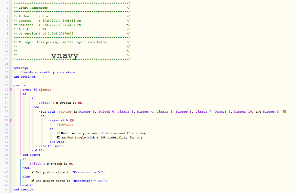

Well, I got it to work by using @Robin’s vacation lights as a more direct starting point. My goal was to have the randomization start when the switch flipped to ON and run until it flipped to OFF. This version will check the switch every 30 minutes, which functionally works just fine (I’m only annoyed that I can’t figure out how to make the program do what I originally intended!).
