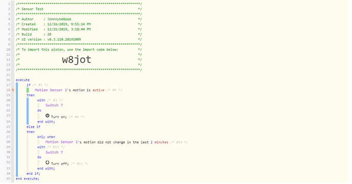

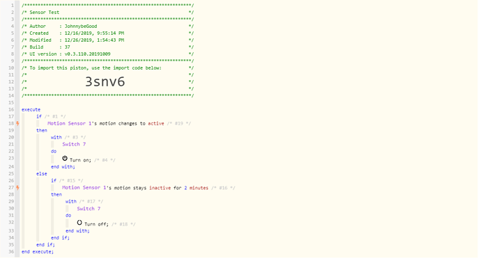

I’ve created this simple piston where when no motion is detected it suppose to turn off office light.
While there’s motion do not turn off the light. I’m sure there’s something obvious that I missed
But for some reason after 2 minutes light continues to stay on. I’ve tried with 10 minutes but got same results.
