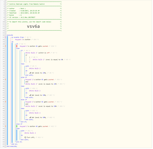

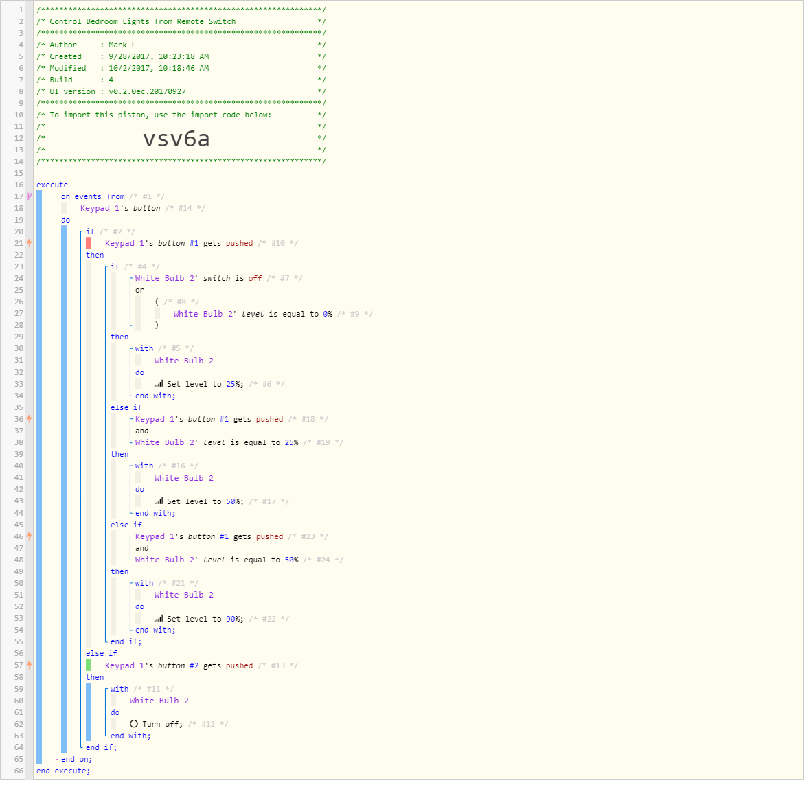

Not sure if this will help, but here’s what I did. I just look at the button press, not the state. If one button gets pushed, I increment the level of the lights. If the other button gets pushed, I turn the lights off. I think I’m using a custom device handler as the original one didn’t recognize the individual button pushes.
Yes, but your “switch” is showing up with Keypad capabilities. That’s why it’s showing up in your green screenshot as Keypad 1. so, what type of switch do you have and what DTH are you using?
The GE Zwave switches have two “button” functions you can pull out and use in WebCore if you have the right DTH. If you double tap up it comes as button 1 and if you double tap down it comes as button 2. But these are independant of the load side of the switch. Of course, you could respond to these by changing the state of the load on the z-wave switch as well. But you’d have to include that in your WebCore piston. But there is no DTH for any switch that I know of that would detect a press of a button irregardless of the state of the switch.
