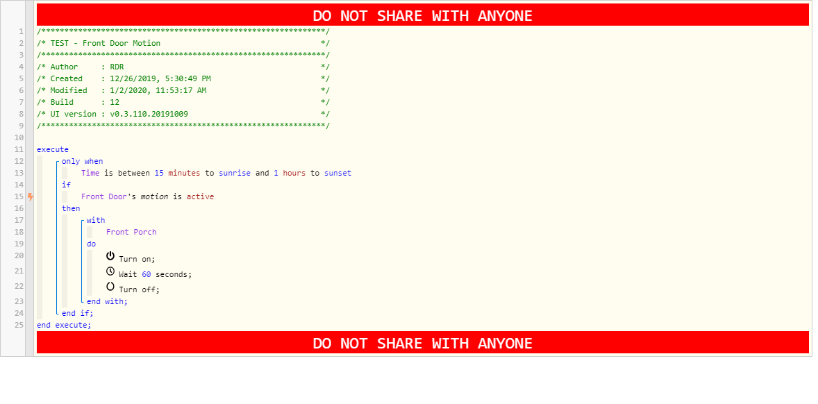

Light will not turn off after 1 minute once Ring motion is activated
Light should turn off after 1 minute
Light does not turn off after waiting 1 minute
1/2/2020, 11:49:11 AM +176ms
+0ms ╔Received event [My home].time = 1577994552775 with a delay of -1600ms
+88ms ║Runtime (37799 bytes) successfully initialized in 49ms (v0.3.110.20191009) (87ms)
+90ms ║╚Execution stage complete. (1ms)
+91ms ╚Event processed successfully (90ms)
1/2/2020, 11:48:52 AM +137ms
+1ms ╔Received event [Front Door].motion = inactive with a delay of 77ms
+82ms ║Runtime (37789 bytes) successfully initialized in 33ms (v0.3.110.20191009) (80ms)
+122ms ║╚Execution stage complete. (39ms)
+123ms ╚Event processed successfully (123ms)
1/2/2020, 11:48:12 AM +630ms
+1ms ╔Received event [Front Door].motion = active with a delay of 59ms
+78ms ║Runtime (37794 bytes) successfully initialized in 39ms (v0.3.110.20191009) (76ms)
+79ms ║╔Execution stage started
+138ms ║║Executed [Front Porch].on (18ms)
+143ms ║║Executed virtual command [Front Porch].wait (0ms)
+144ms ║║Requesting a wake up for Thu, Jan 2 2020 @ 11:49:12 AM PST (in 60.0s)
+148ms ║╚Execution stage complete. (69ms)
+150ms ║Setting up scheduled job for Thu, Jan 2 2020 @ 11:49:12 AM PST (in 59.996s)
+157ms ╚Event processed successfully (156ms)
