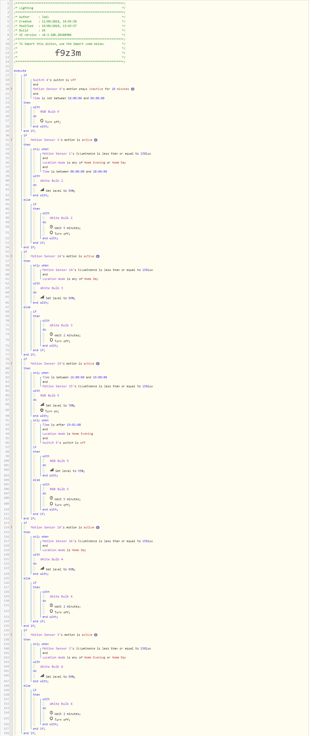

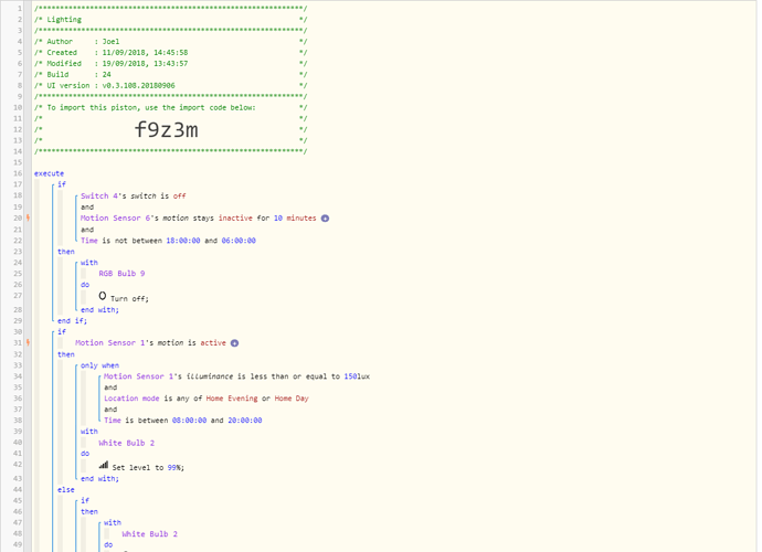

Lighting piston not working 99%
My lighting piston for different motion sensors and lights in the same room work sometimes and not others.
Note: the first section of the piston seems to work (it only turns light off) and also the one with the timing conditions (between x and y time) works as well.
I do have it set to 99% as my zigbee lightswitch has a bug in it where if you set it to 100% it won’t turn on. has to be 99%. hence why i’m not using standard smartthings lighting rules.
If motion is active - turn light on. if not active for x minutes, turn off.
the lights are mostly not turning on at all and the home mode is indeed home day and the illuminence is below the threshold.

specifically the if’s that are not working are on lines: 56, 114 & 137
thank you hoping someone can help.
NOTE: I have tried to : Changes to and is active.
I found the wait 2 minutes trick from another thread also as they originally were not turning off at all.
The general rule of thumb I usually follow for motion detects is:
IF Motion sensor's motion CHANGES TO active
and
Conditions (optional)
  With Bulb
    Turn on
  End with
End IF
IF Motion sensor's motion STAYS inactive for 2 minutes
  With Bulb
    Turn off
  End with
End IF
Also, it is important to note that motion sensors communicate a LOT. Often the ‘active’ signal is passed over 10 times a minute per sensor. Each and every time ANY of them trigger (active or inactive), then the entire piston will run thru the code top to bottom. With 6 motion sensors in the same piston, each potentially firing 10 times a minute, well, let’s just say that this can seriously impact your entire network and ST’s reliability.
A better method is placing each motion sensors in it’s own piston, and using the “changes to” like I mentioned above. This will reduce your SmartHome’s network chatter to about 1% of what it is now.
Thank you. So having separate if statements for each on and off. And a separate piston as well should solve this ?
Memory usage is high on this one.74% so you must be right.
Yes, but also “motion CHANGES TO active” is key, because that makes sure the piston only triggers once when someone first enters the room. Not each and every time they scratch their nose.
that seems to have solved the issue thank you
Glad to help!
