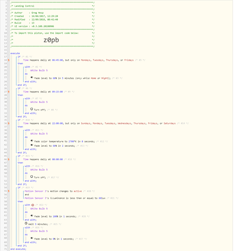

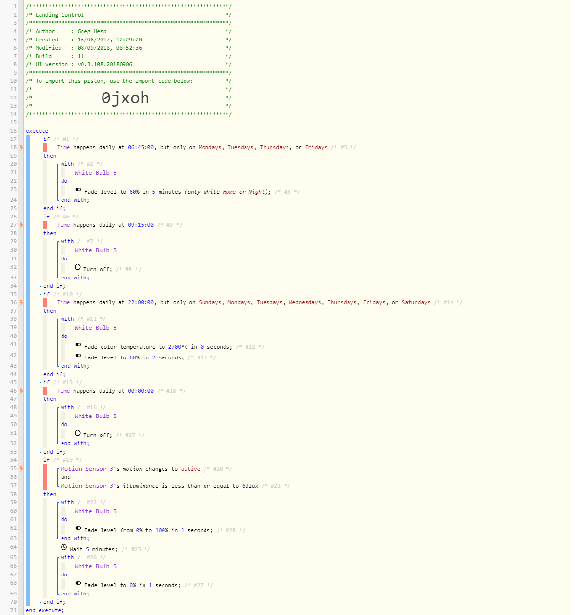

I’ve got the below light which is setup to come on a schedule as below.
What I am trying to achieve here, is so that if motion is detected (last statement) the light turns on, and then turns off after 5 minutes. This should only happen if the light isn’t turned on via a schedule
What I’m currently finding though is that when the light is on, if motion is detected, the light turns off and then back on and I can’t figure out why. Any ideas?

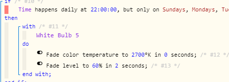

This is probably not related but why are you doing this.
Why not ‘Set Color’ to… You are doing it in 0 seconds anyway.
Same for the fade. Set to 60%. Again is it worth fading up over 2 seconds.

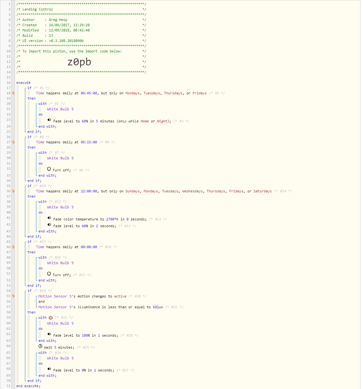

I’ve changed my piston to:

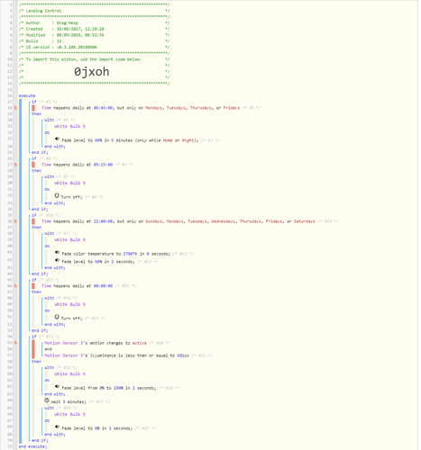

You mentioned the if the lights are on and motion is detected, the light turns off and then back on… the piston is doing what line 62 says… Fade level from 0% to 100%. If it’s currently at 50%, it will drop to 0% first then do the fade.

I believe setting the command to:
Fade level to 100%
Will start the process at it’s current level
Yep that was the issue, completely missed that. Thanks!
