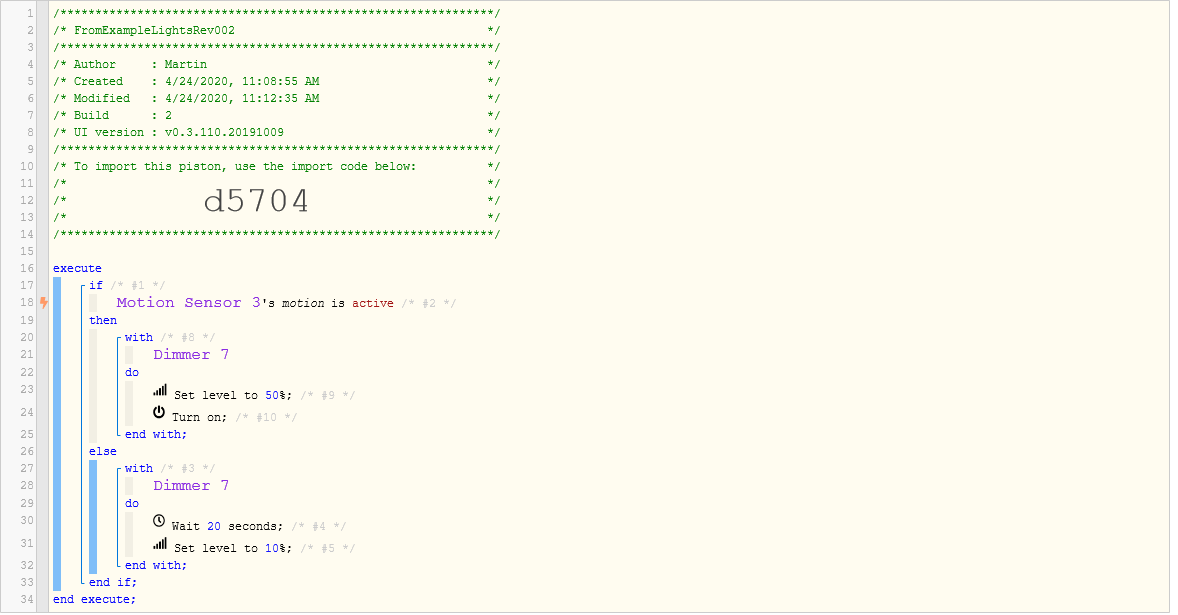

Lights activate on motion piston don't reset wait condition

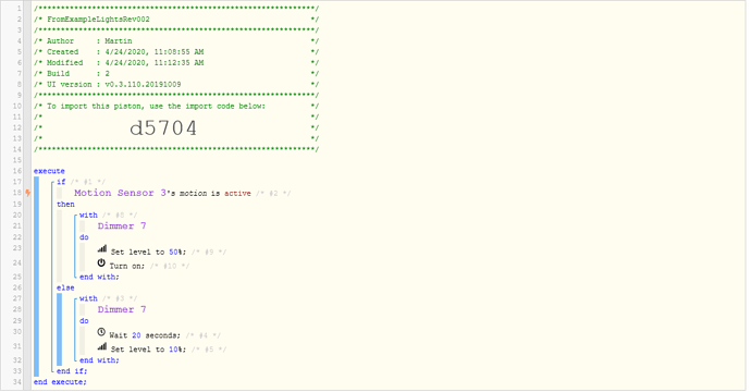

HI I’m new with webcore , I’m having an issue with a very simple piston that I don’t understand. Obviously I’m missing something here.
I simplified this piston example to replicate the issue in the best possible way.
If motion is detected the second time right after the dimmer goes to 10% it doesn’t execute the if condition. only works if motion is detected few seconds after else condition is executed.
1)Motion is detected in the sensor then turns the light ON and dimmer is set level to 50%
2)If motion is no detected for 20 sec then dimmer set level to 10% (eventually turn off but I removed that part because that’s not part of the problem)
3)if motion is detected again while wait it will set the level back to 50%
This piston works ! the problem only happens when the motion is detected “immediately” after the 20 sec and set level to 10%, the IF is showing true again( motion sensor active) but it doesn’t execute that part of the piston to go back to set level 50%.
It seems that it is too fast and the piston is not ready and miss the motion active condition. Therefore, I have to wait until motion is inactive and then active again. (witch forces us to wait with the lights at 10% waving on the sensor for other 10 secs or more)
If motion is detected after 3 o more seconds of set level to 10% it works … the issue is only happening when motion is detected right after the else statement.

Script
/* FromExampleLightsRev002                                    */
/* Author     : Martin                                        */
/* Created    : 4/24/2020, 11:08:55 AM                        */
/* Modified   : 4/24/2020, 11:12:35 AM                        */
/* Build      : 2                                             */
/* UI version : v0.3.110.20191009                             */
+0msstart
/* Trace started on 4/24/2020, 11:16:24 AM (about 5 minutes ago) */
execute
+310ms27ms
if /* #1 */
Test_Motion's motion is active /* #2 */
then
with /* #8 */
WebKitchen Dimmer
do
Set level to 50%; /* #9 */
Turn on; /* #10 */
end with;
else
+315ms22ms
with /* #3 */
WebKitchen Dimmer
do
+318ms? ? ?
Wait 20 seconds; /* #4 */
+319ms18ms
Set level to 10%; /* #5 */
end with;
end if;
+337msdone
end execute;
+348msstop
/* Trace ended on 4/24/2020, 11:16:24 AM */

+72ms 	¦¦Cancelling statement #3's schedules...
+76ms 	¦¦Executed virtual command [WebKitchen Dimmer].wait (0ms)
+77ms 	¦¦Requesting a wake up for Fri, Apr 24 2020 @ 11:14:24 AM MDT (in 20.0s)
+81ms 	¦+Execution stage complete. (22ms)
+82ms 	¦Setting up scheduled job for Fri, Apr 24 2020 @ 11:14:24 AM MDT (in 19.996s)
+91ms 	+Event processed successfully (91ms)
4/24/2020, 11:13:44 AM +915ms
+1ms 	+Received event [Test_Motion].motion = active with a delay of 76ms
+52ms 	¦RunTime Analysis CS > 15ms > PS > 30ms > PE > 7ms > CE
+54ms 	¦Runtime (37091 bytes) successfully initialized in 30ms (v0.3.110.20191009) (53ms)
+55ms 	¦+Execution stage started
+62ms 	¦¦Comparison (enum) active is (string) active = true (1ms)
+63ms 	¦¦Cancelling condition #2's schedules...
+64ms 	¦¦Condition #2 evaluated true (5ms)
+65ms 	¦¦Cancelling condition #1's schedules...
+65ms 	¦¦Condition group #1 evaluated true (state changed) (7ms)
+67ms 	¦¦Cancelling statement #8's schedules...
+77ms 	¦¦Executed physical command [WebKitchen Dimmer].setLevel([50]) (6ms)
+78ms 	¦¦Executed [WebKitchen Dimmer].setLevel (8ms)
+85ms 	¦¦Executed physical command [WebKitchen Dimmer].on() (5ms)
+86ms 	¦¦Executed [WebKitchen Dimmer].on (7ms)
+88ms 	¦+Execution stage complete. (33ms)
+89ms 	+Event processed successfully (89ms)

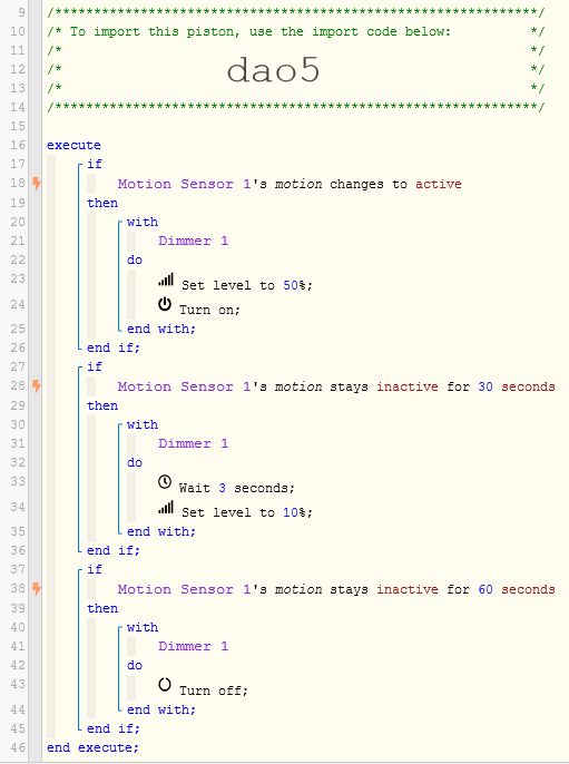

Here is how I would do this. (3 triggers in a single piston)
IF Sensor's motion changes to active
    Then Set Dimmer level to 50%
END IF
IF Sensor's motion stays inactive for 30 sec
    Then Set Dimmer level to 10%
END IF
IF Sensor's motion stays inactive for 5 minutes
    Then Set Dimmer switch to off
END IF
The latter two blocks are cancelled anytime motion is detected.

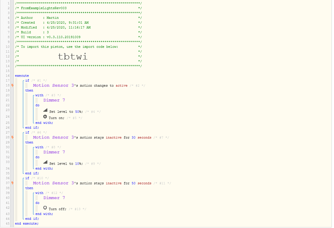

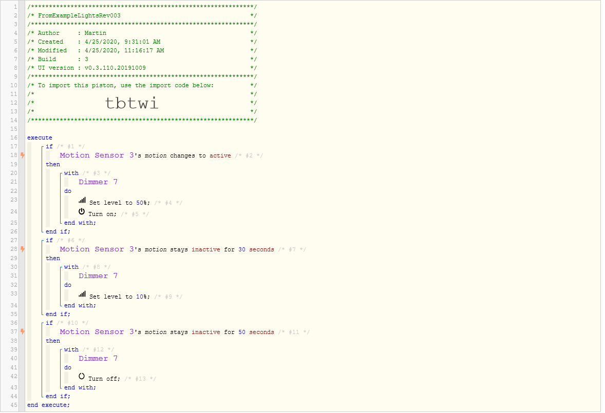

Hi Dear. I did modify the logic as per your suggestions.
Here is the piston that I tested.
The issue is still happening only when the motion sensor detects motion right after lights dimm to 10% . If I wait 3 to 4 seconds after dimms to 10% the piston works fine.
I also notice that when the lights goes OFF in the last condition they can turn back on immediately , It means this issue doesn’t appear to happen here.
It makes me think that the problem could be in the dimmer itself not i
n the piston I I can see the piston working , but the level just doesn’t change.
I’m using an zooz ZEN27 dimmer . I’ll test this with a different dimmer . Maybe it’s not fast enough to change the level as it is to turn on the lights, and it miss the command to change the level the first time. I experienced the same effect trying to do this with an standard automation in smartthings , that is why I tried with webcore.
Let me know if this makes sense to you .
Thank you
You may be able to add a short wait before setting the level to 10%
This is good, right?
We just need to get this quick reaction time for the 10%.
This slight variation may do the trick:
Side Note:
You may want to clear your logs, and set the level to Full for future troubleshooting.
(the log in your first post shows that all commands were sent properly)
Hi Thank you for you replay!
I have tried that, It didn’t work because it was like adding 3 sec to the IF condition, (wait 33 instead of 30) but the issue’s still occur after set level changes.
I think I need to find the way to delay the sensor in sending a motion to the first IF.
Maybe adding a variable that I can delay the sensor for few seconds giving time for the dimmer to be ready. Maybe play with executions methods could it help here? Or execution policies? I’m not too familiar with the implications of changing those.
In a real life when the lights dim to 10% in the kitchen sometimes you move right after and that triggers this weird condition that keep you in the dark.
Thank you very much for helping me with this.!
Martin

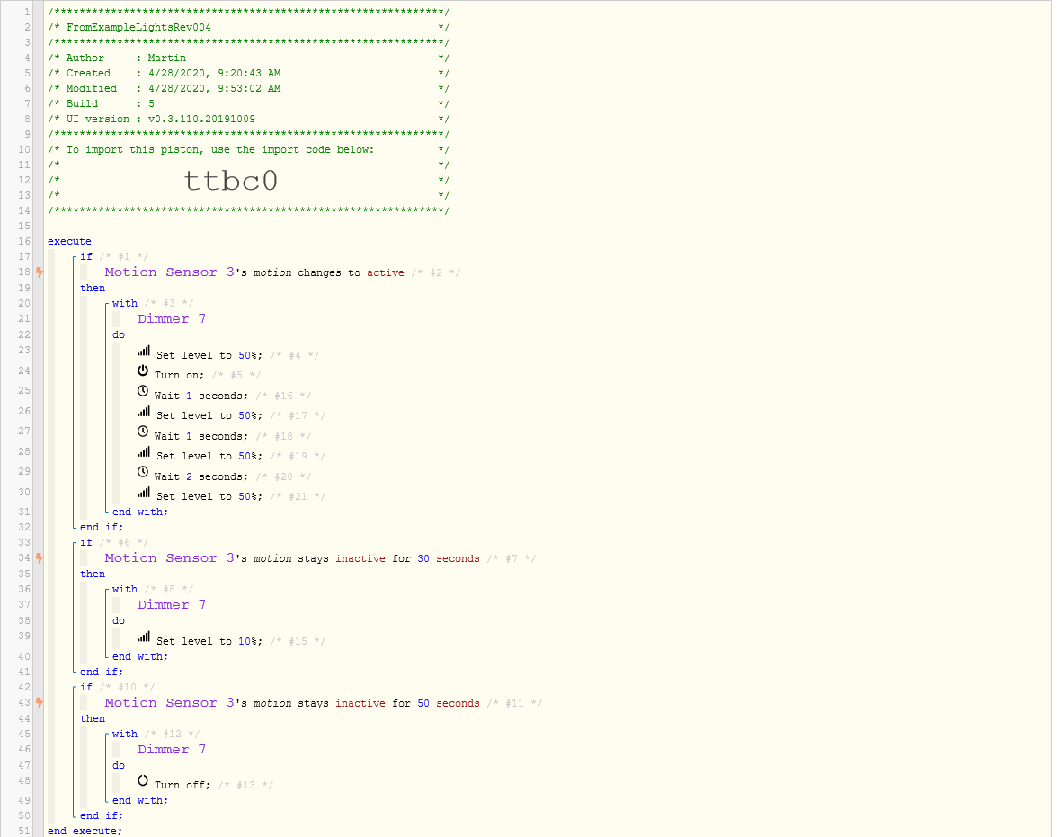

For what it’s worth, the easiest solution would be to increase your “inactive” alert to something longer… (2 or 3 minutes seems to be the “norm”) This should give ample time for the sensor to detect additional motion (if you are walking around in the kitchen), yet will still shut off shortly after the room is vacated.
If you are determined to get to the bottom of this, you can also try a different Device Handler (controlling your current bulb), or even another brand’s bulb entirely. (with snappier response times)
SmartThings & webCoRE are “event driven”, so whenever the sensor’s motion changes to either active or inactive, then all pistons that are subscribed to that device will execute immediately.
Now you can make the sensor trigger a piston that adds a wait and then turns on the lights to 50%, but this is a separate piston, and it means removing the triggers from this piston. (which kind of defeats the whole purpose) It also means when you first enter a room, it will stay dark for a bit.
Alternatively, your first block can be changed to this:
    Turn on
    Wait 1 sec
    Turn on
END IF
This is just a safety net in case there is too much commotion in your household for the first command to get thru. (although, I think my first paragraph in this post is a better route to take)
Speaking of commotion:
If you have other pistons with a lightning bolt next to:
pic
it may be worth checking those pistons as well… If too many pistons are trying to execute in the same millisecond, there are bound to be some commands that don’t get thru.
(remember, every log I have looked at so far, was 100% accurate and doing exactly what you want)

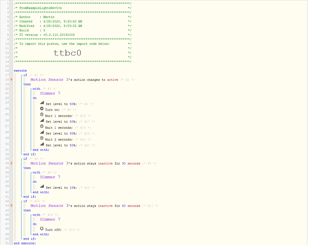

Hi Thank you for your help with this issue.
I have tested different options and here are the results of my test
I believe your suggestion to re sending the ON command multiple times to ensure the lights are still on is the solution, very simple workaround that solve the problem. It delays the process a little but it’s acceptable for a kitchen logic.
“IF Sensor's motion changes to active
Turn on
Wait 1 sec
Turn on
“END IF
This is definitely a hardware issue. I am using zooz ZEN27 dimmer. I have tested the same piston with a Leviton dimmer and it worked just fine, no issues no special logic needed. I don’t have any other brands to test.
I have attached the final piston for reference. I did try multiple combinations of your idea and found that the best was adding multiple “short waits” this increased responsiveness and ensured that command is always received.
Thank you very much for your help
Martin
