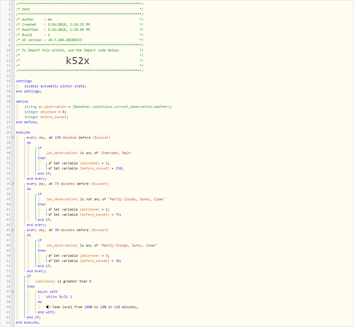

I’m trying to get something to happen based on weather conditions. I want the light to come on early if it’s cloudy or raining. But this piston is never running the bottom if statement. What am I missing?

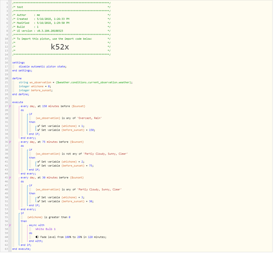

Your piston does not appear to have posted correctly. It’s not viewable, at least via Firefox.
You don’t have your last IF statement subscribed to anything to make it trigger/run. Try clicking on that “IF whichone” statement, then on the right of your screen change Subscribe from Auto to Always and it should trigger whenever “whichone” changes.

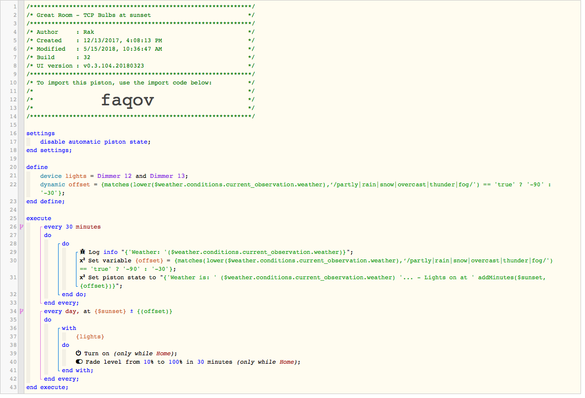

Here’s a piston I use to accomplish what you’re looking for. If it’s clear/sunny, then the lights come on at 30 mins before sunset. If it’s rain/snow/overcast, then the lights come on at 90 mins before sunset.
Been using it for awhile, works well.
This didn’t work!
Try posting your updated piston and updated logs for more help…
Edit: you also set your “whichone” variable to zero before every piston run, so your last IF statement will NEVER evaluate true.
