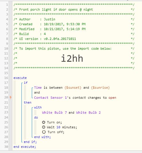

Lights not respecting timer based on door open
Piston not respecting timer
When door sensor changes to open, lights turn on, wait 10 minutes, then turn off
Lights turn on, but do not turn off after 10 minutes

I have a similar piston with the same basic structure for when presence sensors are changed to present and it works as expected, so I’m not sure what went wrong here.
Its being canceled, because the condition that caused the wait changed… It took a while to understand this myself.
In short, the If Condition says if the contact is ‘open’, when it changes to ‘closed’ any pending tasks are canceled. You can change this by clicking on the “with” and clicking the advanced options (the gear) and changing the “Task Cancellation Policy” to Never.
All of this is because the default for “Task Cancellation Policy” is [as follows from the wiki] (This is the default option and will cancel any pending tasks if the parent condition’s state changes. If the tasks are not executed as part of an IF statement, then this option is the same as Never cancel tasks)
Wow! NEVER would have seen that one. Thanks, I’ve made the change and will report back.
That did the job, thank you!
