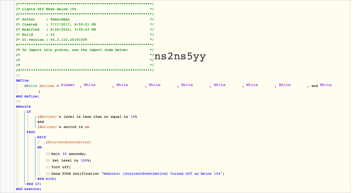

Trying to get lights to turn off automatically if they stay below a certain level for a certain amount of time. Other people in my house inadvertently dim the lights very low instead of just turning them off, so I need a piston to turn them off and reset their level to 100% when that happens.
Light switch turns off and level is reset to 100% without turning the lights back on. If the switch is turned off or the level rises above the threshold during the wait period, the piston should reset.
Piston is turning the light off even though the level is not below the defined level (10%).

I would avoid using this logic:
IF DeviceA switch changes
    Change DeviceA's switch
END IF
OK thanks. What would you propose as an alternative please?
I have hot food in front of me… Be back in a bit
No problem, thanks! Gotta eat!
I am a fan of using STAY, but it works best with only a single trigger. IE:
If DimmerA's level STAYS BELOW 11% for 30 seconds
   With DimmerA
      Set level to 100%
      Turn off
      Send PUSH
   END WITH
END IF
OK thanks will try that. Only question is, how can I tie the switch’s state (on or off) into the piston? The switch and dimmer level seem to be independent properties, correct? I would want the whole piston to only operate if the switch is on, including cancelling the STAYS timer if the switch is turned off during the 30 seconds. Any thoughts on that?
Just to clarify… If someone turns the level down to 5%, and then turns it off, you do not want the level reset, and the light turned off again?
I only want the piston to reset the level and turn the switch off if the switch remains on and the level remains below 10% for the defined period. Let’s say the switch is on and level is at 100% and then someone sets the level to to 5%. Timer should then start. If during that time window the level goes back above 10% or the switch is turned off, the timer should cancel. So yes, what you said I guess!
You can add an indented conditional check, that only happens after the 30 secs…
Perhaps a slight variation of my earlier piston:
If DimmerA's level STAYS BELOW 11% for 30 sec  <-- Trigger
   IF DimmerA is on                            <-- Condition
      With DimmerA
         Set level to 100%
         Turn off
         Send PUSH
      END WITH
   END IF
END IF
  • Every level changes executes the piston
  • Every level change below 11% starts the timer
  • If DimmerA is on after the timer, then the level is reset
Note, you may have trouble in this scenario:
  • DimmerA level set to 5%
  • DimmerA is turned off ten sec later
  • DimmerA is turned on an hour later (still at 5%)
I suspect the piston will not run again until the level changes again.
(this is why I suggested resetting the level regardless if the bulb is on or not)
This worked thank you! You were right about this too: “I suspect the piston will not run again until the level changes again.”; so resetting the level to 100% makes sense, yes.
I also tested it with multiple devices’ levels going below 11% during the same time window and that worked too. Thanks for your help!
