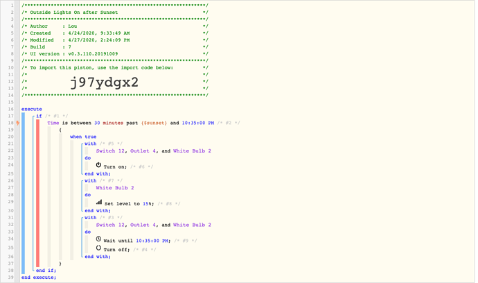

Lights on after sunset + 30 and off at 10:30. Not turning off
Piston is not turning off lights at 10:35 PM
Piston will turn on lights 30 minutes after sunset and off at 10:35pm every night
Will not turn off. Do I need a second piston to do this?
4/27/2020, 10:35:40 PM +853ms
+1ms ╔Received event [BigBlue].execute = recovery with a delay of 52ms
+144ms ║Setting up scheduled job for Tue, Apr 28 2020 @ 8:57:00 PM EDT (in 80479.004s)
+152ms ╚Event processed successfully (152ms)
4/27/2020, 8:58:05 PM +65ms
+0ms ╔Received event [BigBlue].time/recovery = 1588035485064 with a delay of 0ms
+91ms ║Setting up scheduled job for Mon, Apr 27 2020 @ 10:35:00 PM EDT (in 5814.844s), with 1 more job pending
+101ms ╚Event processed successfully (101ms)
4/27/2020, 8:57:53 PM +394ms
+0ms ╔Received event [BigBlue].execute = recovery with a delay of 54ms
+686ms ║Setting up scheduled job for Mon, Apr 27 2020 @ 10:35:00 PM EDT (in 5825.92s), with 1 more job pending
+693ms ╚Event processed successfully (693ms)

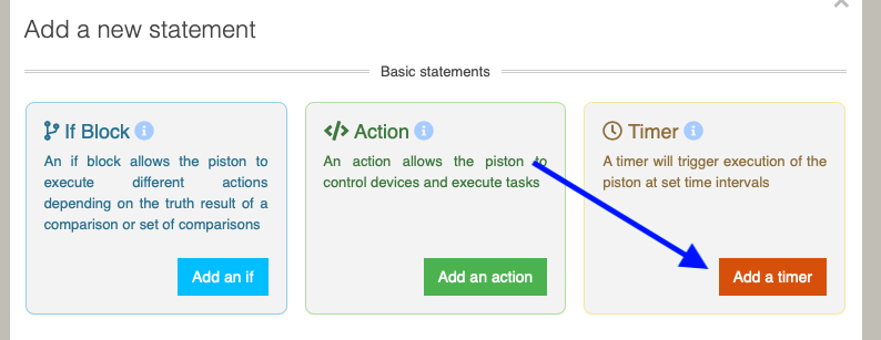

no, just use a TIMER. instead of IF time is between X and Y

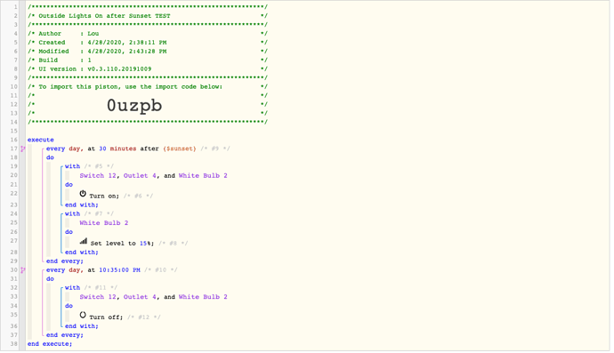

Thanks for the advice. Still new to webcore and trying to figure out all the features. Looked through some examples but couldn’t find anything. This is what I came up with. Hopefully all goes well tonight!!
Lookin’ good!
