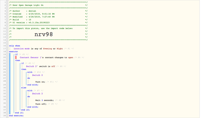

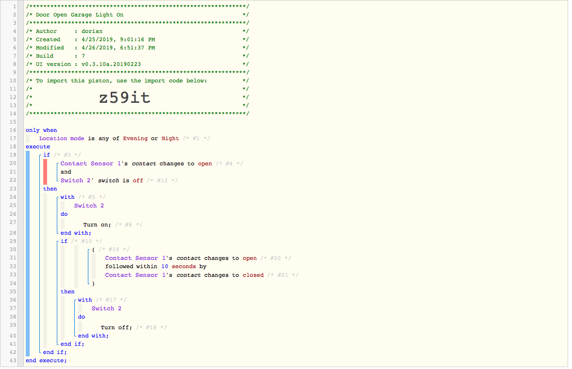

Lights turn on when door contact opens, but won’t then turn off. I’m sure I’m doing something wrong, but not sure wht.
When garage door is opened, lights turn on. Then, when garage door opens and then closes (this is me coming back into the house), lights turn off.
When garage door is opened, lights turn on. Then, when garage door opens and then closes (this is me coming back into the house), lights DO NOT turn off.

Just so I understand correctly.
You open the door. The lights turn on. You close the door. You open the door again and, within 10 seconds, close the door (coming back into the house)…

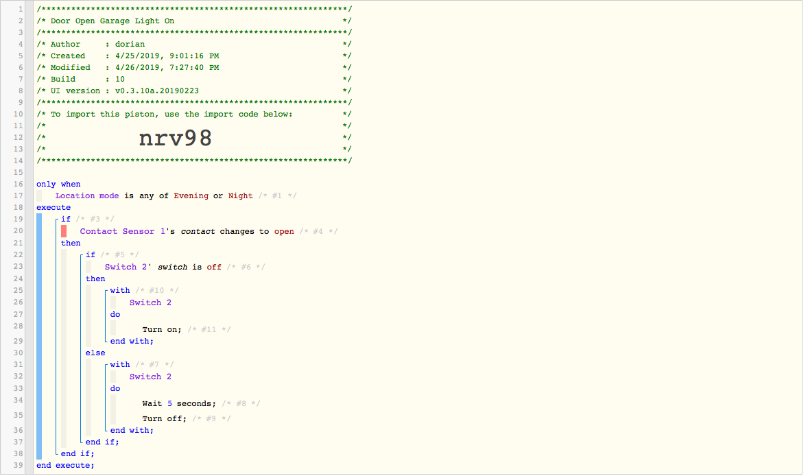

Thanks for the response @Pantheon, but I was able to rework it as below to get the desired result.
Yes, that makes more sense. I have never used the followed within before and I suspect when the status of your contact sensor 1 changed, it started the piston all over from the beginning and was not getting to the turn off part. Glad you got it working!
