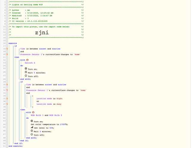

For testing purposes, I’m using the “is home” condition instead of the trigger “changes to” and the wait will be 5 mins.
When I only have the outside light parts in the scripts, it works perfect. When I add the 2 indoors light, only the outside lights turn on. Go easy on me, i’m just starting with ST and WebCore as I just transitioned from Wink.
I want to have the outside light turn on after sunset, always. I want the 2 lights inside the house to turn on after sunset, only if no one is home.
The outside lights turn on but nothing on the inside.

Hello and welcome to the club, Hugues.
I understand your reasoning for this… I’d be a pain to have to leave the house five times while testing out our code.
Unfortunately, with that choice, it totally changes the way the entire piston processes. Meaning, any successful test using a condition, it will fail when converted back into a trigger.
Ideally, our testing scenario should match as closely as possible to the final draft.
Notice the 6 lightning bolts in the left margin? Having a trigger in place changes the conditions back into real conditions. (reducing the lightning bolts down to 1 or 2)
While testing, my suggestion would be to change your original trigger:
IF Device changes to "X"
to a generic device, using the same verb:
IF RareBulb changes to on
or
IF SimulatedSwitch changes to on
This way, you can toggle the switch on or off to simulate presence changes. Once you are happy with the testing, it is simply a matter of converting the trigger back to the original.
PS. I realize that this post does not help you a whole lot in the short term… but I hope you can take some of the wisdom for the long haul.
Speaking of short term…

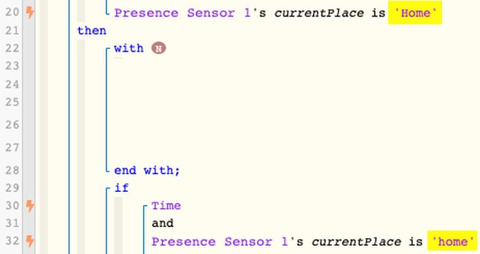

I just noticed that lines 20 & 32 are not capitalized the same…
Although to be honest, I am not 100% confident that currentPlace can be a trigger.

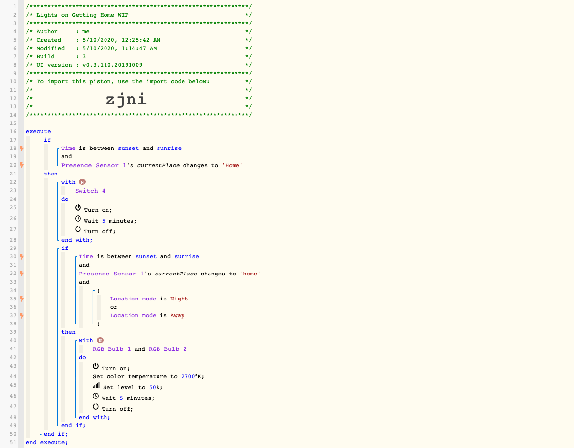

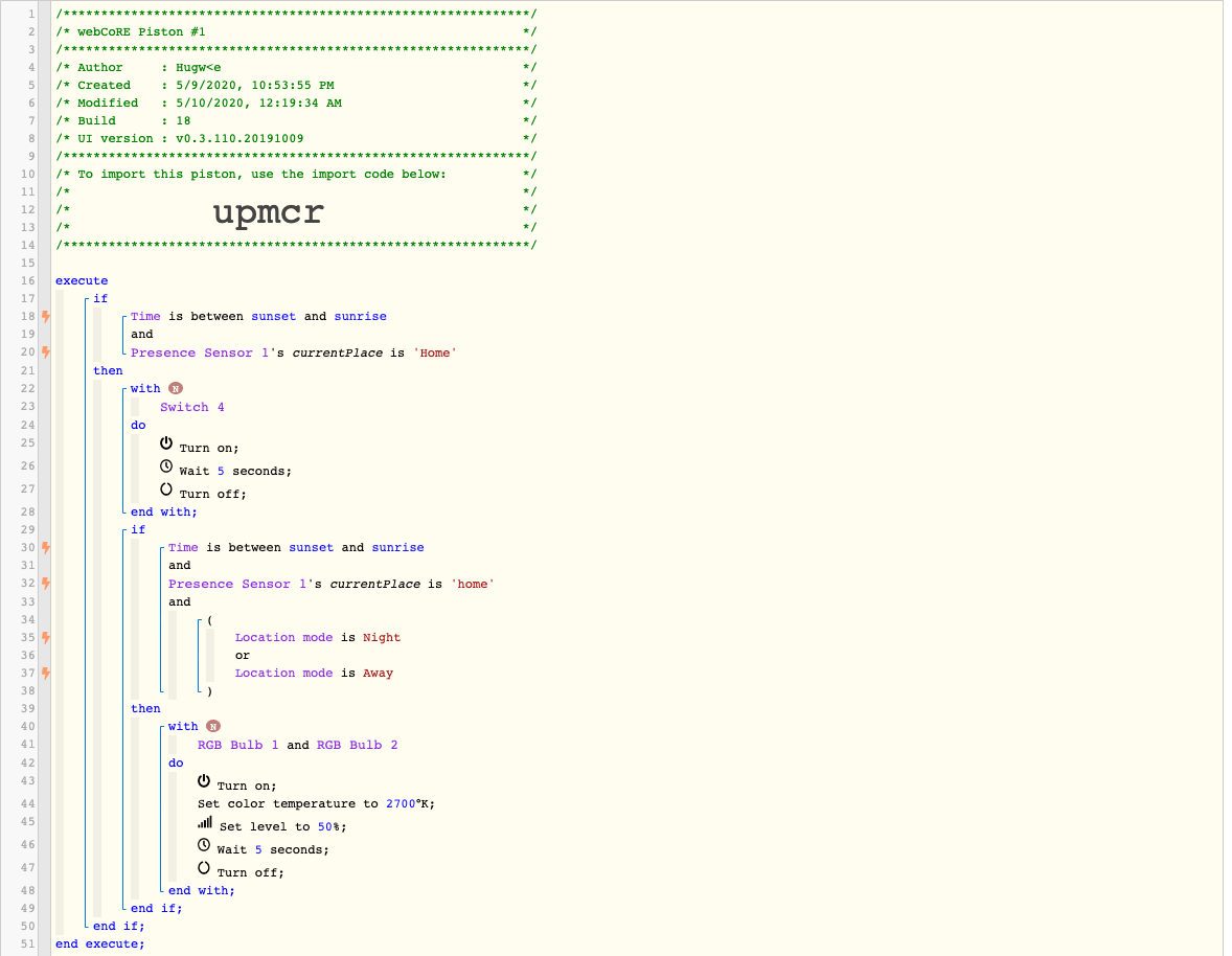

Hey, thanks for replying. here is exactly how I wrote it. not for testing.
From that last screenshot, I suspect that currentPlace is not seen as a trigger…
If this is true, then all of your conditions still become triggers…
What this means is that you may need to find another option in the drop down besides currentPlace to be your trigger.

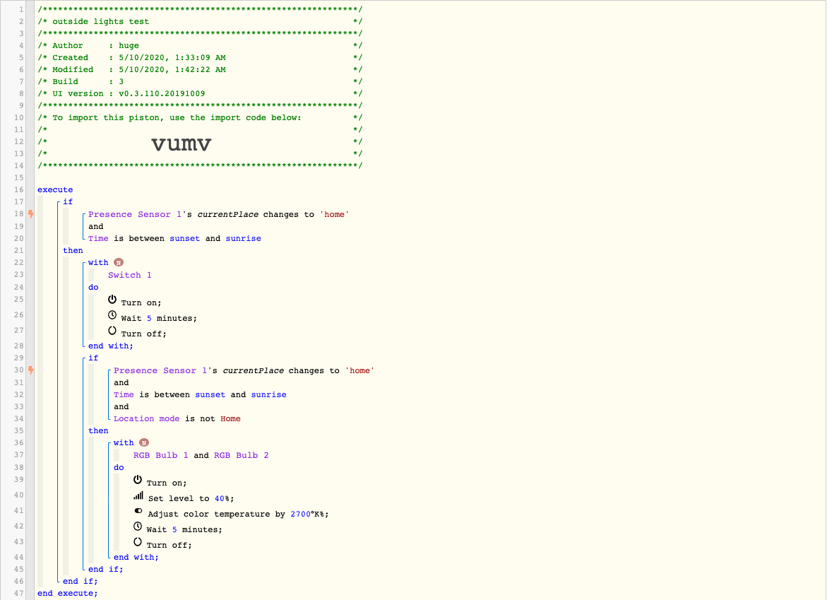

So I originally based (pasted :confused: )someones script. I rewrote from scratch. Two lightning bolts…
OK cool, although I still think my previous posts apply with many handlers.
Has piston “vumv” ever fired when your location changed?
Haven’t left the house for testing yet, will have to test tomorrow, later today I mean.
Perfect.
Please Clear your logs (to clean the slate) and turn your logging level to Full so we get good information later. :sunglasses:
Reference: Wiki / Logs
Oh yeah for sure. New piston, forgot to turn on the log! thanks again!
Something I noticed, which will simplify your code a bit.
Lines 18 and 20 of ‘vumv’ are the same triggers as lines 30 and 32. It seems unnecessary as it is in the IF statement that will only be true when these things are true anyway. So you really only need the condition in line 34.
Also having extra unnecessary triggers may cause unexpected results.
Ok I did as suggested, cleaned it up a bit.
Preformatted text
Looking much better… (although we still need to confirm that currentPlace can work as a trigger)
After editing a piston, please clear the logs once again, so they will align with the latest pic.
(if there are issues, it helps to also turn on Trace)
Note: We may come back to line 20 once the trigger is confirmed to work.

(but notice the capital “H”)
Comparison (string) Home changes_to (string) home = false

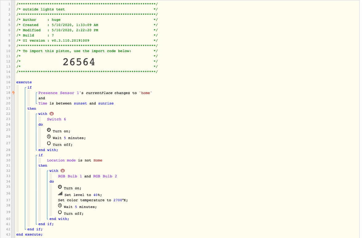

#19
In this post you are being helped by 2 very advanced users…
But I just want to add my suggestion:
Use a timer for outside lights.
Every day 1 minute after SUNSET
With switch 6
Do turn ON
Add a second timer
Everyday 3 minutes after sunset
      IF location mode is NOT HOME
      Then do this do that
#20
The second part didn’t fire because your location mode was Home. Your piston checks that you are not home.
If
Location Mode is not Home
Do stuff with RGB Bulb 1&2
Comparison (string) :e961a7bac45f76666575a6b42ae443ba: is_not (string) :e961a7bac45f76666575a6b42ae443ba: = false (1ms)
