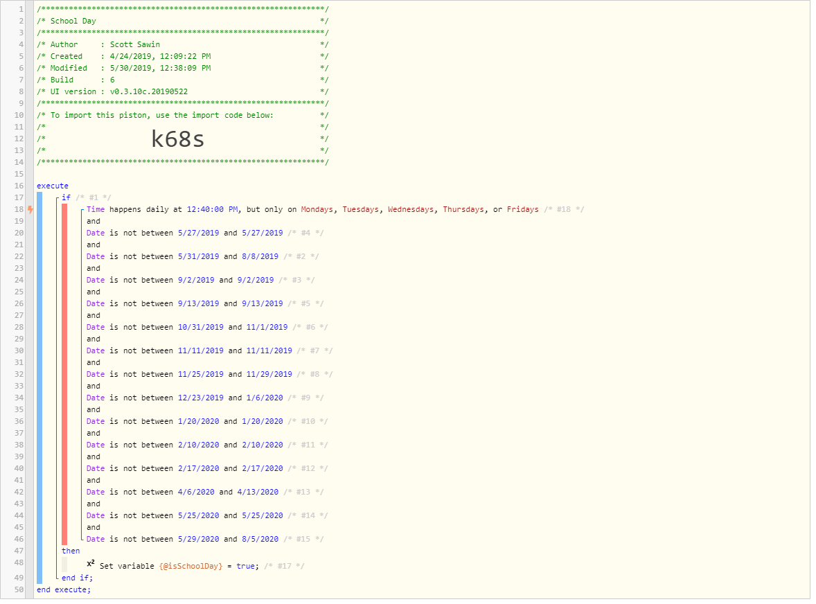

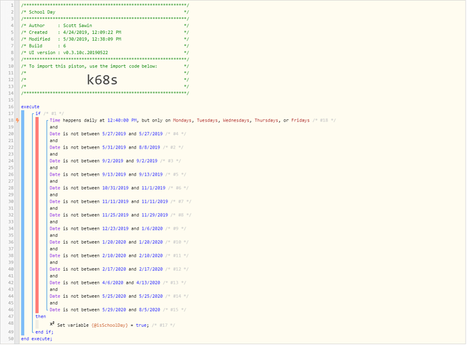

I tried to duplicate your piston but its not working. Donât mind the run time. Adjusting it to see if it make a difference. What am I missing?
5/30/2019, 12:39:59 PM +82ms
+1ms âReceived event [Home].time = 1559245200000 with a delay of -918ms
+111ms âRunTime Analysis CS > 18ms > PS > 57ms > PE > 36ms > CE
+114ms âRuntime (45932 bytes) successfully initialized in 57ms (v0.3.10c.20190522) (113ms)
+115ms ââExecution stage started
+125ms ââComparison (time) 45599204 happens_daily_at (time) 45600000 = true (1ms)
+127ms ââTime restriction check passed
+128ms ââCancelling condition #18's schedules...
+129ms ââCondition #18 evaluated true (7ms)
+131ms ââCancelling statement #18's schedules...
+135ms ââRequesting time schedule wake up at Fri, May 31 2019 @ 12:40:00 PM PDT
+154ms ââComparison (date) 1559199600000 is_not_between (date) 1558940400000 .. (date) 1558985413206 = false (13ms)
+155ms ââCondition #4 evaluated false (17ms)
+157ms ââCondition group #1 evaluated false (state did not change) (35ms)
+160ms ââExecution stage complete. (45ms)
+161ms âSetting up scheduled job for Fri, May 31 2019 @ 12:40:00 PM PDT (in 86400.758s)
+169ms âEvent processed successfully (169ms)

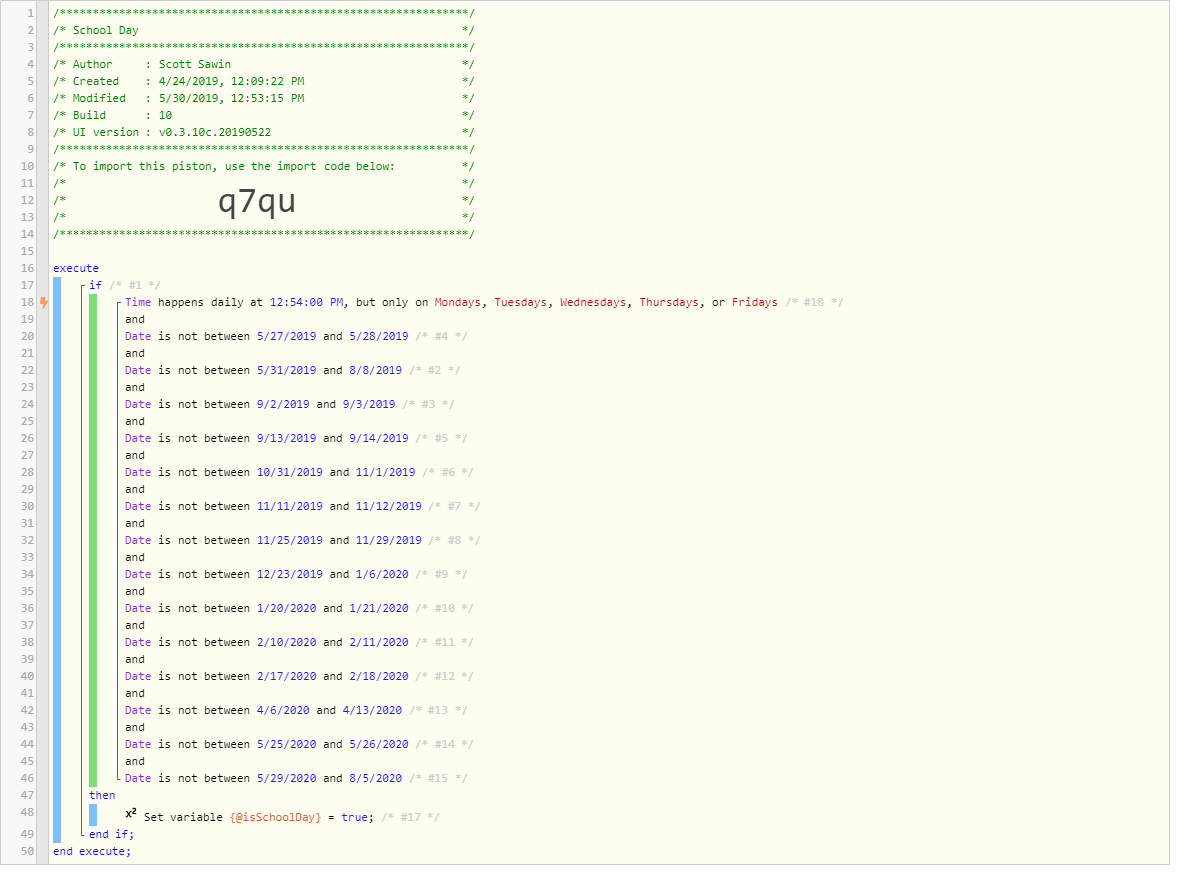

Turns out I had to read the full list of responses. Modified the dates so if it was one day from 5/27/19 and 5/27/19 to 5/27/19 and 5/28/19
Working Piston
