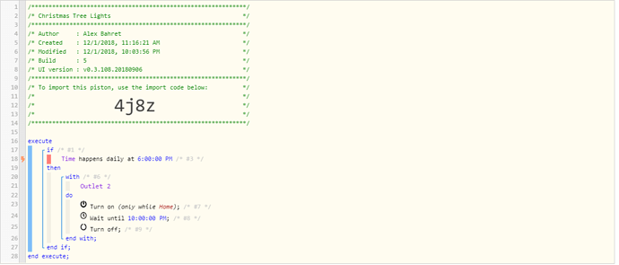

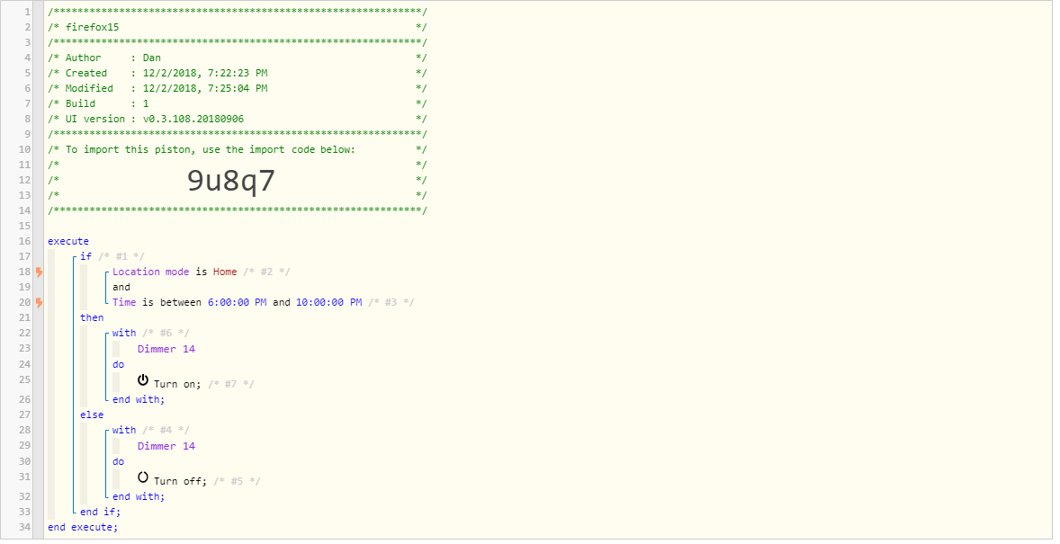

I am not sure how to code this piston in the simplest way. I could make a lot of if/then statements to do it, but I feel like there is likely a clean way that I am not familiar with.
I would like the Christmas tree lights to be on when we 1) we are home and 2) it is between 6 PM and 10 PM. Ideally, I would like the lights to turn on and off within this window if we leave the house and return. For example, if we are home at 5 PM, leave at 6:30 PM, and return at 8:00 PM, the lights should turn on at 6:00 PM, turn off at 6:30 PM, turn on at 8:00 PM, and turn off at 10 PM.
This piston works fine when we are home for the entire night, but it obviously does not work in many other situations. if we are not home at 6 PM but come home at 7 PM, they won’t turn on, and lots of combinations will not work either. Do I need to make a bunch of additional triggers/actions that execute on each arrival/departure action, or is there a cleaner way to do it?
  12/1/2018, 5:59:59 PM +121ms
+1ms	╔Received event [Home].time = 1543705200000 with a delay of -880ms
+122ms	║RunTime Analysis CS > 35ms > PS > 62ms > PE > 26ms > CE
+126ms	║Runtime (36747 bytes) successfully initialized in 62ms (v0.3.108.20180906) (124ms)
+128ms	║╔Execution stage started
+161ms	║║Comparison (time) 64799259 is_between (time) 64800000 .. (time) 79200000 = true (17ms)
+163ms	║║Time restriction check passed
+167ms	║║Cancelling condition #3's schedules...
+168ms	║║Condition #3 evaluated true (30ms)
+171ms	║║Cancelling statement #3's schedules...
+182ms	║║Requesting time schedule wake up at Sat, Dec 1 2018 @ 10:00:00 PM EST
+187ms	║║Cancelling condition #1's schedules...
+189ms	║║Condition group #1 evaluated true (state changed) (51ms)
+193ms	║║Cancelling statement #6's schedules...
+203ms	║║Skipped execution of physical command [Christmas Tree Lights].on([]) because it would make no change to the device. (3ms)
+205ms	║║Executed [Christmas Tree Lights].on (6ms)
+214ms	║║Executed virtual command [Christmas Tree Lights].waitForTime (4ms)
+216ms	║║Requesting a wake up for Sat, Dec 1 2018 @ 10:00:00 PM EST (in 14400.666s)
+225ms	║╚Execution stage complete. (98ms)
+229ms	║Setting up scheduled job for Sat, Dec 1 2018 @ 10:00:00 PM EST (in 14400.652s), with 1 more job pending
+238ms	╚Event processed successfully (238ms)
What are you using to determine if your home?

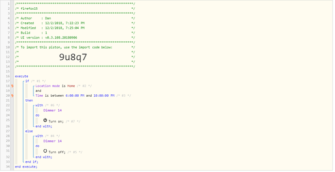

When location changes to home.

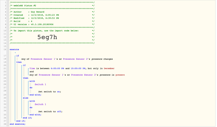

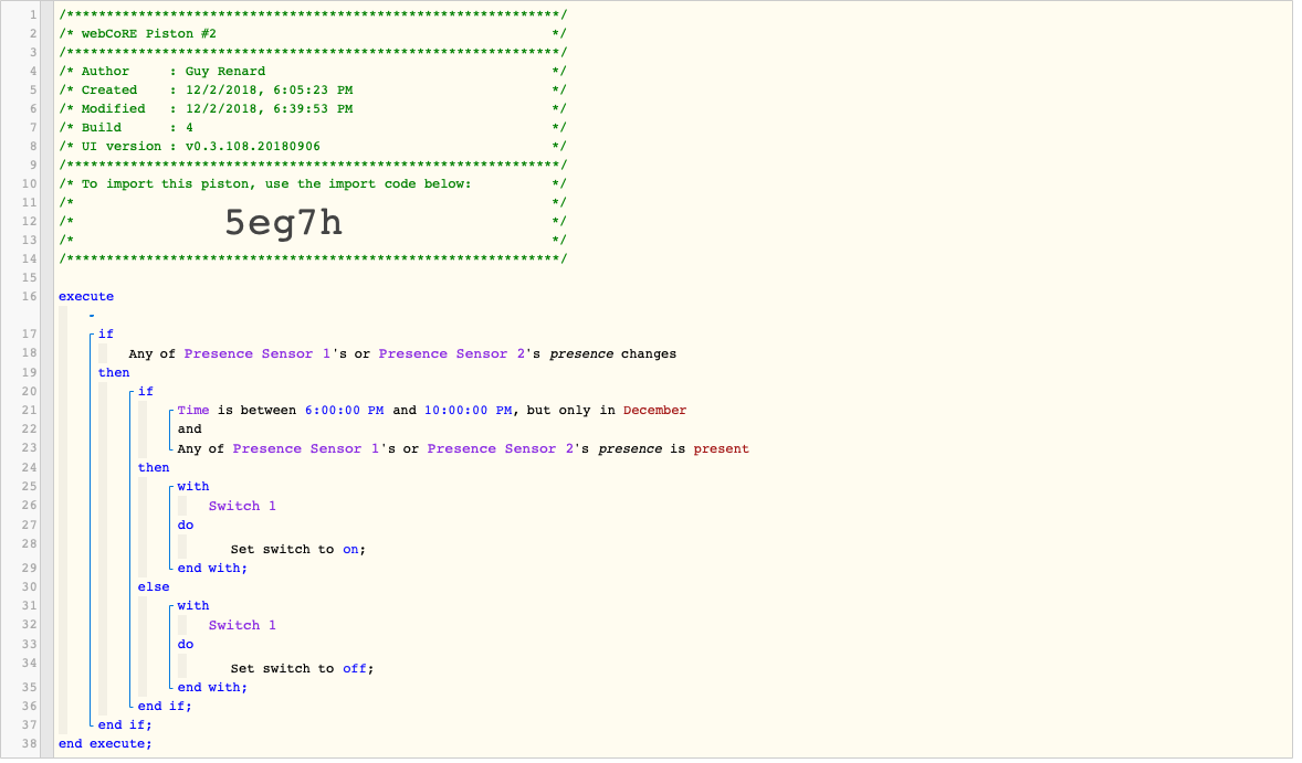

There is a better way I think… but this should work?
Thanks! I do wonder if there is a cleaner way, but anything helps!

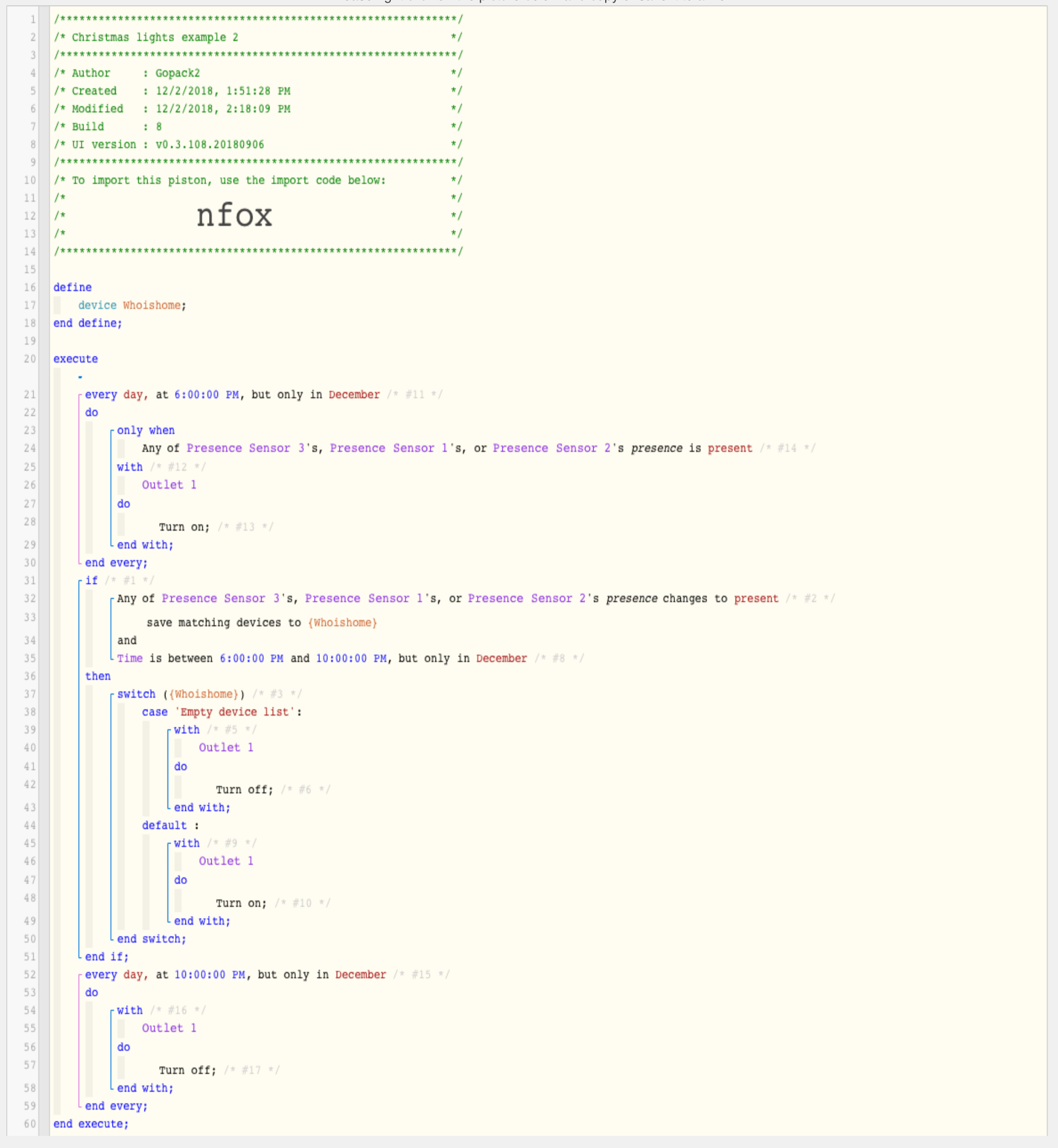

This might work too. Haven’t tested it but it should.

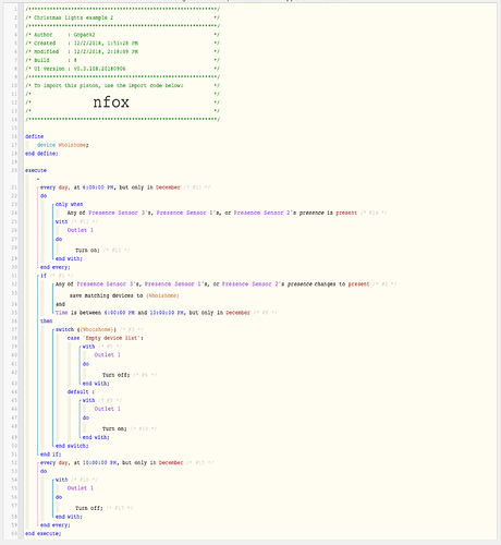

I think this should do what you’re after. It will automatically run at 6pm and 10pm, and anytime your hubs mode changes.
Thanks, I’ll give this one a shot too!
Here is another option. I think this one is straight forward. Just put in your presence sensors and switch(es).
