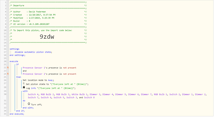

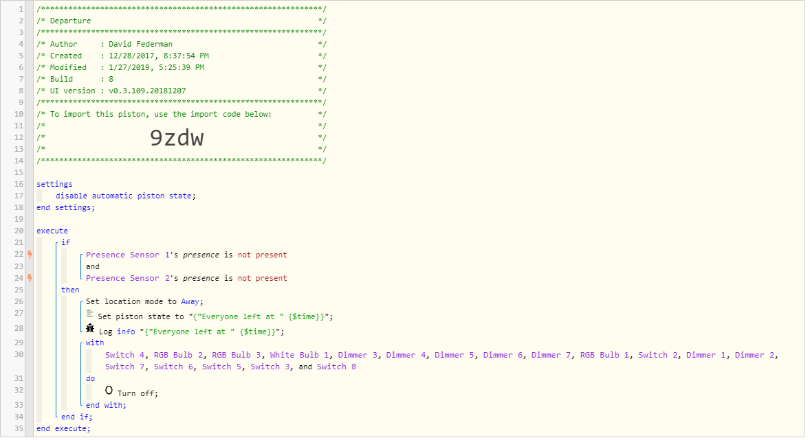

Departure piston (sets location mode to away):

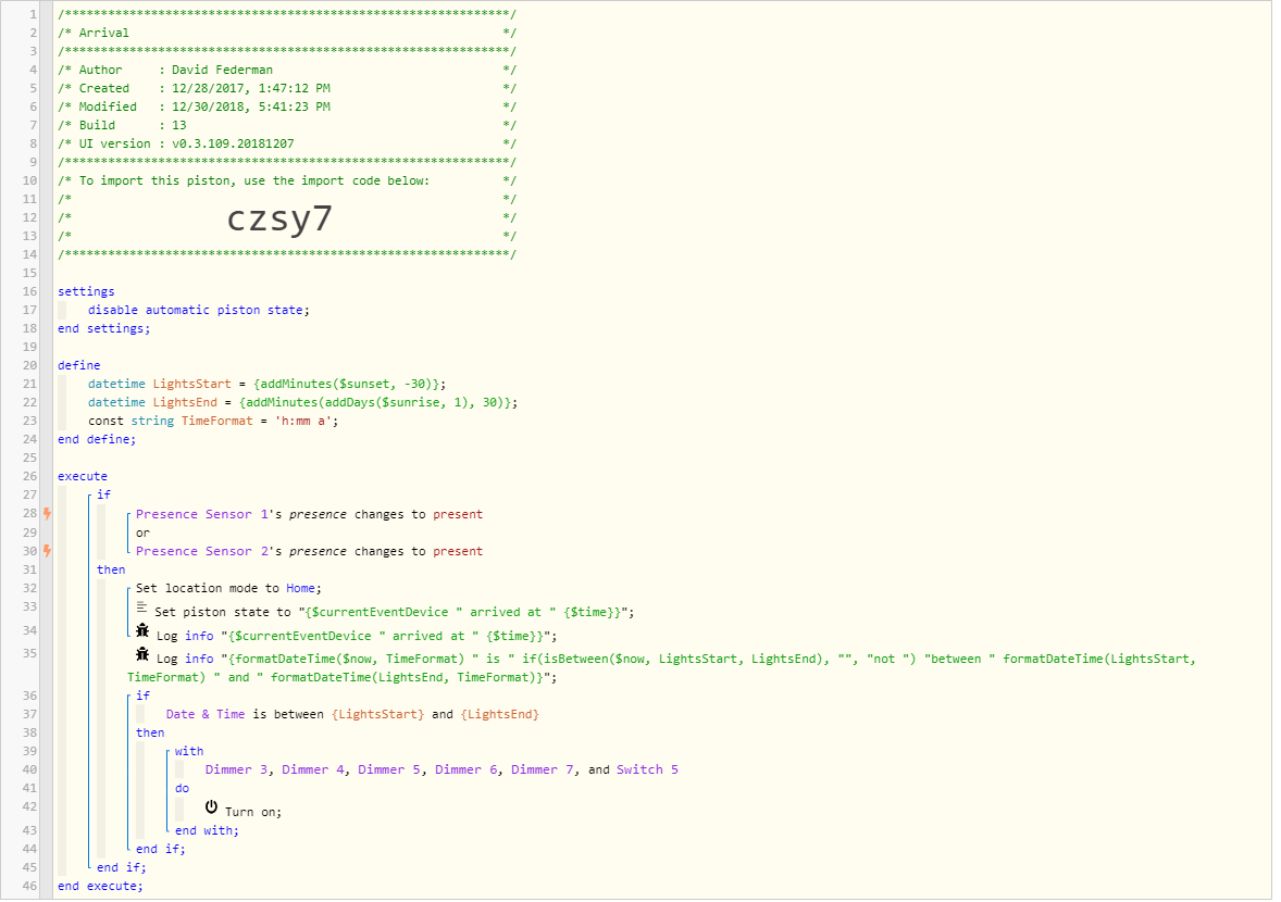

Arrival piston (sets location mode to home):

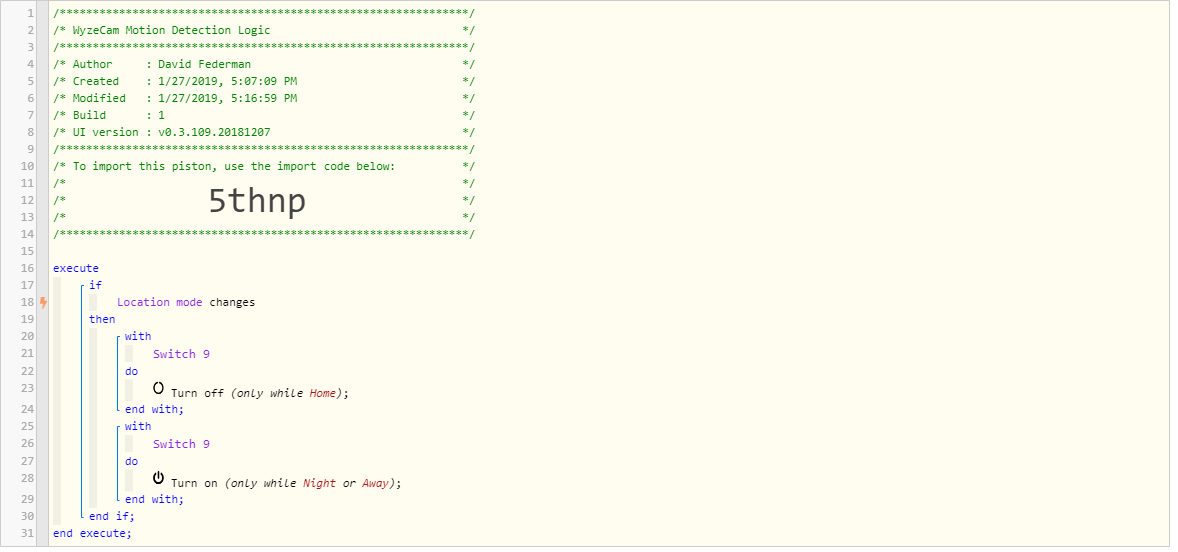

Piston which triggers on location mode changes (not working):

Departure piston:
Piston state: Everyone left at 11:25 A.M.
Last executed: 1/29/2019, 11:39:17 AM
Arrival piston:
Piston state: David arrived at 11:39 A.M.
1/29/2019, 11:39:17 AM +789ms
+185ms	║David arrived at 11:39 A.M.
+333ms	║11:39 AM is not between 4:35 PM and 8:09 AM
Piston which triggers on location mode change:
Last executed: never

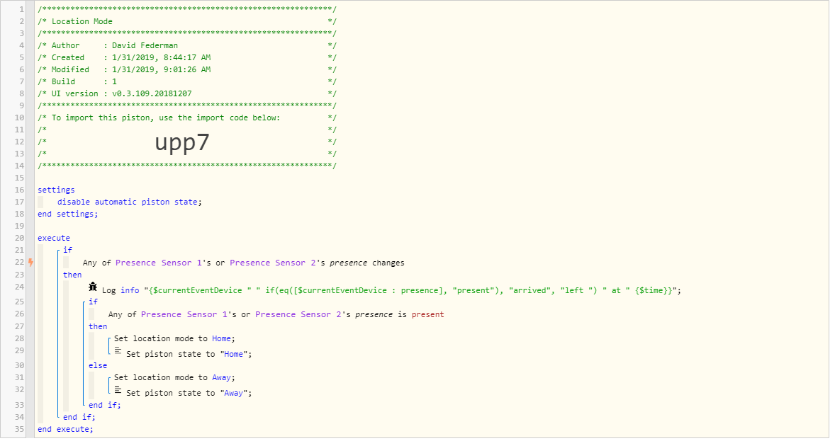

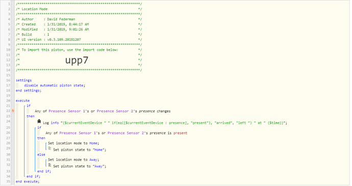

Thanks for the suggestion! Seems reasonable and I’ve been wanting to refactor those pistons anyway to remove all the light switching in favor of one that triggers on the location mode change and let the arrival/departure be “pure”.
EDIT: Here’s what I came up with and will test next time I leave the house (not 100% confident the log statement will work):
