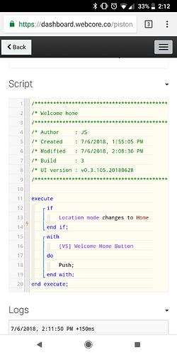

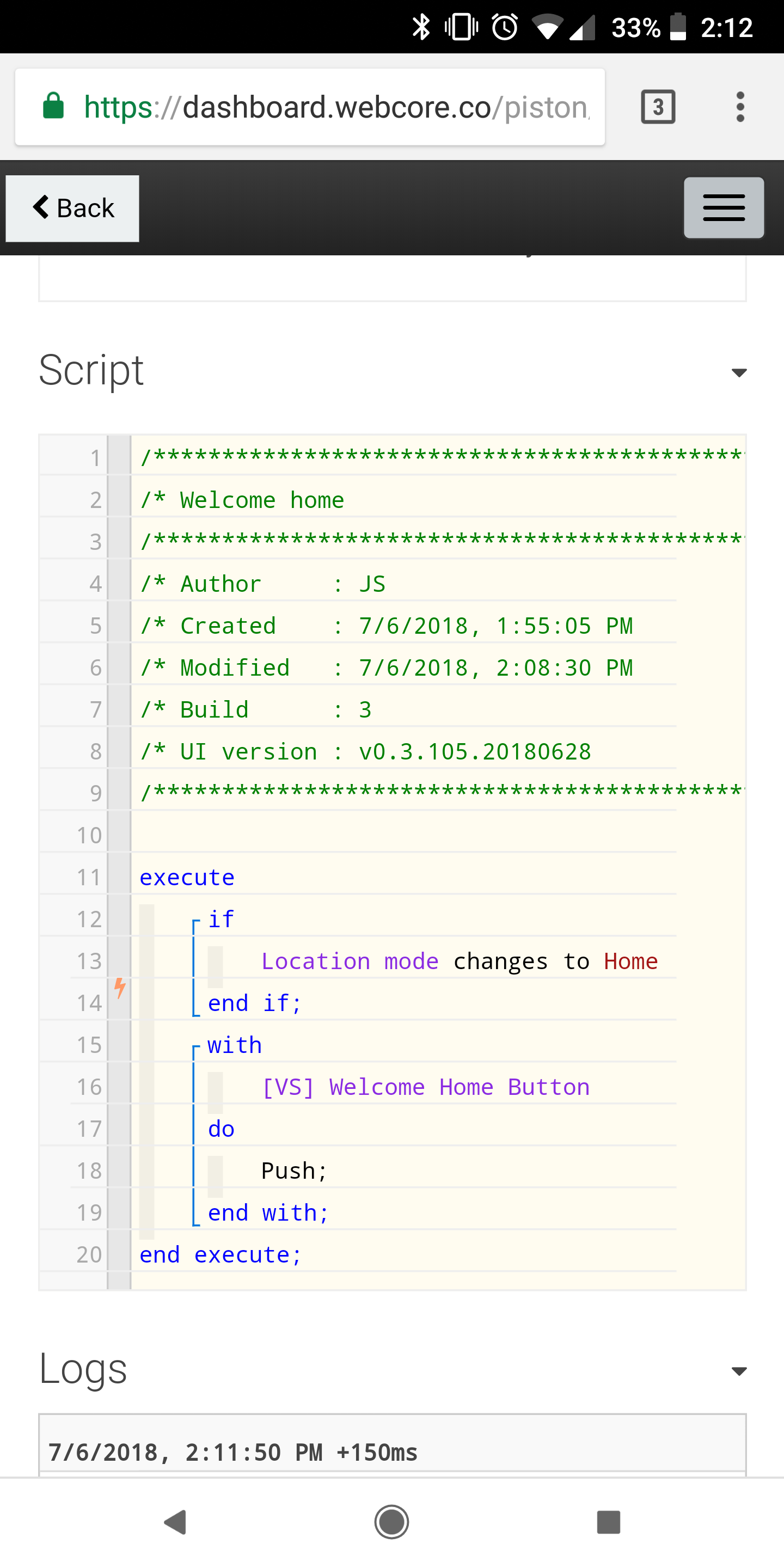

Location Mode triggers “changes to” and “changes away from” are not working. They get triggered by any location mode change, instead of the one(s) specified.
Piston should press virtual button only when the location mode changes to Home
Piston is pressing virtual button when location mode changes to Night

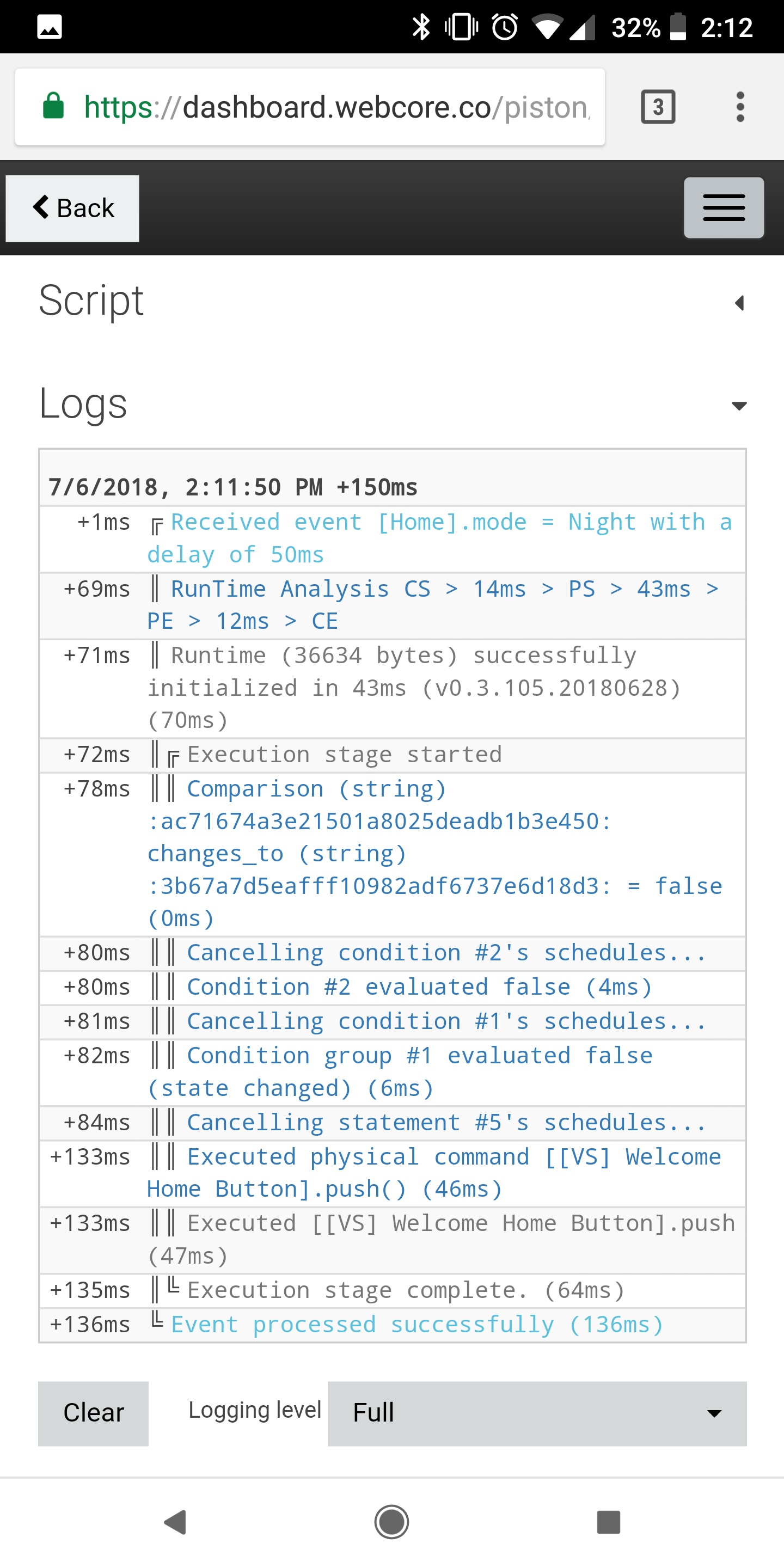

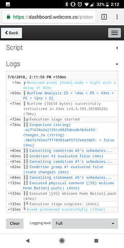

**5) Attach any logs
Your WITH command needs to be inside the IF command after THEN.
Your current code has no action when location changes…
