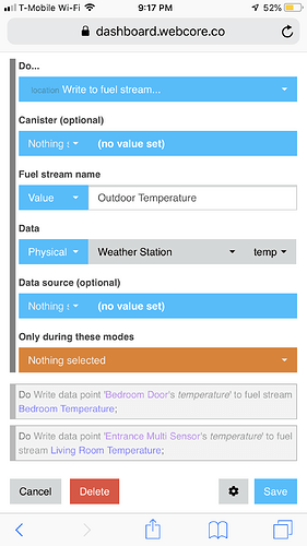

Other question is regarding Fuel Streams (which I still cannot view) - what’s the difference between the data and data source options?

@eibyer You’re one of the minions around here - any idea on the data source part of my question regarding Fuel Streams?
Sorry, honestly have no idea. I’m not a heavy fuel stream user :slight_smile:
