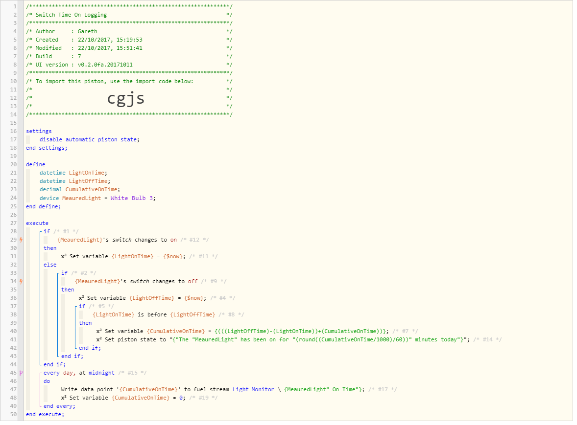

I’d like to log the amount of time a switch has been left on and then publish that to somewhere outside of the piston itself. I was doing a daily summation of time however would like to log this somewhere.
I currently use fuel streams for logging internal / external temperatures and wondered if I could use the same mechanism to log the amount of time a switch is left on.
Looking for advice before I start building a piston.
