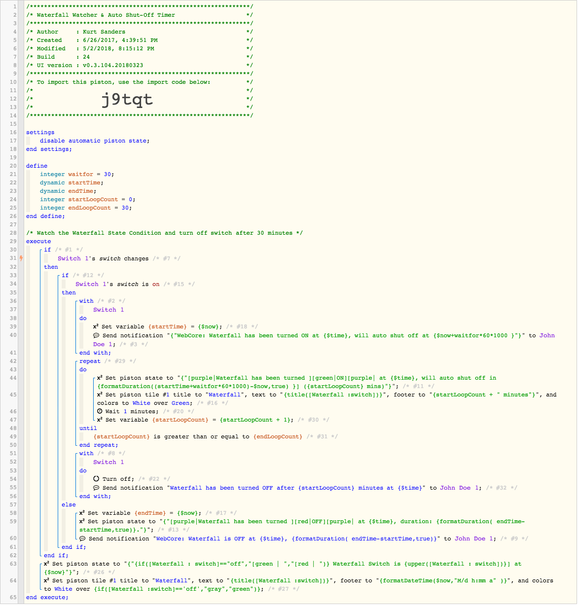

Here is how I am using this function in a WebCore Piston State update that monitors my waterfall pump and lets me know how long it has been operating :smile:
Yep, that works. Changed to $now - lastOpen. I’ll try to create an account and update the wiki. Thanks.
