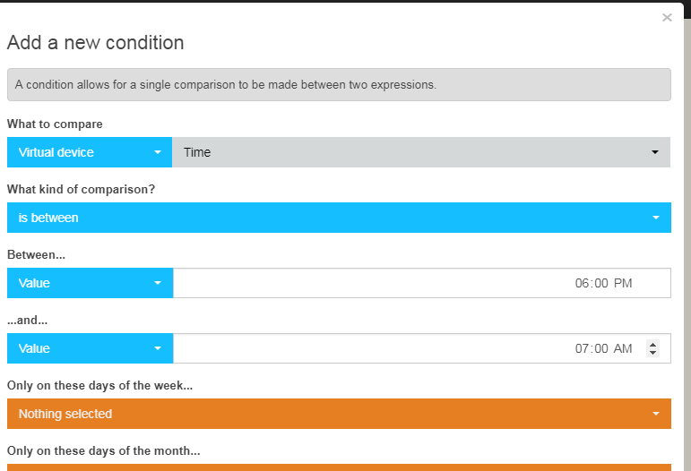

I have the piston built but now I need to add a only run between these times. E.g. only operate piston between 6pm and 7am everyday.
I see the time and date variable setting but they all include a date. The closest there is the one for noon to midnight or sunset to sunrise times. The sun times are close but I lose hours prior to sunset when I can save the most on cooling.
What about if you had a time condition to your If statement. If time is between 6pm and 7am AND outside temp is <=78 AND inside temp is >=74
