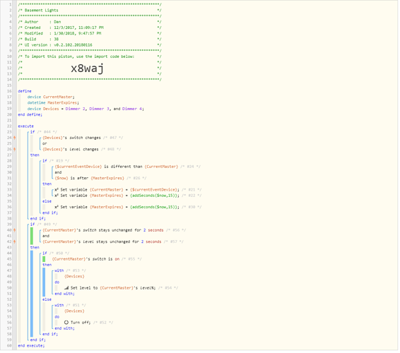

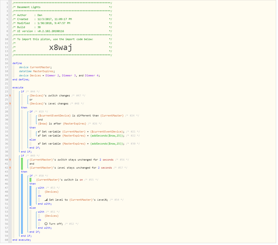

Check this out as an example. You can see I listed devices in a Device variable at the top, monitor all of them for changes in the top IF statement, and apply actions to the variable in the last IF statement.
