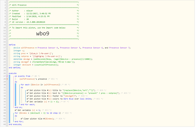

Here’s an example… I use this for my wifipresence tiles.
Edit: I did not read that correctly, you wanted to do it inside an expression. I am not aware of any way to do that.
