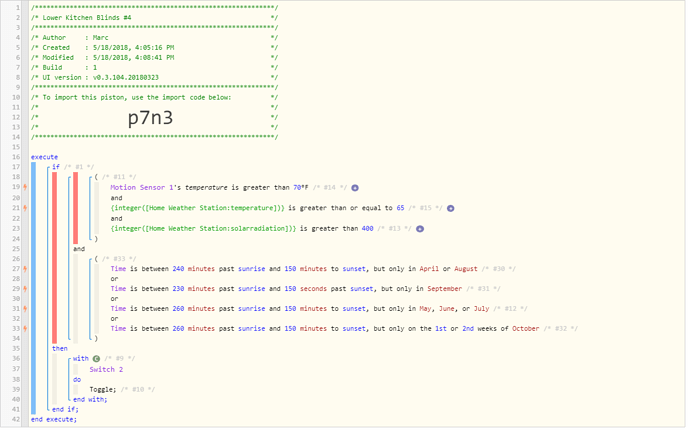

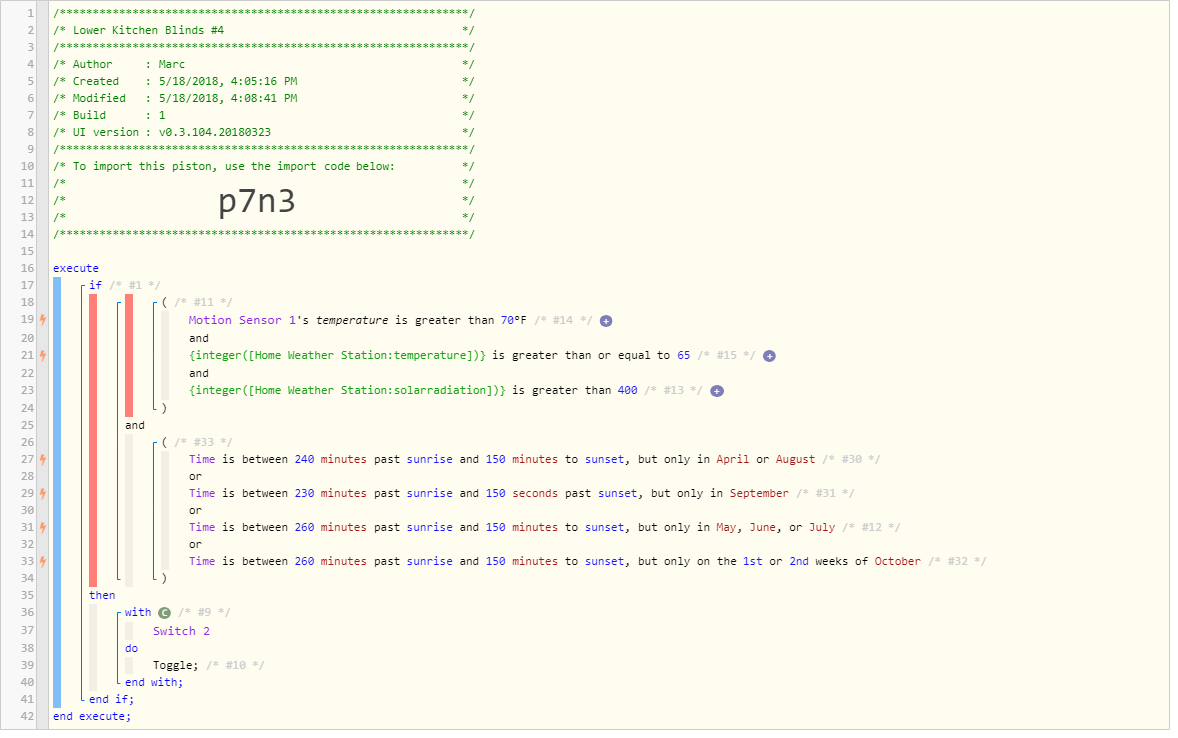

I’ve had this piston for a while. If at the start of the piston (i.e. 260 minutes after sunrise in May) AND the inside temp is already over 70, outside temp is already over 65 and the solar radiation is already over 400, then the piston fires fine. If, however, the inside temp is not over 70 or the outside temp is not over 65 or the solar radiation is not over 400 BUT these three variables during the day do all go over their designated numbers at some point, the piston does not fire.
I thought by putting the three variables at the top (inside temp, outside temp and solar radiation) all on ‘always subscribe’ that it would solve the problem but it does not.
The blinds do not go down unless the first three variables are over their limits at the beginning of the pistons time of day. (ie 260 minutes after sunrise in May) If they go over later in the day but still during the time I have asked it to fire, it does not work.
**5) Attach any logs
Help is greatly appreciated. It is driving me crazy…

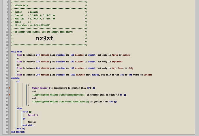

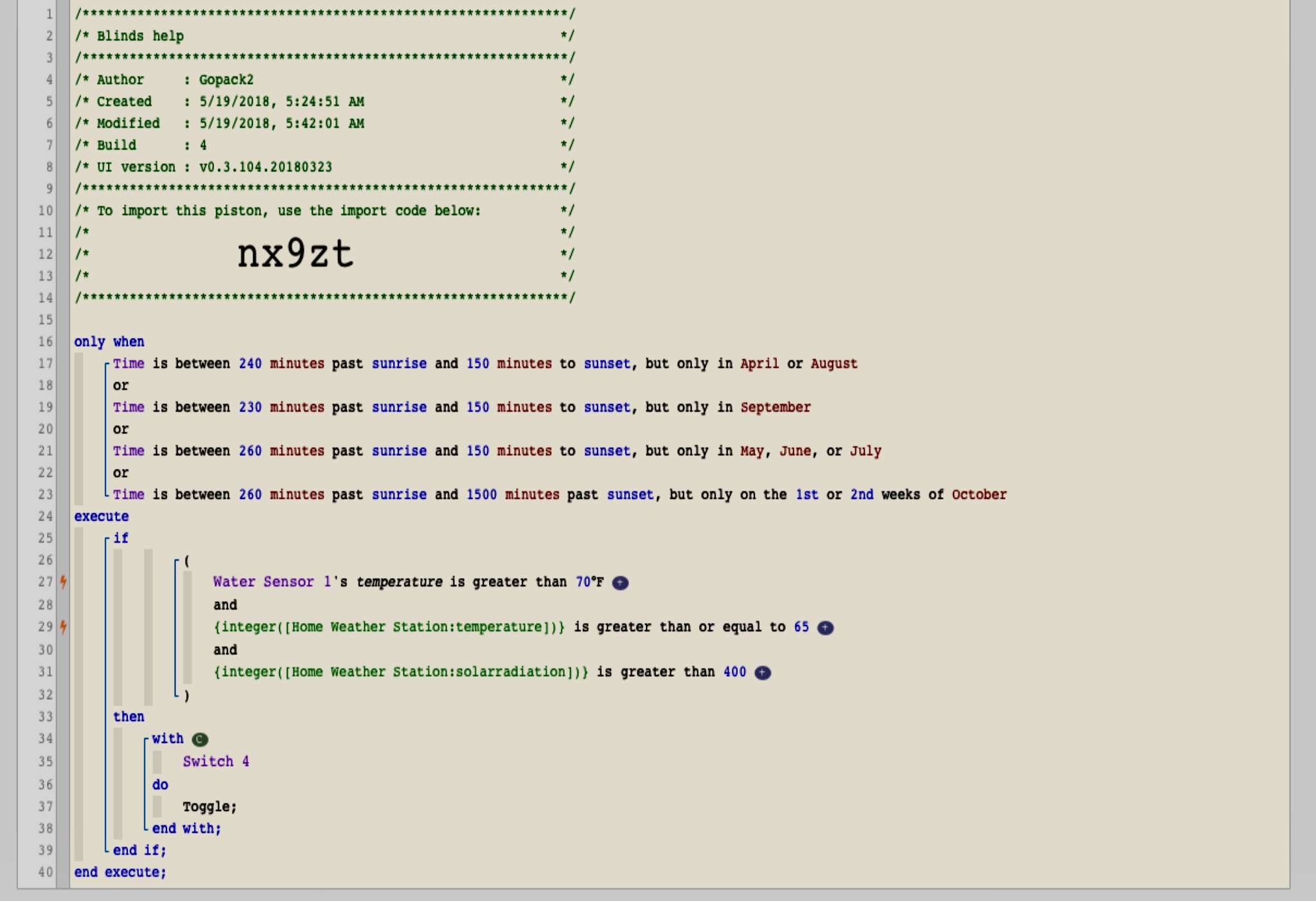

Try moving your if block with all the time restrictions to the section that says only when at the top.
Then do you if block for the weather / temperature related stuff
In the then section for that if block put your toggle
For example:
@Gopack2. You were right on. Changed it to your recommendation and it works like a charm :slight_smile:
THANK YOU!
