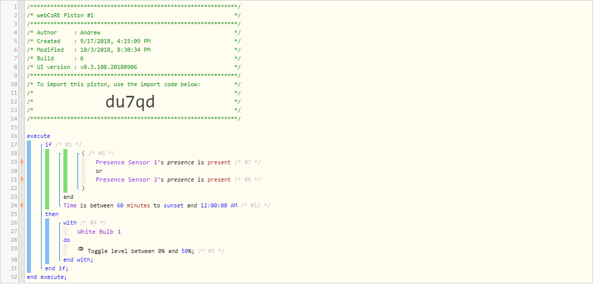

Lights not always turning on.
If either phone is present, and its an hour before sunset, turn on.
I’m finding the lights dont turn on. I can hit test, the lights dont turn on. The lights are lutron caseta lights. If I toggle the lights one time with my remote (at home), then off, after that, the test button in webcore seems to work as expected - turns on. Its almost as if i have to ‘wake’ the lutron system?
10/4/2018, 5:39:59 PM +58ms
+1ms ╔Received event [Home].time = 1538689200000 with a delay of -942ms
+87ms ║Runtime (38363 bytes) successfully initialized in 38ms (v0.3.108.20180906) (84ms)
+539ms ║║Executed virtual command [Living Room Main Lights].toggleLevel (371ms)
+543ms ║╚Execution stage complete. (455ms)
+545ms ║Setting up scheduled job for Fri, Oct 5 2018 @ 12:00:00 AM EDT (in 22800.398s)
+558ms ╚Event processed successfully (558ms)
