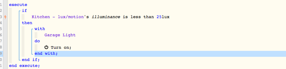

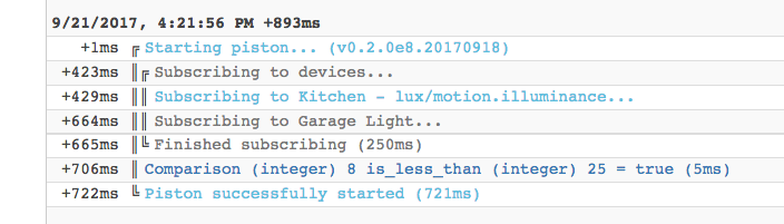

I’m using a Lux sensor to help turn on lights below their set times, depending on Lux level. Before I integrate this into a more complex piston, I thought I would give it a try…WebCoRE is seeing the Lux my sensor is reading, but I am not getting the piston to turn on the light…Here’s the setup and log if someone can help me out on this…thanks
UPDATE:

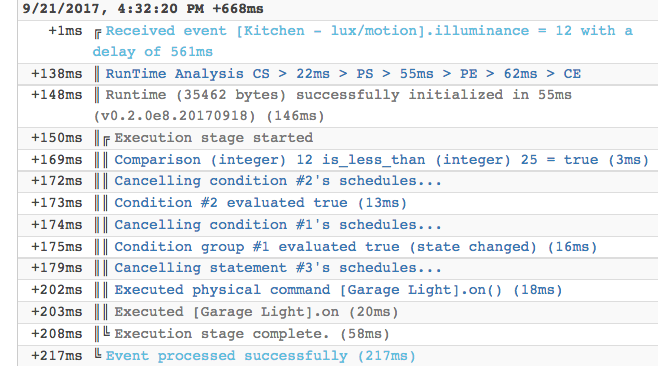

I temporarily turned a light on to raise the Lux up…then turned the light back off to make it below my threshold…and low and behold, it fired the piston…I’m guessing this must be with how the lux sensor is reporting?

Try drops below instead of is less than 25lux
