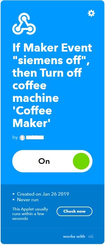

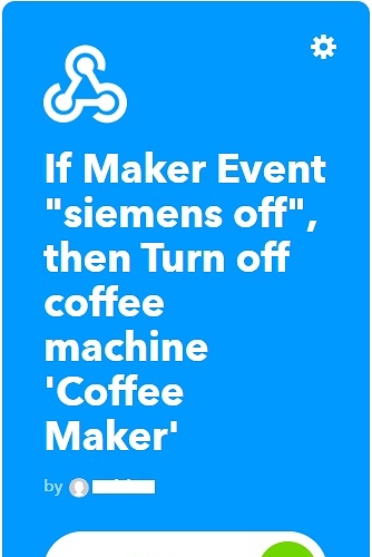

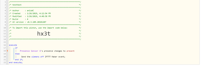

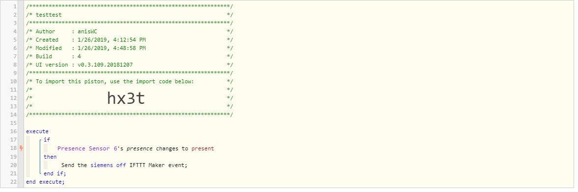

I created this applet (named siemens off), run the piston like below but it doesn’t do anything. btw the coffee machine responds to google home commands through IFTTT

+1ms ╔Received event [Virtual presence sensor].presence = present with a delay of 65ms
+71ms ║RunTime Analysis CS > 18ms > PS > 43ms > PE > 10ms > CE
+73ms ║Runtime (36632 bytes) successfully initialized in 43ms (v0.3.109.20181207) (71ms)
+85ms ║║Comparison (enum) present changes_to (string) present = true (1ms)
+87ms ║║Cancelling condition #2’s schedules…
+88ms ║║Condition #2 evaluated true (7ms)
+89ms ║║Cancelling condition #1’s schedules…
+90ms ║║Condition group #1 evaluated true (state changed) (10ms)
+93ms ║║Cancelling statement #3’s schedules…
+189ms ║║Executed virtual command iftttMaker (91ms)
+192ms ║╚Execution stage complete. (118ms)
+193ms ╚Event processed successfully (193ms)
I think I know why it’s not working, silly but I believe that’s why
name of the maker event can’t have space, has to be one word, not sure if it’s webhooks vs IFTTT limitation, don’t think it’s core limitation right?
Weblinks should never have a space. (HTML Standards)
While technically, it can be %20 but then you have to worry about translation. It’s much better to simply avoid using spaces with all web addresses.
