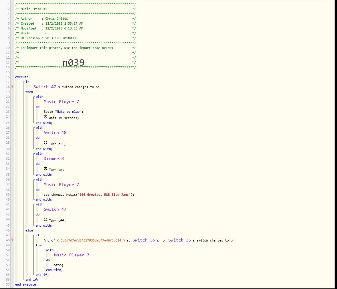

I have a piston that runs almost as I would like. I just need the music to stop when certain lights are turned on
After certain lights turn on, I would like for the music to stop. Long story short, the “routine” is over when any of 3 lights are turned on. I just need the music to stop playing.
I would move that last IF outside the other IF, so the two stand on their own. Then you can stop the music by turning on Switch 35 or 36.
