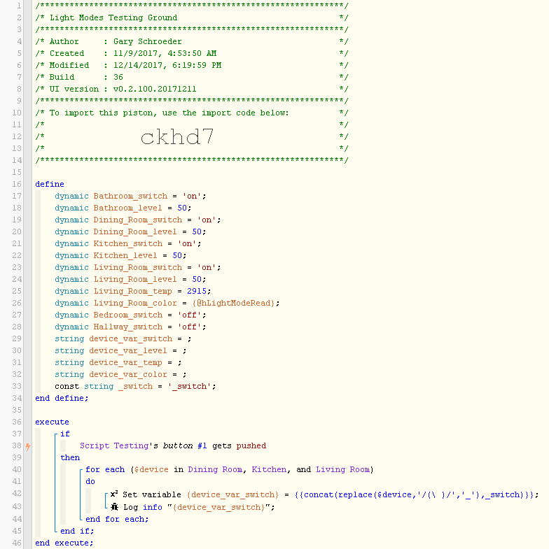

I’m trying to create a For Each loop that’ll walk through each light, pull the wanted settings from an array of variables, and apply them. The issue I’m running into is that when I try to apply the settings for the variable to a placeholder variable, it saves the variables’ name instead of the value it holds. Because of the way it functions, it has to auto-generate the name of the variable pulled with each run-through, which is part of what I think the issue is.
Keep in mind this’s a small test script; I have more than three rooms, so I’d need to be able to expand whatever was used.
That the value of the generated variable pointed to is saved.
The name of the variable is saved instead.
(I know it’s supposed to be a Green Snapshot, but the naming scheme is important to the way the script functions and there’s nothing that should be kept private.)

I set line 42 to use Expression as the type of value, so it should already have one. In addition, I added an additional set.
The idea is that, for now, each device has set levels I want. So, for instance, I want the bathroom lights to turn on. I set the variable to control this({Bathroom_switch}), and when the small block section runs, a small placeholder variable({device_var_switch}) is loaded with the information from {Bathroom_switch} by concatenating the $device in the current iteration plus the function being controlled. Hence, line 42 is saying “Load {device_var_switch} with $device plus _switch, after replacing all spaces in $device with underscores”. My intent is to eventually replace this long list of variables with arrays where each device is a single variable named after the location and light mode({Living_Room_NightLight}, for instance) holding the entire setup for that room, but that won’t be until I can get at least this part to work.
The problem seems to be that when it does that, instead of the result of the concatenation being the variable which calls the result, it’s a string of the variable name, and I’m not sure how I can force it to either A) Store it as a variable name(Thereby making {device_var_switch} = {Bathroom_switch} = on) or B) Have it immediately turn into the value held in the variable and store that in the variable({device_var_switch} = on). Either one would work, frankly.

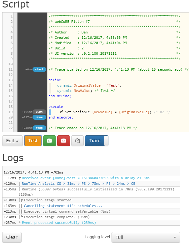

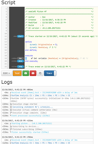

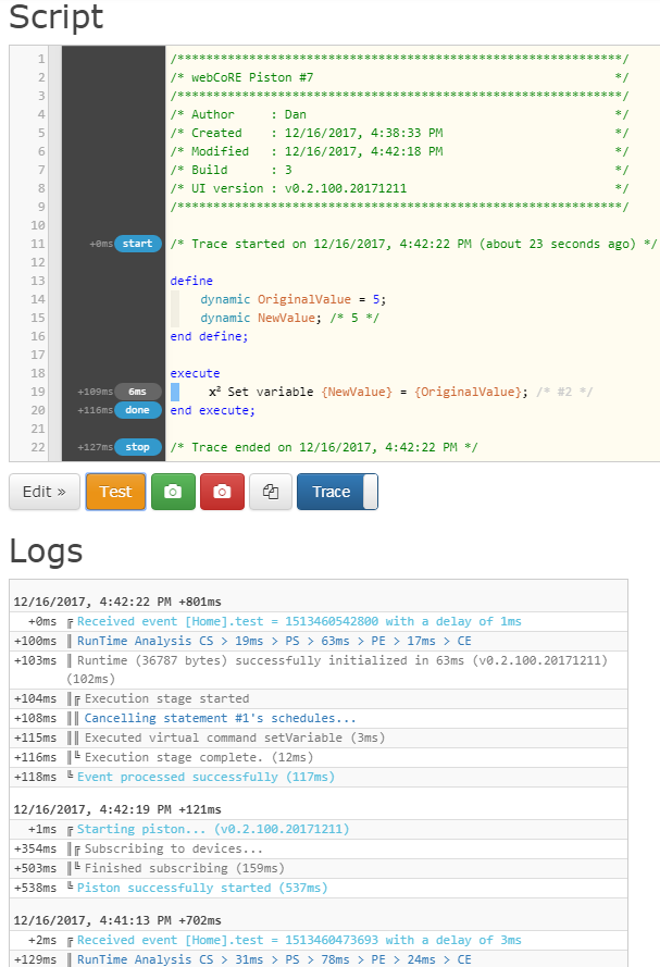

Is what you’re trying to do more complicated than this? Tried to use strings and integers - both worked fine:

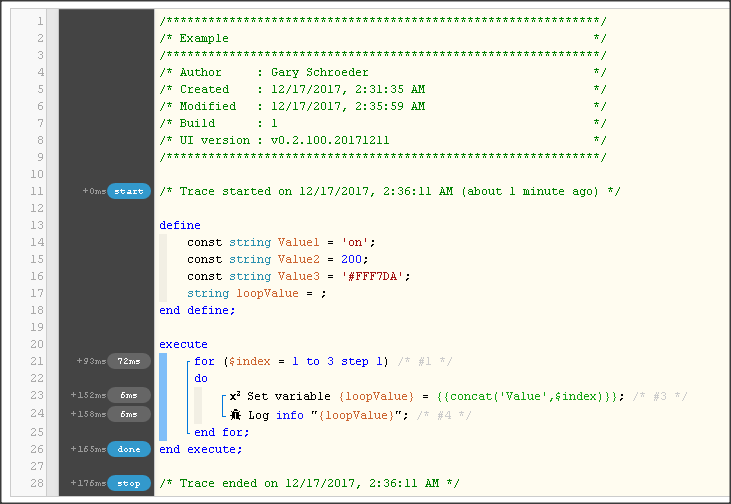

Yes. I’ve made another example, which shows just the concept I’m going for.
In this case, I have three static variables; Value1, Value2, and Value3. During each loop, I need to call a different one, so I put together an concatenation expression to pair together the string “Value” and the loop index to create the names of the variables. Thus, on loop 1 the variable Value1 will be generated and loaded into loopValue, and loopValue should have a value of “on”, since that is the value of Value1. Instead, it loads the literal string “Value1”.

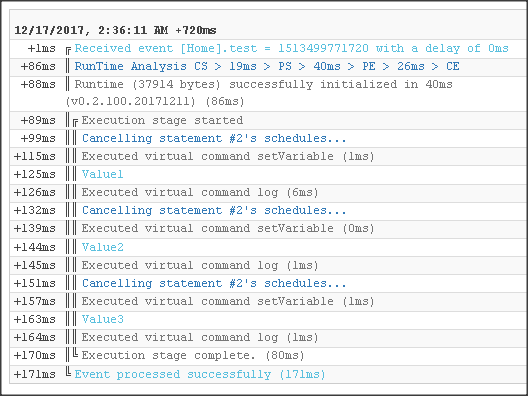

125ms, 144ms, and 163ms shows the current value of loopValue, and in all three cases it’s literally just the name of the variable, not the contents. In creating this example, I also added curly brackets around the concat() function, and put it in as an expression, which should have implied curly brackets as well.
