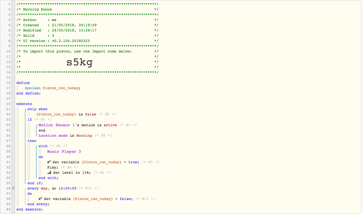

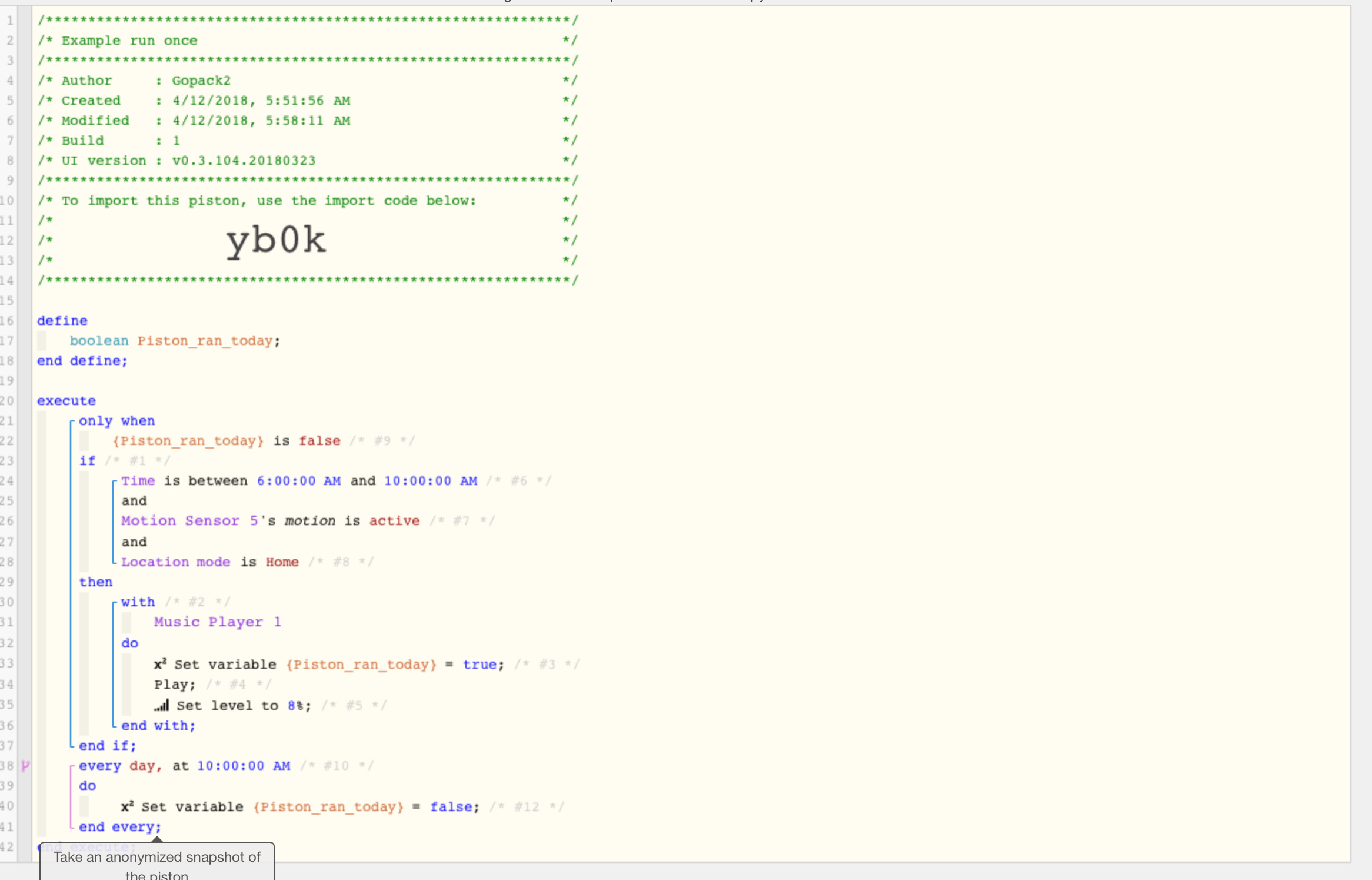

How about something like this

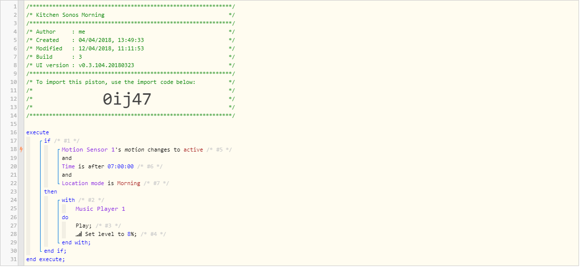

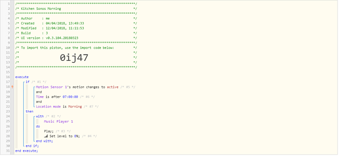

Sorry to re-ignite this one… I tried the example as detailed above but no cigar.
Nick
Your piston is not subscribed to anything.
Which bit needs to subscribe? The if once? Or play?
I would force Motion 1 to subscribe so that it will watch for events.
