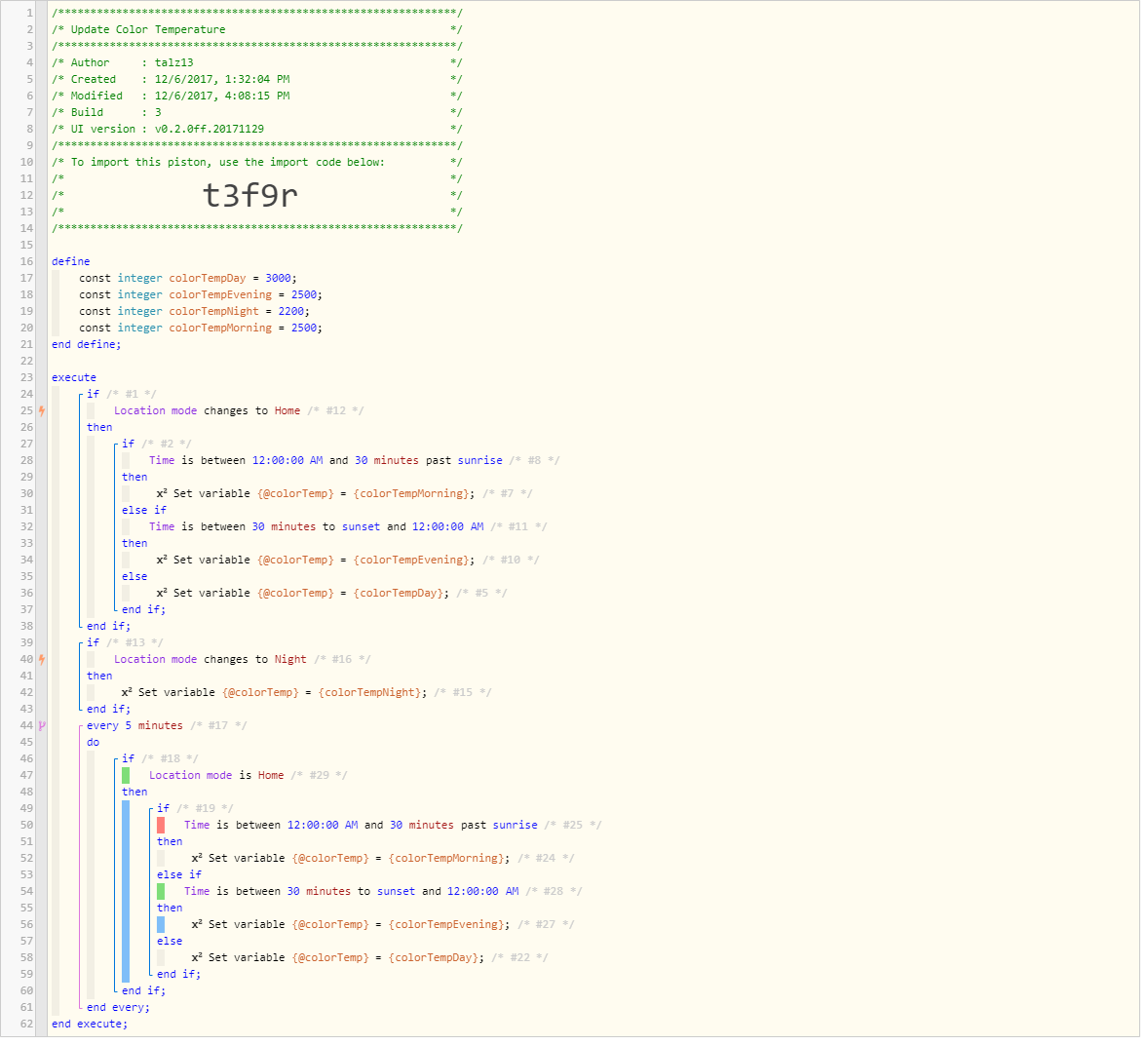

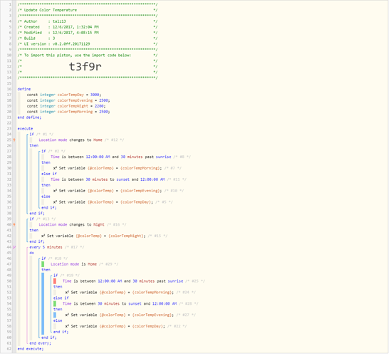

I’m doing just about exactly this… I have a piston that runs every 5 minutes when location mode is Home, and assigns a global variable @colorTemp based on the time of day (e.g. midnight - 30 minutes past sunrise, 30 minutes before sunset to midnight, and times in between the two). My other pistons reference this global variable, and set the color temperature at run time…
So, if the light was previously 2500K, but the motion sensor piston turns the light on at noon, it’s going to turn on, then change the temp to 3000K. It’s not going to turn the light on if it’s off, because it’s running with the action that turns the light on.
I’m also in progress in making a piston that will look at all of my color / color temperature capable lights that are currently turned on, and update the color temperature if it’s not the correct value on the global var.

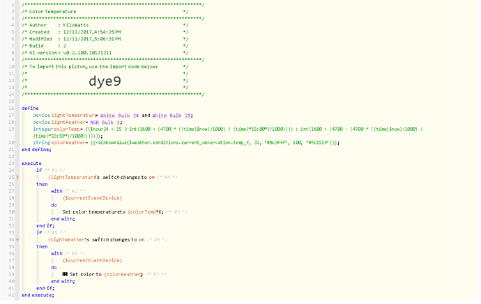

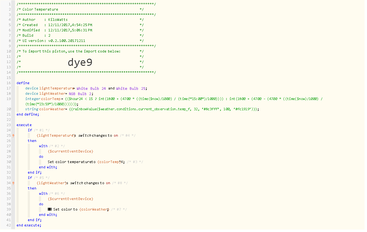

Try something like this
Define
Device lights - add all devices to control
Integer colorTemp - ($hour24 < 12 ? 7500 : 3000)
End define
If any of {lights} changes to on
Using {$currentEventDevice}
Set color temp to {colorTemp}
End if
