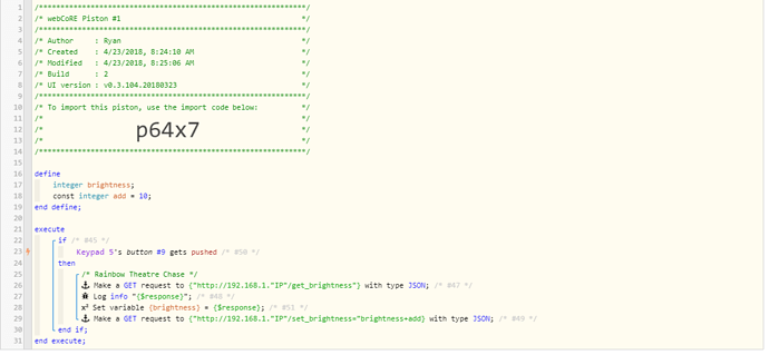

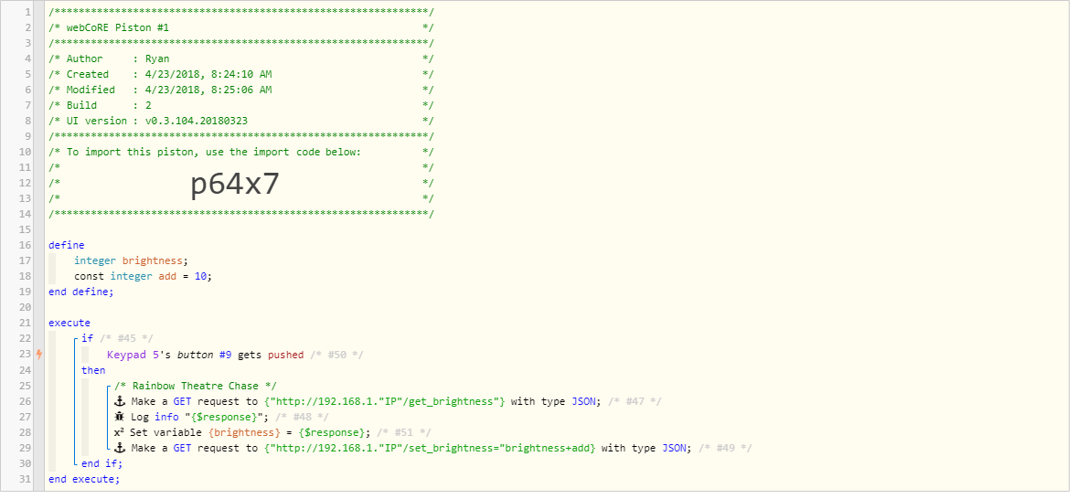

I am trying to use a mathematical function to add 10 to an integer variable. I have tried everything I can think of and it continues to concatenate as if one of them was a string. I have even gone so far as to store the amount to add in an integer variable so that it knows that’s an integer as well. I don’t understand why it is treating one of these as a string. They are clearly numerical.

What happens if change your set variable line to:
Set variable {brightness} = decimal($response)?
If you get decimal values and don’t want them, you could try
Set variable {brightness} = round($response,0)
or
Set variable {brightness} = round(decimal($response),0) if the above returns an error. I’ve never tried to ‘round’ text.
There has to be something wrong with WebCore because the piston is ecuting 3 times and screwing everything up. It sets it correct and then sends another request to the server.
All of this is from pressing the button once.

To me it looks like WebCore thinks it is getting two replies to the one GET, which is not the case.
I don’t believe so. This might be tied to the issue I saw this morning with IFTTT. It detected 3 triggers for one IFTTT event as well.
When I try the same call in Postman, I only get one response.
