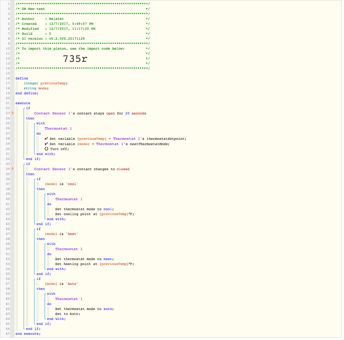

@Mightybuffalo2000 and @c1arkbar previously assisted with this piston but it needed to be changed again. Now I see a missing T-stat mode: ECO.
The GOAL: When patio door (contact sensor) is open > 2 minutes, turn off the tstat so that I don’t air condition the whole neighborhood (yes, I’m turning into my dad! LOL). When the door closes again, turn the tstat back on.
The CHALLENGE: I can’t have it just come back on- it needs to come back on to the same operating mode that it was in when it shut off (modes from the Nest tstat are: heat, cool, auto, eco). Also, it must come back on to the same temperature it was at when it was shut off- BUT the options available within webcore do not allow me to simply choose the temperature… Let’s say the temp was 71. Webcore options force me to choose a HeatingPoint of 71, or a CoolingPoint of 71 (depending on which mode it was originally in). Therefore I broke it out into separate statements.
ECO mode is an available option on the physical tstat device, but it’s not an available mode within the piston’s options. How can I get around that??
12/7/2017, 11:20:37 PM +984ms
+1ms ╔Received event [Slider Door].contact = closed with a delay of 218ms
+179ms ║RunTime Analysis CS > 13ms > PS > 123ms > PE > 43ms > CE
+192ms ║Runtime (40220 bytes) successfully initialized in 123ms (v0.2.0ff.20171129) (190ms)
+193ms ║╔Execution stage started
+203ms ║║Comparison (enum) closed stays (string) open = false (1ms)
+205ms ║║Cancelling any timed trigger schedules for condition 6
+206ms ║║Cancelling statement #6’s schedules…
+207ms ║║Condition #6 evaluated false (9ms)
+208ms ║║Condition group #1 evaluated false (state did not change) (9ms)
+214ms ║║Comparison (enum) closed changes_to (string) closed = true (0ms)
+215ms ║║Cancelling condition #9’s schedules…
+216ms ║║Condition #9 evaluated true (5ms)
+217ms ║║Cancelling condition #7’s schedules…
+217ms ║║Condition group #7 evaluated true (state changed) (7ms)
+223ms ║║Comparison (string) heat is (string) cool = false (2ms)
+224ms ║║Condition #14 evaluated false (4ms)
+225ms ║║Condition group #10 evaluated false (state did not change) (6ms)
+231ms ║║Comparison (string) heat is (string) heat = true (2ms)
+232ms ║║Condition #19 evaluated true (4ms)
+233ms ║║Condition group #15 evaluated true (state did not change) (6ms)
+235ms ║║Cancelling statement #16’s schedules…
+245ms ║║Skipped execution of physical command [Nest Thermostat - First Floor].setThermostatMode([heat]) because it would make no change to the device. (4ms)
+246ms ║║Executed [Nest Thermostat - First Floor].setThermostatMode (5ms)
+566ms ║║Executed physical command [Nest Thermostat - First Floor].setHeatingSetpoint([70.0]) (317ms)
+567ms ║║Executed [Nest Thermostat - First Floor].setHeatingSetpoint (318ms)
+573ms ║║Comparison (string) heat is (string) Auto = false (1ms)
+575ms ║║Condition #24 evaluated false (4ms)
+575ms ║║Condition group #20 evaluated false (state did not change) (6ms)
+578ms ║╚Execution stage complete. (385ms)
+586ms ╚Event processed successfully (585ms)
12/7/2017, 11:20:30 PM +448ms
+2ms ╔Received event [Slider Door].contact = open with a delay of 222ms
+103ms ║RunTime Analysis CS > 13ms > PS > 39ms > PE > 51ms > CE
+111ms ║Runtime (40213 bytes) successfully initialized in 39ms (v0.2.0ff.20171129) (109ms)
+123ms ║║Comparison (enum) open stays (string) open = true (1ms)
+126ms ║║Adding a timed trigger schedule for condition 6
+128ms ║║Condition #6 evaluated false (10ms)
+129ms ║║Condition group #1 evaluated false (state did not change) (11ms)
+135ms ║║Comparison (enum) open changes_to (string) closed = false (1ms)
+136ms ║║Cancelling condition #9’s schedules…
+137ms ║║Condition #9 evaluated false (5ms)
+138ms ║║Cancelling condition #7’s schedules…
+139ms ║║Condition group #7 evaluated false (state changed) (8ms)
+142ms ║╚Execution stage complete. (29ms)
+143ms ║Setting up scheduled job for Thu, Dec 7 2017 @ 11:20:50 PM EST (in 19.984s)
+160ms ╚Event processed successfully (160ms)
12/7/2017, 11:18:04 PM +630ms
+1ms ╔Received event [Slider Door].contact = closed with a delay of 913ms
+88ms ║RunTime Analysis CS > 17ms > PS > 34ms > PE > 37ms > CE
+99ms ║Runtime (40217 bytes) successfully initialized in 34ms (v0.2.0ff.20171129) (97ms)
+100ms ║╔Execution stage started
+111ms ║║Comparison (enum) closed stays (string) open = false (2ms)
+113ms ║║Cancelling any timed trigger schedules for condition 6
+114ms ║║Cancelling statement #6’s schedules…
+114ms ║║Condition #6 evaluated false (9ms)
+115ms ║║Condition group #1 evaluated false (state did not change) (10ms)
+122ms ║║Comparison (enum) closed changes_to (string) closed = true (1ms)
+123ms ║║Cancelling condition #9’s schedules…
+124ms ║║Condition #9 evaluated true (6ms)
+125ms ║║Cancelling condition #7’s schedules…
+126ms ║║Condition group #7 evaluated true (state changed) (8ms)
+132ms ║║Comparison (string) heat is (string) cool = false (1ms)
+133ms ║║Condition #14 evaluated false (5ms)
+134ms ║║Condition group #10 evaluated false (state did not change) (6ms)
+141ms ║║Comparison (string) heat is (string) heat = true (1ms)
+142ms ║║Condition #19 evaluated true (5ms)
+143ms ║║Condition group #15 evaluated true (state did not change) (7ms)
+145ms ║║Cancelling statement #16’s schedules…
+155ms ║║Skipped execution of physical command [Nest Thermostat - First Floor].setThermostatMode([heat]) because it would make no change to the device. (4ms)
+156ms ║║Executed [Nest Thermostat - First Floor].setThermostatMode (6ms)
+628ms ║║Executed physical command [Nest Thermostat - First Floor].setHeatingSetpoint([70.0]) (469ms)
+629ms ║║Executed [Nest Thermostat - First Floor].setHeatingSetpoint (471ms)
+638ms ║║Comparison (string) heat is (string) Auto = false (2ms)
+639ms ║║Condition #24 evaluated false (6ms)
+640ms ║║Condition group #20 evaluated false (state did not change) (7ms)
+643ms ║╚Execution stage complete. (544ms)
+651ms ╚Event processed successfully (651ms)
12/7/2017, 11:17:57 PM +450ms
+1ms ╔Received event [Slider Door].contact = open with a delay of 325ms
+311ms ║RunTime Analysis CS > 12ms > PS > 256ms > PE > 42ms > CE
+320ms ║Runtime (40217 bytes) successfully initialized in 256ms (v0.2.0ff.20171129) (318ms)
+321ms ║╔Execution stage started
+333ms ║║Comparison (enum) open stays (string) open = true (2ms)
+335ms ║║Adding a timed trigger schedule for condition 6
+338ms ║║Condition #6 evaluated false (9ms)
+338ms ║║Condition group #1 evaluated false (state did not change) (11ms)
+344ms ║║Comparison (enum) open changes_to (string) closed = false (0ms)
+346ms ║║Condition #9 evaluated false (5ms)
+347ms ║║Condition group #7 evaluated false (state did not change) (6ms)
+349ms ║╚Execution stage complete. (28ms)
+351ms ║Setting up scheduled job for Thu, Dec 7 2017 @ 11:18:17 PM EST (in 19.986s)
+366ms ╚Event processed successfully (366ms)
12/7/2017, 11:17:20 PM +966ms
+1ms ╔Starting piston… (v0.2.0ff.20171129)
+222ms ║╔Subscribing to devices…
+237ms ║║Subscribing to Slider Door.contact…
+313ms ║║Subscribing to Nest Thermostat - First Floor…
+314ms ║╚Finished subscribing (101ms)
+345ms ║Comparison (enum) closed stays (string) open = false (3ms)
+359ms ║Cancelling condition #9’s schedules…
+360ms ║Cancelling condition #7’s schedules…
+367ms ║Comparison (string) heat is (string) cool = false (2ms)
+378ms ║Comparison (string) heat is (string) heat = true (2ms)
+387ms ║Comparison (string) heat is (string) Auto = false (1ms)
+404ms ╚Piston successfully started (403ms)
12/7/2017, 11:15:30 PM +745ms
+1ms ╔Received event [Slider Door].contact = closed with a delay of 956ms
+83ms ║RunTime Analysis CS > 14ms > PS > 38ms > PE > 32ms > CE
+224ms ║Runtime (40215 bytes) successfully initialized in 38ms (v0.2.0ff.20171129) (222ms)
+225ms ║╔Execution stage started
+235ms ║║Comparison (enum) closed stays (string) open = false (1ms)
+237ms ║║Cancelling any timed trigger schedules for condition 6
+237ms ║║Cancelling statement #6’s schedules…
+238ms ║║Cancelling condition #6’s schedules…
+239ms ║║Condition #6 evaluated false (9ms)
+240ms ║║Cancelling condition #1’s schedules…
+240ms ║║Condition group #1 evaluated false (state changed) (11ms)
+246ms ║║Comparison (enum) closed changes_to (string) closed = true (0ms)
+248ms ║║Cancelling condition #9’s schedules…
+248ms ║║Condition #9 evaluated true (5ms)
+249ms ║║Cancelling condition #7’s schedules…
+250ms ║║Condition group #7 evaluated true (state changed) (7ms)
+256ms ║║Comparison (string) heat is (string) cool = false (2ms)
+257ms ║║Condition #14 evaluated false (5ms)
+258ms ║║Condition group #10 evaluated false (state did not change) (6ms)
+264ms ║║Comparison (string) heat is (string) heat = true (2ms)
+265ms ║║Condition #19 evaluated true (5ms)
+266ms ║║Condition group #15 evaluated true (state did not change) (6ms)
+268ms ║║Cancelling statement #16’s schedules…
+3363ms ║║Executed physical command [Nest Thermostat - First Floor].setThermostatMode([heat]) (3089ms)
+3364ms ║║Executed [Nest Thermostat - First Floor].setThermostatMode (3091ms)
+3677ms ║║Executed physical command [Nest Thermostat - First Floor].setHeatingSetpoint([70.0]) (310ms)
+3678ms ║║Executed [Nest Thermostat - First Floor].setHeatingSetpoint (312ms)
+3685ms ║║Comparison (string) heat is (string) Auto = false (2ms)
+3686ms ║║Condition #24 evaluated false (5ms)
+3687ms ║║Condition group #20 evaluated false (state did not change) (6ms)
+3690ms ║╚Execution stage complete. (3466ms)
+3697ms ╚Event processed successfully (3697ms)
12/7/2017, 11:15:05 PM +365ms
+1ms ╔Received event [Home].time = 1512706506555 with a delay of -1191ms
+187ms ║RunTime Analysis CS > 70ms > PS > 70ms > PE > 47ms > CE
+261ms ║Runtime (40217 bytes) successfully initialized in 70ms (v0.2.0ff.20171129) (258ms)
+262ms ║╔Execution stage started
+274ms ║║Cancelling condition #6’s schedules…
+276ms ║║Condition #6 evaluated true (2ms)
+278ms ║║Cancelling condition #1’s schedules…
+279ms ║║Condition group #1 evaluated true (state changed) (7ms)
+283ms ║║Cancelling statement #2’s schedules…
+298ms ║║Executed virtual command [Nest Thermostat - First Floor].setVariable (3ms)
+309ms ║║Executed virtual command [Nest Thermostat - First Floor].setVariable (4ms)
+6699ms ║║Executed physical command [Nest Thermostat - First Floor].off() (6386ms)
+6700ms ║║Executed [Nest Thermostat - First Floor].off (6389ms)
+6712ms ║║Condition #9 evaluated false (7ms)
+6713ms ║║Condition group #7 evaluated false (state did not change) (9ms)
+6716ms ║╚Execution stage complete. (6454ms)
+6725ms ╚Event processed successfully (6724ms)
12/7/2017, 11:14:46 PM +403ms
+2ms ╔Received event [Slider Door].contact = open with a delay of 381ms
+129ms ║RunTime Analysis CS > 16ms > PS > 56ms > PE > 57ms > CE
+138ms ║Runtime (40215 bytes) successfully initialized in 56ms (v0.2.0ff.20171129) (136ms)
+139ms ║╔Execution stage started
+150ms ║║Comparison (enum) open stays (string) open = true (2ms)
+152ms ║║Adding a timed trigger schedule for condition 6
+154ms ║║Condition #6 evaluated false (9ms)
+155ms ║║Condition group #1 evaluated false (state did not change) (11ms)
+162ms ║║Comparison (enum) open changes_to (string) closed = false (0ms)
+163ms ║║Condition #9 evaluated false (5ms)
+164ms ║║Condition group #7 evaluated false (state did not change) (6ms)
+166ms ║╚Execution stage complete. (27ms)
+168ms ║Setting up scheduled job for Thu, Dec 7 2017 @ 11:15:06 PM EST (in 19.985s)

12/7/2017, 11:13:44 PM +49ms
+5ms ╔Starting piston… (v0.2.0ff.20171129)
+244ms ║╔Subscribing to devices…
+288ms ║║Subscribing to Slider Door.contact…
+378ms ║║Subscribing to Nest Thermostat - First Floor…
+380ms ║╚Finished subscribing (150ms)
+419ms ║Comparison (enum) closed stays (string) open = false (7ms)
+435ms ║Cancelling condition #9’s schedules…
+436ms ║Cancelling condition #7’s schedules…
+443ms ║Comparison (string) heat is (string) cool = false (3ms)
+457ms ║Comparison (string) heat is (string) heat = true (1ms)
+458ms ║Cancelling condition #19’s schedules…
+459ms ║Cancelling condition #15’s schedules…
+470ms ║Comparison (string) heat is (string) Auto = false (2ms)
+490ms ╚Piston successfully started (489ms)
12/7/2017, 11:11:04 PM +984ms
+1ms ╔Received event [Slider Door].contact = closed with a delay of 455ms
+73ms ║RunTime Analysis CS > 12ms > PS > 38ms > PE > 23ms > CE
+82ms ║Runtime (40205 bytes) successfully initialized in 38ms (v0.2.0ff.20171129) (80ms)
+93ms ║║Comparison (enum) closed stays (string) open = false (1ms)
+95ms ║║Cancelling any timed trigger schedules for condition 6
+96ms ║║Cancelling statement #6’s schedules…
+97ms ║║Cancelling condition #6’s schedules…
+98ms ║║Condition #6 evaluated false (9ms)
+99ms ║║Cancelling condition #1’s schedules…
+99ms ║║Condition group #1 evaluated false (state changed) (11ms)
+105ms ║║Comparison (enum) closed changes_to (string) closed = true (0ms)
+107ms ║║Cancelling condition #9’s schedules…
+107ms ║║Condition #9 evaluated true (5ms)
+108ms ║║Cancelling condition #7’s schedules…
+109ms ║║Condition group #7 evaluated true (state changed) (7ms)
+115ms ║║Comparison (string) heat is (string) Cool = false (1ms)
+116ms ║║Condition #14 evaluated false (5ms)
+117ms ║║Condition group #10 evaluated false (state did not change) (6ms)
+123ms ║║Comparison (string) heat is (string) Heat = false (2ms)
+124ms ║║Condition #19 evaluated false (5ms)
+125ms ║║Condition group #15 evaluated false (state did not change) (6ms)
+131ms ║║Comparison (string) heat is (string) Auto = false (1ms)
+132ms ║║Condition #24 evaluated false (4ms)
+133ms ║║Condition group #20 evaluated false (state did not change) (6ms)
+136ms ║╚Execution stage complete. (53ms)
+143ms ╚Event processed successfully (143ms)
12/7/2017, 11:10:38 PM +364ms
+0ms ╔Received event [Home].time = 1512706239623 with a delay of -1260ms
+299ms ║RunTime Analysis CS > 222ms > PS > 53ms > PE > 24ms > CE
+309ms ║Runtime (39843 bytes) successfully initialized in 53ms (v0.2.0ff.20171129) (308ms)
+311ms ║╔Execution stage started
+318ms ║║Cancelling condition #6’s schedules…
+319ms ║║Condition #6 evaluated true (1ms)
+320ms ║║Cancelling condition #1’s schedules…
+321ms ║║Condition group #1 evaluated true (state changed) (4ms)
+324ms ║║Cancelling statement #2’s schedules…
+336ms ║║Executed virtual command [Nest Thermostat - First Floor].setVariable (3ms)
+348ms ║║Executed virtual command [Nest Thermostat - First Floor].setVariable (4ms)
+5265ms ║║Executed physical command [Nest Thermostat - First Floor].off() (4915ms)
+5266ms ║║Executed [Nest Thermostat - First Floor].off (4916ms)
+5279ms ║║Condition #9 evaluated false (8ms)
+5281ms ║║Condition group #7 evaluated false (state did not change) (10ms)
+5284ms ║╚Execution stage complete. (4974ms)
+5291ms ╚Event processed successfully (5292ms)
12/7/2017, 11:10:19 PM +516ms
+1ms ╔Received event [Slider Door].contact = open with a delay of 251ms
+84ms ║RunTime Analysis CS > 14ms > PS > 43ms > PE > 26ms > CE
+92ms ║Runtime (39816 bytes) successfully initialized in 43ms (v0.2.0ff.20171129) (90ms)
+104ms ║║Comparison (enum) open stays (string) open = true (2ms)
+106ms ║║Adding a timed trigger schedule for condition 6
+108ms ║║Condition #6 evaluated false (9ms)
+109ms ║║Condition group #1 evaluated false (state did not change) (11ms)
+116ms ║║Comparison (enum) open changes_to (string) closed = false (0ms)
+117ms ║║Condition #9 evaluated false (5ms)
+118ms ║║Condition group #7 evaluated false (state did not change) (6ms)
+121ms ║╚Execution stage complete. (27ms)
+122ms ║Setting up scheduled job for Thu, Dec 7 2017 @ 11:10:39 PM EST (in 19.986s)
+139ms ╚Event processed successfully (139ms)
