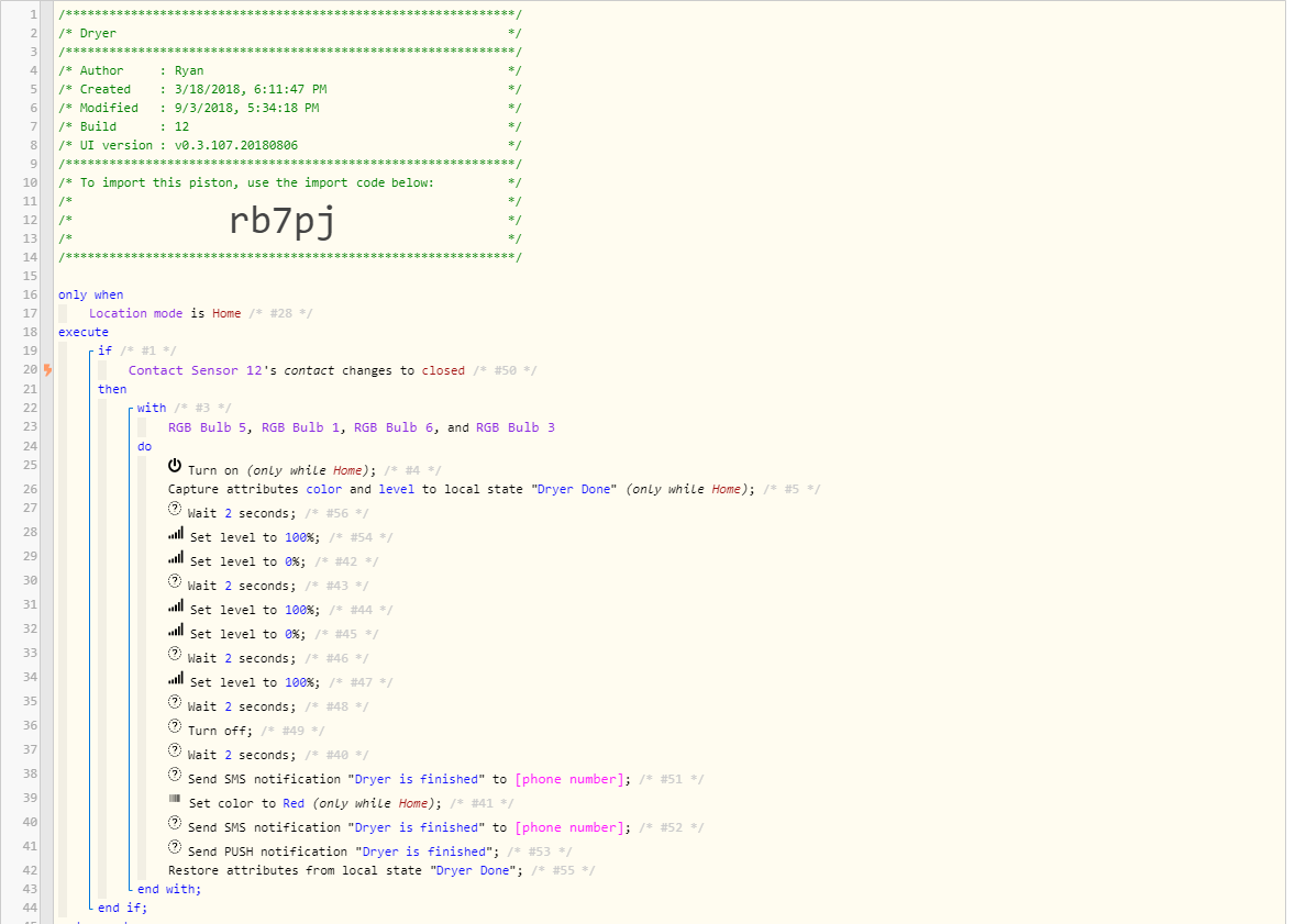

When I include location mode to home the piston will not work. If I remove the location mode line then piston works
To flash my lights and to text us when the dryer is finished while the mode is Home. I do not want notification at night if we start the dryer before going to bed.
Piston doesn’t work when location mode line is added. Piston works without location mode. I do have routines set for home, bed and away.

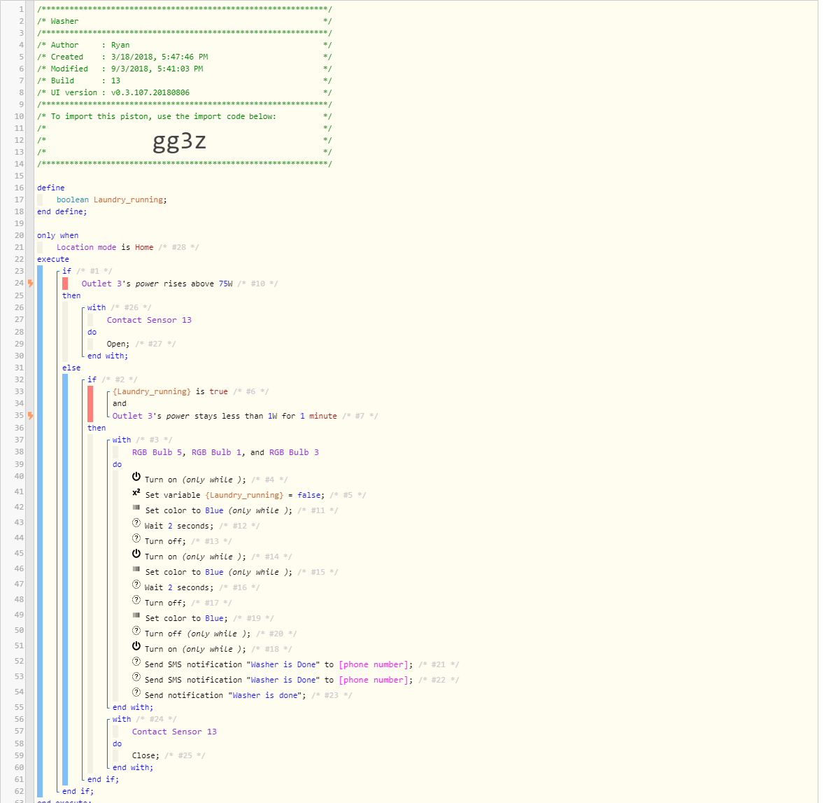

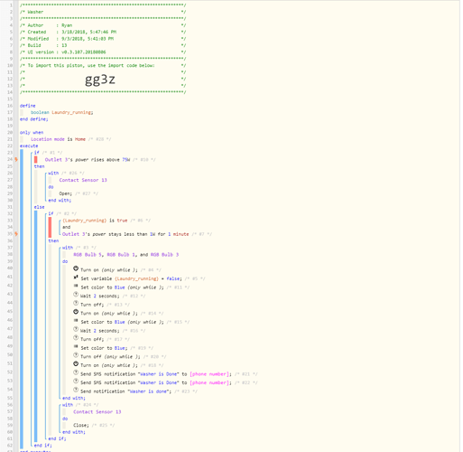

My dryer piston is now working but my washer is failing on the mode.
This is my washer piston. The contact sensor is a virtual sensor so when it triggers off, Alexa will say Dryer Finished.
