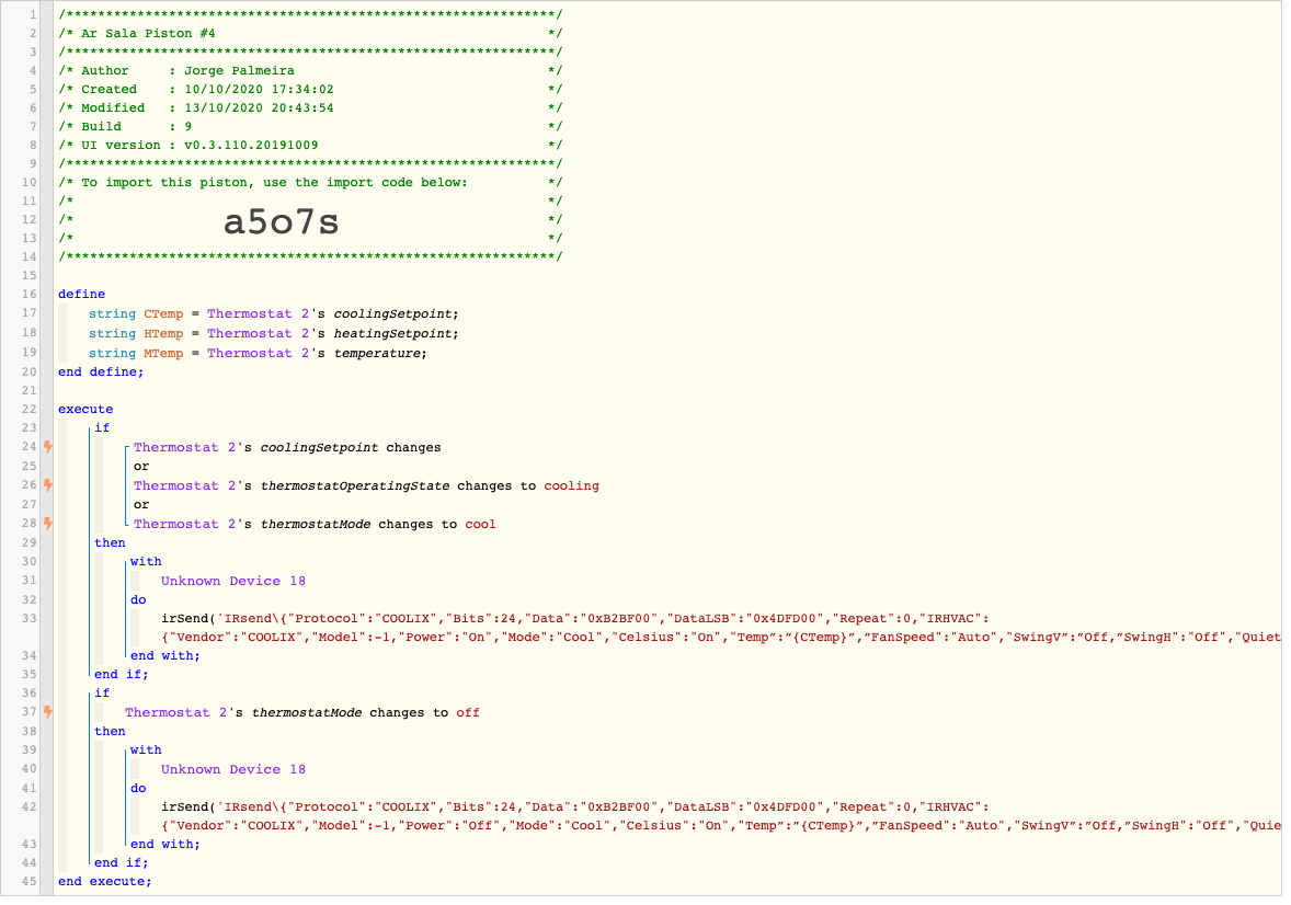

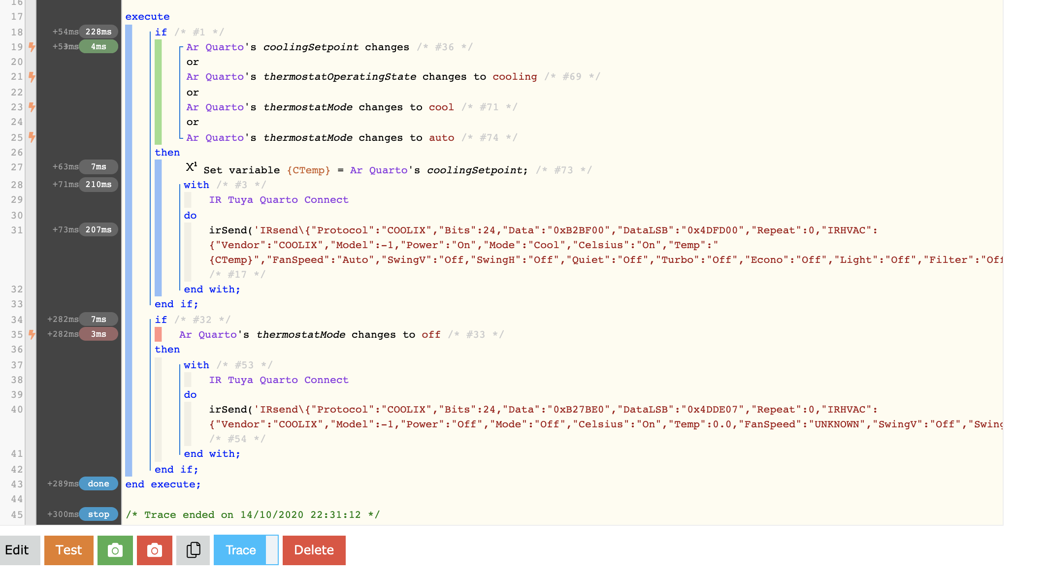

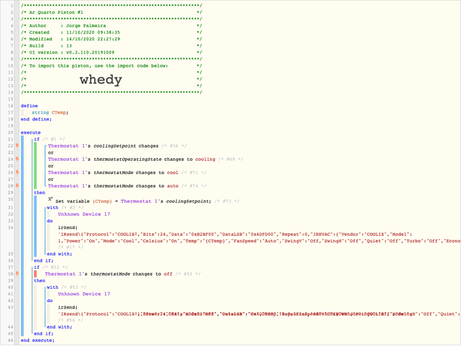

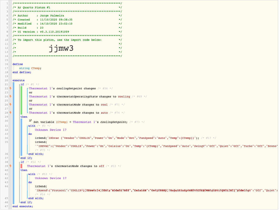

Hello guys, I need your help to try to assemble a piston. The idea would be through the command of a virtual thermostat to be able to modify the RHVAC code to be sent by an IR Tuya with Tasmota.
The code is this one below. I can’t find the solution to this problem, so I wanted to ask for help to solve this
Please if anyone can help
IR Blaster Post Request

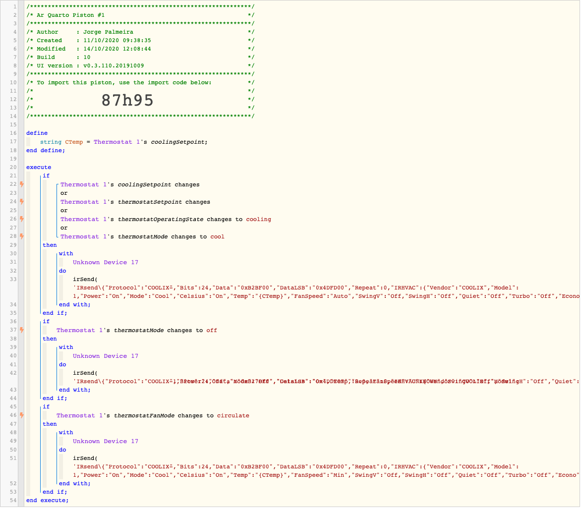

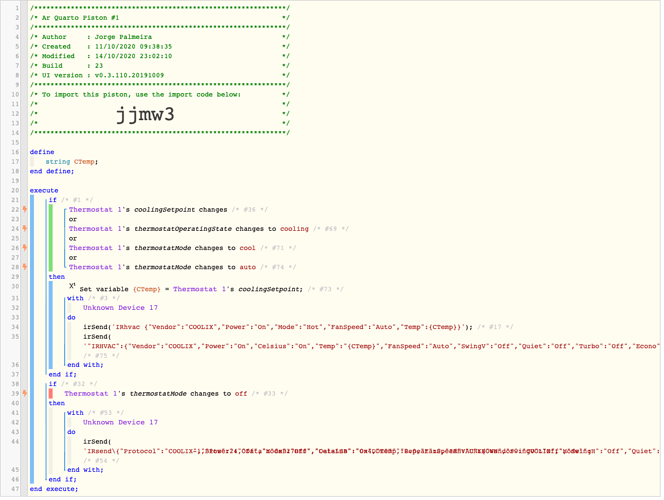

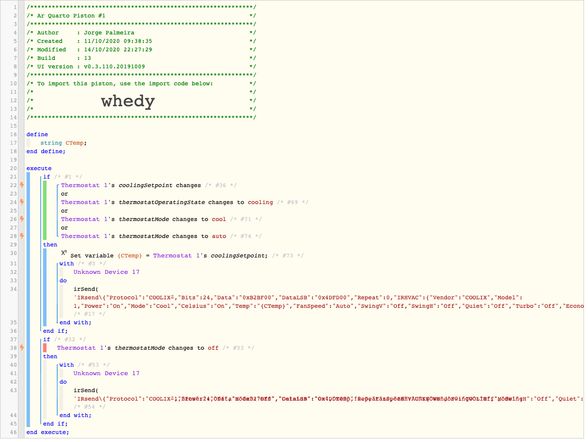

It looks like you have some bad “” check around “SwingV”:"Off,
I assume you are trying to send json string? the -1 also do not look like strings
Good catch on the missing quotes, @E_Sch … :+1:
(both lines 33 & 42)

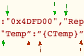

Upon closer examination, I notice that some of OP’s double quotes have been converted to “smart-quotes”… (as seen in this closeup snippet)
pic
  • The green arrows point to the standard “straight” quotes. (my recommendation)
  • The red arrows point to the “slanted” quotes. (which I try to avoid)
Note: There are many more variations in your code, but I just wanted to zoom in so you could see more clearly. (there’s at least 7 culprits on line 33, and at least 7 on line 42)
Pro Tip:
If you are editing on Windows, then Ctrl-Plus a few times can enlarge the webpage, to make it easier to distinguish between the two quotes. (Afterwards, Ctrl-0 will reset the webpage to the default size)
Thank you very much.

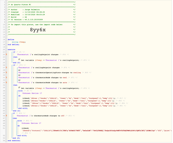

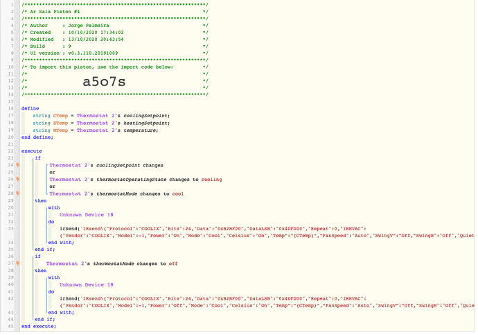

Here goes the piston with the corrections.
Do you think you would need to modify anything else?
This CTemp string would be a variable modified by the temperature of the thermostat.
I was wanting to do something similar with these variables

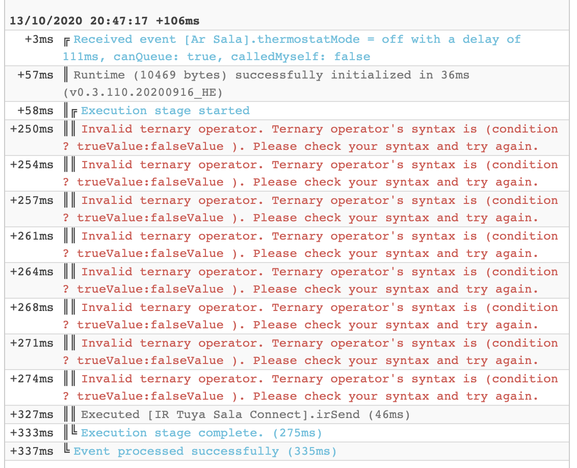

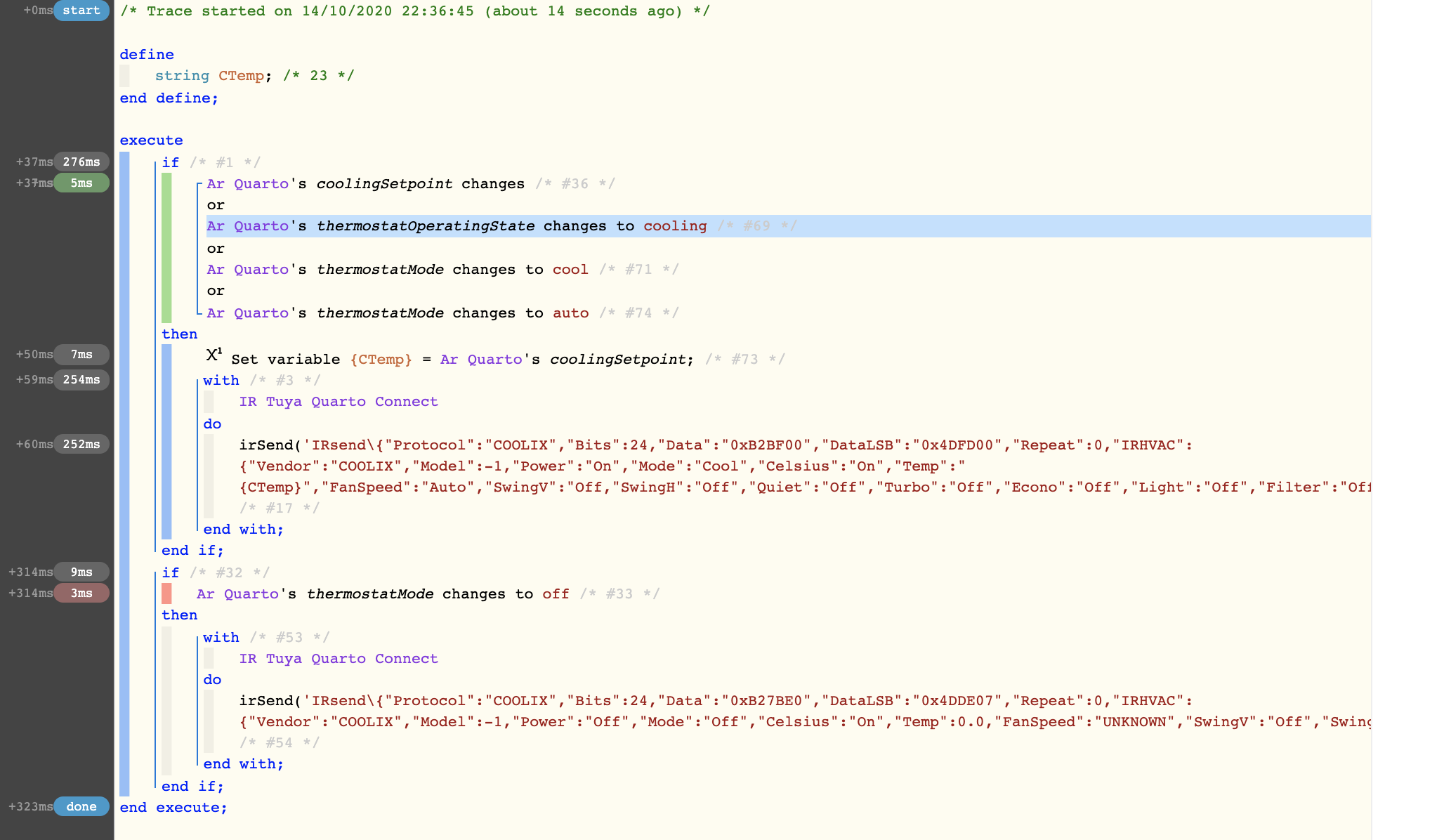

This one requires testing. Preferably with Trace turned on, and Log Level set to Full.

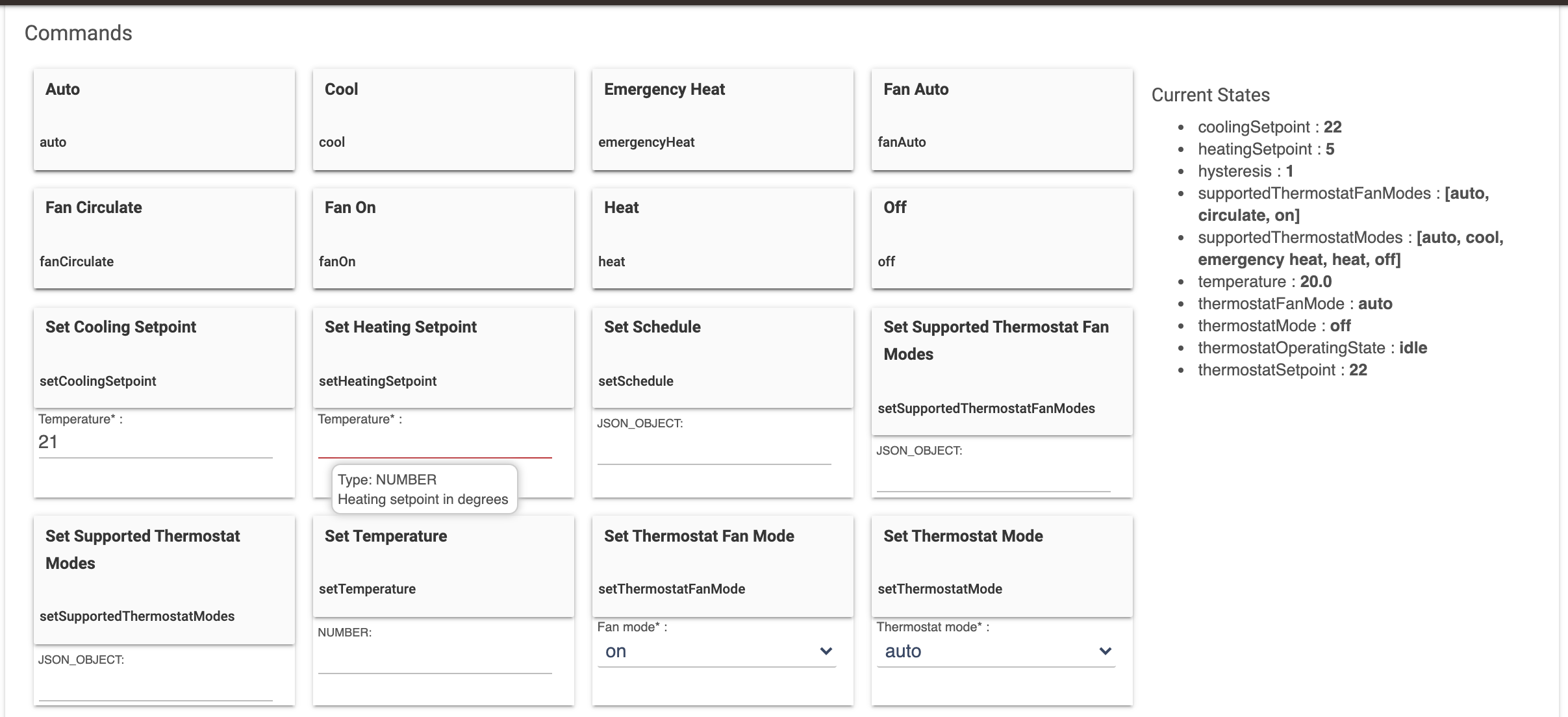

It is not working properly.

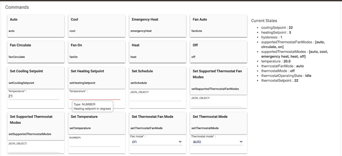

It sends the code but always with the same temperature, 17 degrees,
I need the temperature to vary according to the temperature I set on the thermostat.
Example: if I put 17 degrees in the thermostat, 17 degrees would be sent in the code; if I put 20 that would send 20

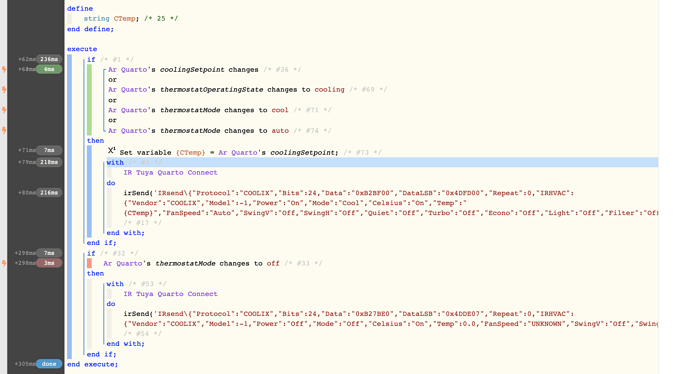

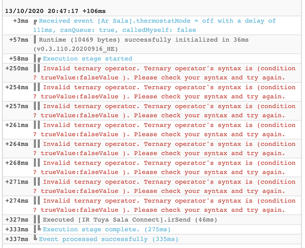

14/10/2020 20:09:46 +577ms
+3ms ╔Received event [Ar Quarto].thermostatMode = off with a delay of 62ms, canQueue: true, calledMyself: false
+33ms ║RunTime initialize > 32 LockT > 1ms > rtDT > 1ms > pistonT > 0ms (first state access 30 4 28)
+37ms ║Runtime (12741 bytes) successfully initialized in 1ms (v0.3.110.20200916_HE)
+39ms ║╔Execution stage started
+44ms ║║Condition #36 evaluated false (3ms)
+48ms ║║Condition #43 evaluated false (3ms)
+52ms ║║Condition #69 evaluated false (3ms)
+55ms ║║Comparison (enum) off changes_to (string) cool = false (1ms)
+57ms ║║Condition #71 evaluated false (4ms)
+58ms ║║Condition group #1 evaluated false (state did not change) (17ms)
+65ms ║║Comparison (enum) off changes_to (string) off = true (2ms)
+67ms ║║Cancelling condition #33's schedules...
+68ms ║║Condition #33 evaluated true (7ms)
+69ms ║║Cancelling condition #32's schedules...
+71ms ║║Condition group #32 evaluated true (state changed) (10ms)
+74ms ║║Cancelling statement #53's schedules...
+90ms ║║Calculating (integer)0 - (integer)1 >> (integer)-1
+129ms ║║Calculating (integer)0 - (integer)1 >> (integer)-1
+131ms ║║Invalid ternary operator. Ternary operator's syntax is (condition ? trueValue:falseValue ). Please check your syntax and try again.
+133ms ║║Calculating (string)Vendor : (string)COOLIX >> (string)
+135ms ║║Calculating (string) , (string)Model >> (string)Model
+137ms ║║Invalid ternary operator. Ternary operator's syntax is (condition ? trueValue:falseValue ). Please check your syntax and try again.
+139ms ║║Calculating (string)Model : (integer)-1 >> (string)
+141ms ║║Calculating (string) , (string)Power >> (string)Power
+143ms ║║Invalid ternary operator. Ternary operator's syntax is (condition ? trueValue:falseValue ). Please check your syntax and try again.
+145ms ║║Calculating (string)Power : (string)Off >> (string)
+147ms ║║Calculating (string) , (string)Mode >> (string)Mode
+149ms ║║Invalid ternary operator. Ternary operator's syntax is (condition ? trueValue:falseValue ). Please check your syntax and try again.
+151ms ║║Calculating (string)Mode : (string)Off >> (string)
+153ms ║║Calculating (string) , (string)Celsius >> (string)Celsius
+155ms ║║Invalid ternary operator. Ternary operator's syntax is (condition ? trueValue:falseValue ). Please check your syntax and try again.
+157ms ║║Calculating (string)Celsius : (string)On >> (string)
+159ms ║║Calculating (string) , (string)Temp >> (string)Temp
+161ms ║║Invalid ternary operator. Ternary operator's syntax is (condition ? trueValue:falseValue ). Please check your syntax and try again.
+163ms ║║Calculating (string)Temp : (decimal)0 >> (string)
+164ms ║║Calculating (string) , (string)FanSpeed >> (string)FanSpeed
+166ms ║║Invalid ternary operator. Ternary operator's syntax is (condition ? trueValue:falseValue ). Please check your syntax and try again.
+168ms ║║Calculating (string)FanSpeed : (string)UNKNOWN >> (string)
+170ms ║║Calculating (string) , (string)SwingV >> (string)SwingV
+172ms ║║Invalid ternary operator. Ternary operator's syntax is (condition ? trueValue:falseValue ). Please check your syntax and try again.
+174ms ║║Calculating (string)SwingV : (string)Off >> (string)
+175ms ║║Calculating (string) , (string)SwingH >> (string)SwingH
+177ms ║║Invalid ternary operator. Ternary operator's syntax is (condition ? trueValue:falseValue ). Please check your syntax and try again.
+179ms ║║Calculating (string)SwingH : (string)Off >> (string)
+181ms ║║Calculating (string) , (string)Quiet >> (string)Quiet
+183ms ║║Invalid ternary operator. Ternary operator's syntax is (condition ? trueValue:falseValue ). Please check your syntax and try again.
+185ms ║║Calculating (string)Quiet : (string)Off >> (string)
+186ms ║║Calculating (string) , (string)Turbo >> (string)Turbo
+188ms ║║Invalid ternary operator. Ternary operator's syntax is (condition ? trueValue:falseValue ). Please check your syntax and try again.
+190ms ║║Calculating (string)Turbo : (string)Off >> (string)
Clear
Full
To really understand the log, we’d need to see the green snapshot with Trace turned on.
Educated guess:
The errors are all from line 42
Strange… There is no reference to 17 anywhere in that log…
* deleted duplicate pics to reduce confusion *
Three times I changed the temperature of the thermostat but each time I got the same result in the code, 17 degrees celsius
{“IrReceived”:{“Protocol”:“COOLIX”,“Bits”:24,“Data”:“0xB2BF00”,“DataLSB”:“0x4DFD00”,“Repeat”:0,“IRHVAC”:{“Vendor”:“COOLIX”,“Model”:-1,“Power”:“On”,“Mode”:“Cool”,“Celsius”:“On”,“Temp”:17,“FanSpeed”:“Auto”,“SwingV”:“Off”,“SwingH”:“Off”,“Quiet”:“Off”,“Turbo”:“Off”,“Econo”:“Off”,“Light”:“Off”,“Filter”:“Off”,“Clean”:“Off”,“Beep”:“Off”,“Sleep”:-1}}}
22:28:10 RUL: IRRECEIVED#DATA performs “WebSend [192.168.86.244:39500] /?json={“IrReceived”:{“Data”:“0XB2BF00”}}”
22:28:10 SRC: Rule
22:28:16 RUL: IRRECEIVED#DATA performs “WebSend [192.168.86.244:39500] /?json={“IrReceived”:{“Data”:“0XB2BF00”}}”
22:29:00 RUL: IRRECEIVED#DATA performs “WebSend [192.168.86.244:39500] /?json={“IrReceived”:{“Data”:“0XB2BF00”}}”
22:29:00 SRC: Rule
22:36:44 RUL: IRRECEIVED#DATA performs “WebSend [192.168.86.244:39500] /?json={“IrReceived”:{“Data”:“0XB2BF00”}}”
22:37:31 RUL: IRRECEIVED#DATA performs “WebSend [192.168.86.244:39500] /?json={“IrReceived”:{“Data”:“0XB2BF00”}}”
Can you post a Full log of this happening? I want to see webCoRE processing the data.

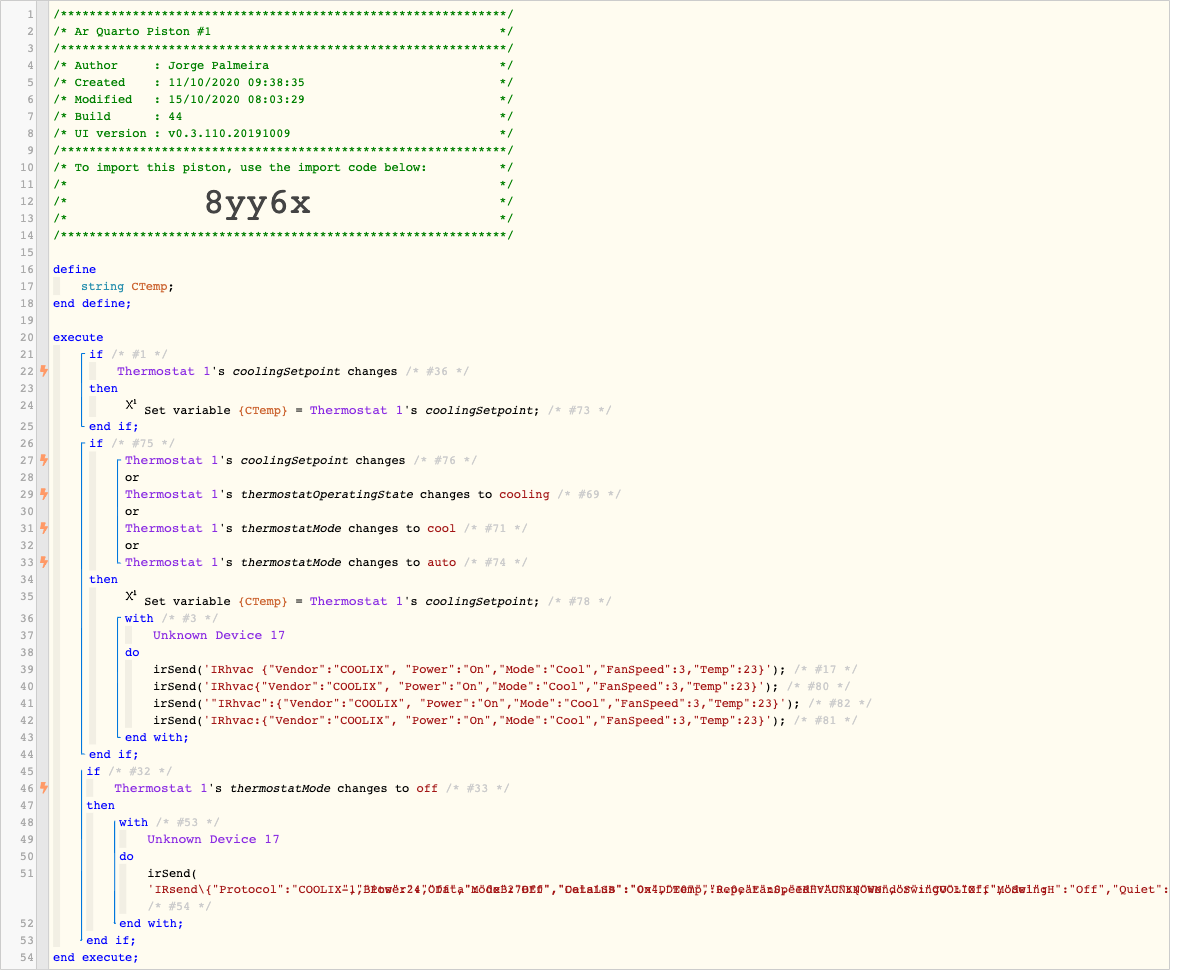

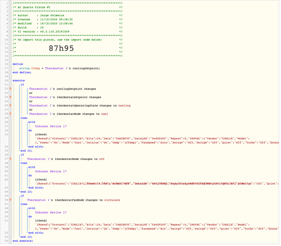

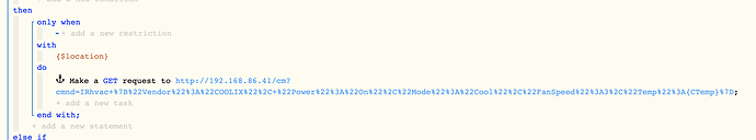

I discovered the error but I am unable to find the solution.
I was sending the 17 degree date every time. In this case, I have to do the control via RHVAC only. However I am not able to solve the code.
It may also be helpful if you breakdown the full logic flow so others can better understand what you are trying to do.
Here is how I understand your goals:
  • You manually adjust a virtual thermostat (Ar Quarto)
  • webCoRE sees the change, and a piston runs
  • webCoRE sends a command to IR Tuya Quarto Connect (Is this your MQTT server?)
  • The server processes the command, and sends out a IR signal to your RHVAC
Is this the flow you are trying to accomplish?
Here it go. Thanks for your considerations.

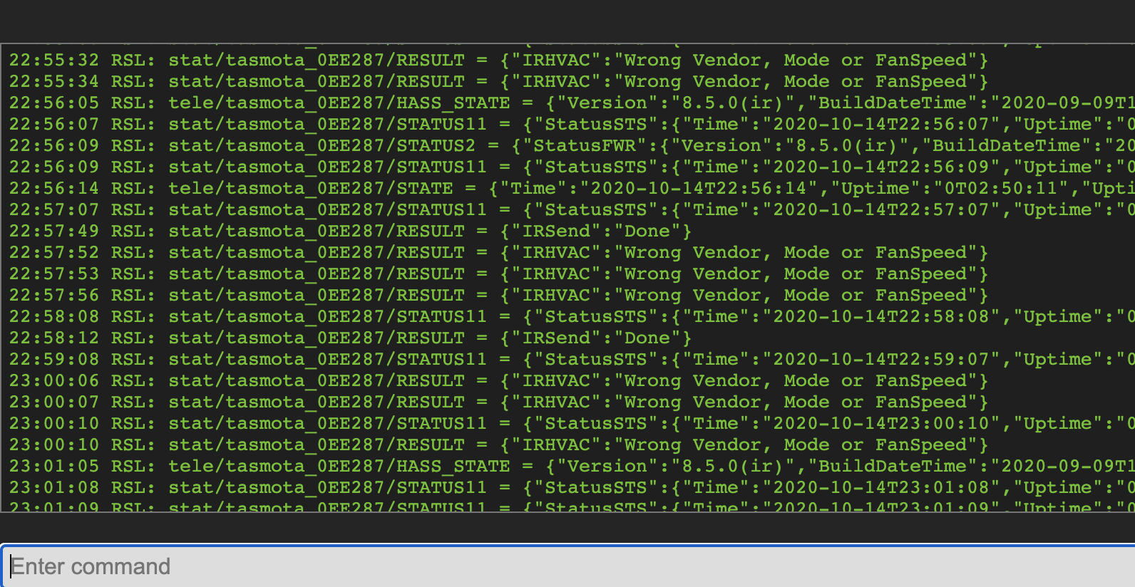

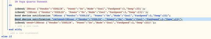

Yes, It’s my MQTTT server. I’m using UFO-R1 with Tasmota-IR.bin

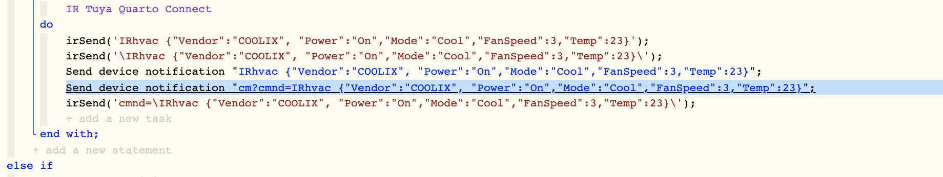

This code is working on the console, but when i go to the webcore is not working, i have that message
IRhvac {“Vendor”:“COOLIX”, “Power”:“On”,“Mode”:“Cool”,“FanSpeed”:3,“Temp”:23}
Tentei de todas as maneiras abaixo
#15
Thanks, but I am still waiting on an answer and a full log that matches the latest piston.
#16

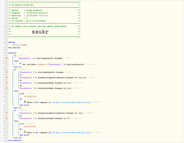

I would like to thank you very much for your help @WCmore
I ended up trying to rethink everything about the piston, and I came up with a solution that works
Now I’m having the temperature control correctly.
I am thinking on a way to incorporate the other commands in the piston now, like ventilation speed and hot or cold mode in the code
