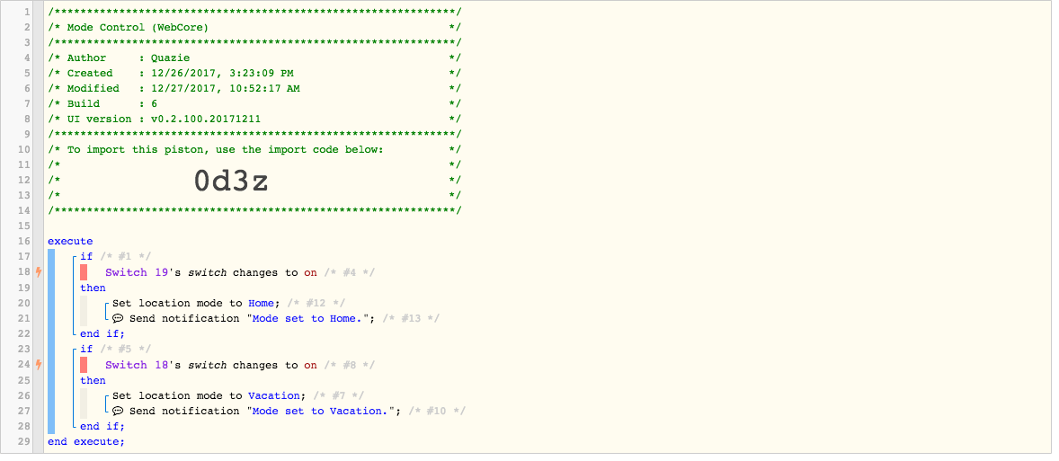

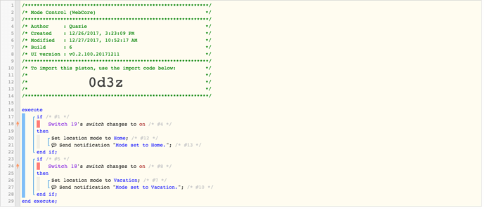

Momentary Button Tile hitting 10s semaphore wait and then timeout
My Momentary Button Tile based pistons keep hitting a 10s semaphore wait, and will often do nothing as a result
No semaphore wait (or a smaller one) - 10s seems to be some sort of timeout?
Odd delays keep happening, but only with momentary buttons - I think it’s because events are coming to fast? It might need a new device handler, but i’m unsure.

I tried your example and I’m getting almost the same thing except I changed the Task Cancellation Policy (TCP) to never so that the piston doesn’t cancel the task when the button goes to off status.
Click the with, then the cog, select Never cancel tasks for TCP. It works but not consistently.

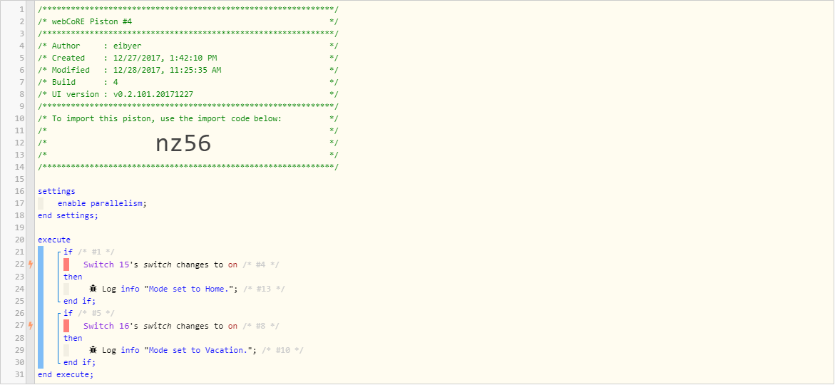

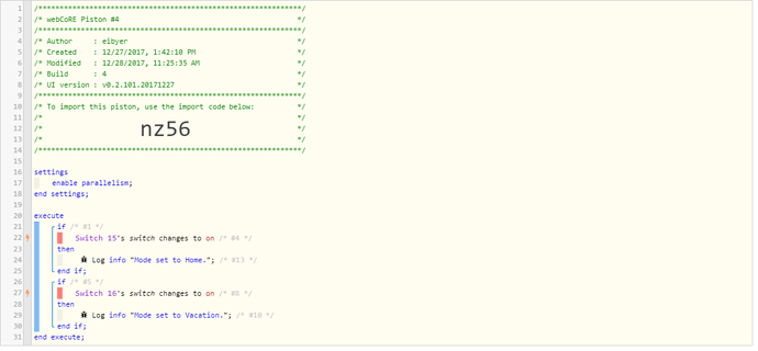

I toyed more about this today and tried enabling parallelism in the advanced settings. I got more consistent result with it.
12/28/2017, 11:27:08 AM +692ms
+100ms	║Mode set to Vacation.
12/28/2017, 11:27:05 AM +292ms
+110ms	║Mode set to Home.
12/28/2017, 11:27:02 AM +249ms
+117ms	║Mode set to Vacation.
12/28/2017, 11:26:56 AM +302ms
+90ms	║Mode set to Home.
12/28/2017, 11:26:52 AM +162ms
+98ms	║Mode set to Vacation.
12/28/2017, 11:26:46 AM +215ms
+94ms	║Mode set to Home.
