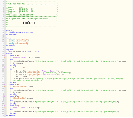

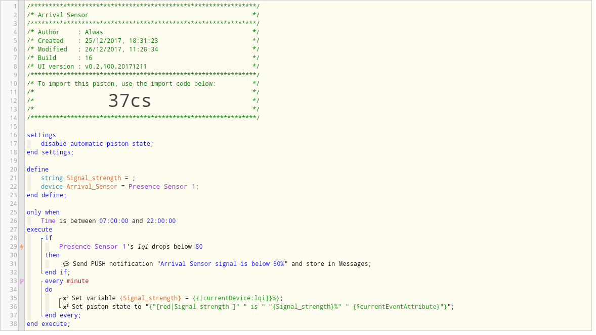

Happy Boxing Day to everyone. I’m using the great little DH by @ady624 that exposes the signal quality of the ST Presence Sensor, “lqi” and “rssi”.
Basically I’m trying to send myself a Push Notification when the Signal Strength drops below 80% AND I’m trying to update the Piston State with the current value of the signal so I always have a visual.
As above.
The Push Notification works, but If someone could make the piston state work that would be great.
You cannot use the $current**** variables in a timer - the device will always be location and the event name will always be time. Use a reference to the actual device variable and attribute [Arrival_Sensor:lqi]

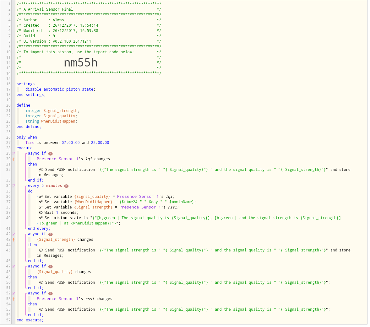

I’ve made some progress Ady and I appreciate your help.
I managed to get the signal quality and strength updating correctly in the Piston State by creating two variables, and using "{“The signal strength is " “{ Signal_quality}”} " and the signal quality is " “{ Signal_strength}””
BUT, now for some strange reason the push notifications won’t work! I’m using “if changes”, calling either the device or the variable, I’ve tried turning on/off async, turning on/off TCP but nothing is working. Surely “if Arrival Sensor signal changes” send Push should work?
