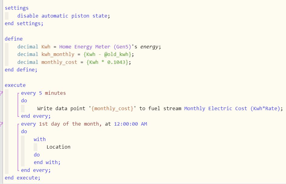

So I want to make a piston tallies the energy cost of a cabin every month
I would like it to feed a fuel stream that resets the first of every month. only the values feeding the fuel stream reset, not the whole stream
I have never dealt with something like this. Do I set a global variable that is the total energy at the first of the month and subtract it all month? (multiplying by my local kwh rate)
