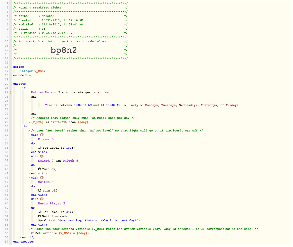

I must be overlooking something tiny- piston not firing. Using global variable for DATE to assure the piston only fires once per day.
Some lights go on, others off, Sonos makes an announcement
I don’t know how to upload pic to this forum but image is here (sorry! Pls tell me how to structure the upload command if the pic is on my Mac desktop)
After it should have fired, I turned on Full Logging in webcore, but what do I need to do in IDE to find them?
What is happening or not happening when this piston fires?
The lights didn’t go on or off as they should have. I’m not certain if the Sonos would have played the message- I had it commented-out this morning.
I’m in the IDE> My Locations> Home> Events right now. I searched and it appears as though the motion sensor saw the motion and the commands were sent to the devices (lights) but they didn’t seem to physically go on or off.

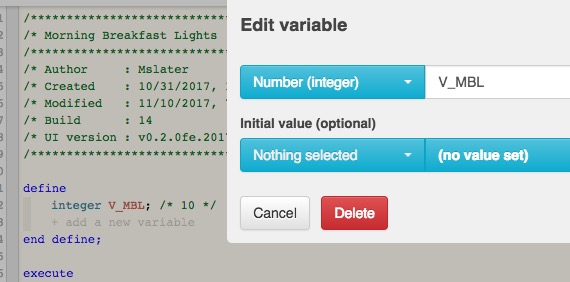

Do you have your variable set up like this?
Looks like it should be fine. I guess it fired today because it has /* 10 */ in the code. But the lights def didn’t come on/off as they should have.
