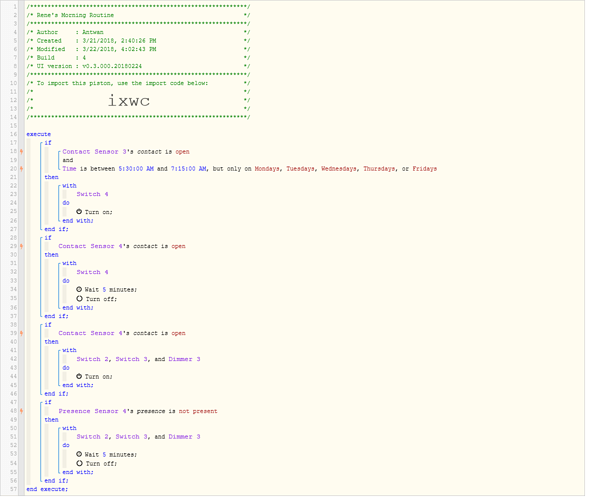

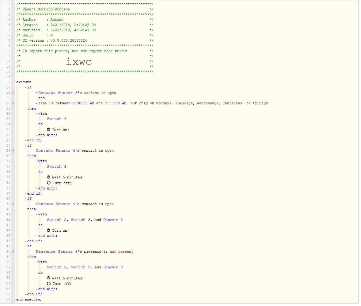

Lights turn off and on outside of period.
Lights turn on and off with designated sensor.
Lights turn on a 10pm or any other time.
Had to pause piston because of wife’s annoyance. I have it back on temporarily. Will post when developed.
You only have one of the four IF blocks restricted by time so the three not restricted will run anytime they are triggered. :slight_smile:
Ok. Thank you @jkp
