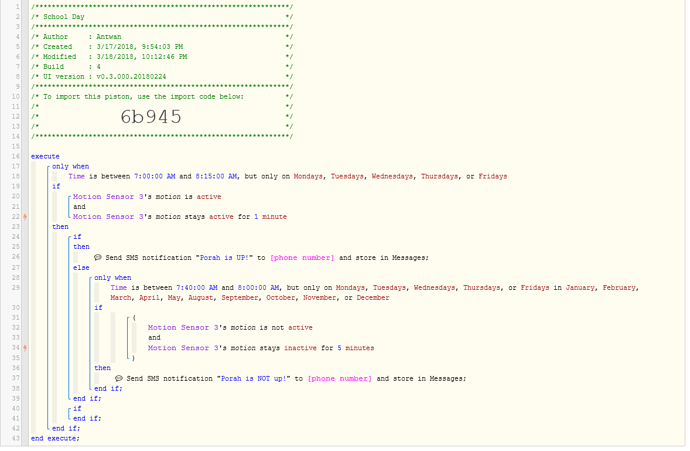

No notification received. I’m sure I have no clue what I’m doing but I tried. LOL.
Receive notification when child is up or not up for school.
Nothing.
School Day
Status
This piston is currently active and humming happily.
Piston Category
Quick Facts
Piston state: false
Last executed: 3/20/2018, 7:49:12 AM
Next scheduled: never
Subscriptions: 1 event, no controls
Devices used: 1
Memory used: 27% (26957 bytes)
External URL: (click to open/execute)
Automatic Backup
Automatic backup enabled.
Click the box to reveal your backup bin code. Make a note of this code as you may use it later to restore a deleted piston.
XXXXX
Do NOT share this code with anyone.

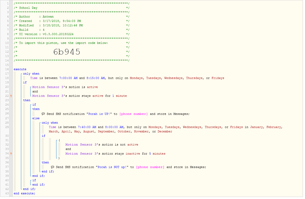

Script
/* School Day */
/* Author : Antwan /
/ Created : 3/17/2018, 9:54:03 PM /
/ Modified : 3/18/2018, 10:12:46 PM /
/ Build : 4 /
/ UI version : v0.3.000.20180224 */
execute
only when
Time is between 7:00:00 AM and 8:15:00 AM, but only on Mondays, Tuesdays, Wednesdays, Thursdays, or Fridays
if
Porah’s Motion Sensor’s motion is active
and
Porah’s Motion Sensor’s motion stays active for 1 minute
then
if
then
Send SMS notification “Porah is UP!” to xxxxxxxxx and store in Messages;
else
only when
Time is between 7:40:00 AM and 8:00:00 AM, but only on Mondays, Tuesdays, Wednesdays, Thursdays, or Fridays in January, February, March, April, May, August, September, October, November, or December
if
Porah’s Motion Sensor’s motion is not active
and
Porah’s Motion Sensor’s motion stays inactive for 5 minutes
then
Send SMS notification “Porah is NOT up!” to XXXXXXXXX and store in Messages;
end if;
end if;
if
end if;
end if;
end execute;

+136ms ║Runtime (40791 bytes) successfully initialized in 72ms (v0.3.000.20180224) (133ms)
+150ms ║║Comparison (time) 61637050 is_between (time) 25200000 … (time) 29700000 = false (6ms)
+152ms ║║Condition #15 evaluated false (10ms)
+153ms ║║Condition group #1 evaluated false (state did not change) (11ms)
+155ms ║╚Execution stage complete. (18ms)
+156ms ╚Event processed successfully (156ms)
3/19/2018, 5:07:01 PM +887ms
+1ms ╔Received event [Porah’s Motion Sensor].motion = active with a delay of 65ms
+90ms ║RunTime Analysis CS > 16ms > PS > 41ms > PE > 32ms > CE
+92ms ║Runtime (40788 bytes) successfully initialized in 41ms (v0.3.000.20180224) (90ms)
+106ms ║║Comparison (time) 61621985 is_between (time) 25200000 … (time) 29700000 = false (6ms)
+108ms ║║Condition #15 evaluated false (10ms)
+109ms ║║Condition group #1 evaluated false (state did not change) (10ms)
+110ms ║╚Execution stage complete. (17ms)
+111ms ╚Event processed successfully (111ms)
