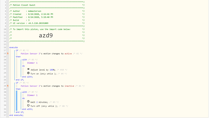

I have a Sengled Smart LED light that I have controlled with a motion sensor in my master closet. I have pasted the piston below. I would like to have the light always turn on at full brightness with motion. At night, I would also like it to turn on at 20% over night to act as a night light. My question is is this better done with a second piston or should I add conditions to this listed piston?
Always turn on at 100% with motion. From sunset to sunrise, light at 20% except when there is motion, then increase to 100% and return to 20% if no motion detected for 3 minutes.
The listed piston works
