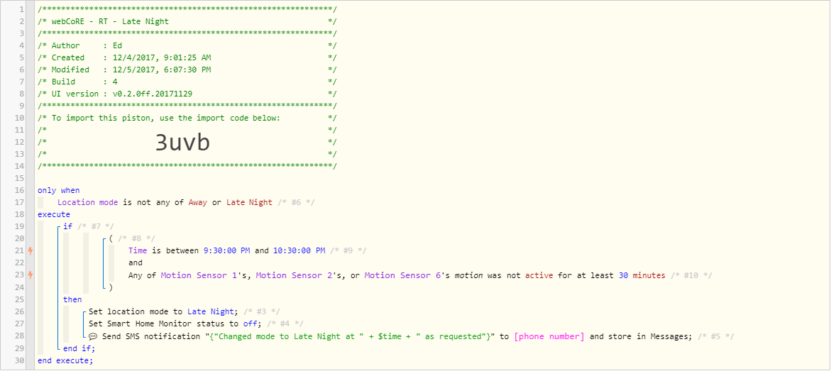

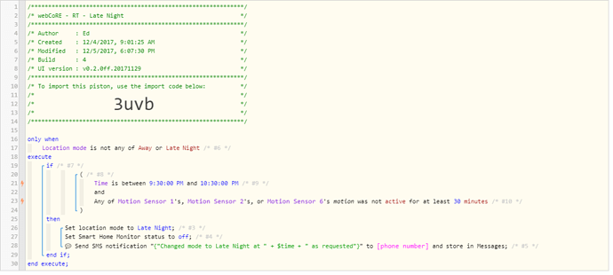

I’m trying to replace my routines in ST with a piston like routine in webCoRE. However, what I’m trying to do is detect no motion for 30 minutes between a certain time. Right now, my piston triggers 1 minute after the time. Is there a way to have a piston like routine that acts like the ST routines “Things Quiet Down”
Could it be possible that one of the sensors is already inactive for 30 minutes at 9:30?
Try changing it to all devices inactive and see if this helps.
Was looks at past time and is a condition. So when the piston evaluates it looks back at how the sensor was reporting.
Stays looks at future and is a trigger. So from the time it goes inactive it starts a timer.
So change was to stays and as @bobbles mentioned change any to all
Thanks. @bobbles I changed it to all. @c1arkbar I also changed it from was to stays. However, I’m always confusing triggers and conditions especially when time is part of the mix and I try not to mix the two as advised by @ady624.
