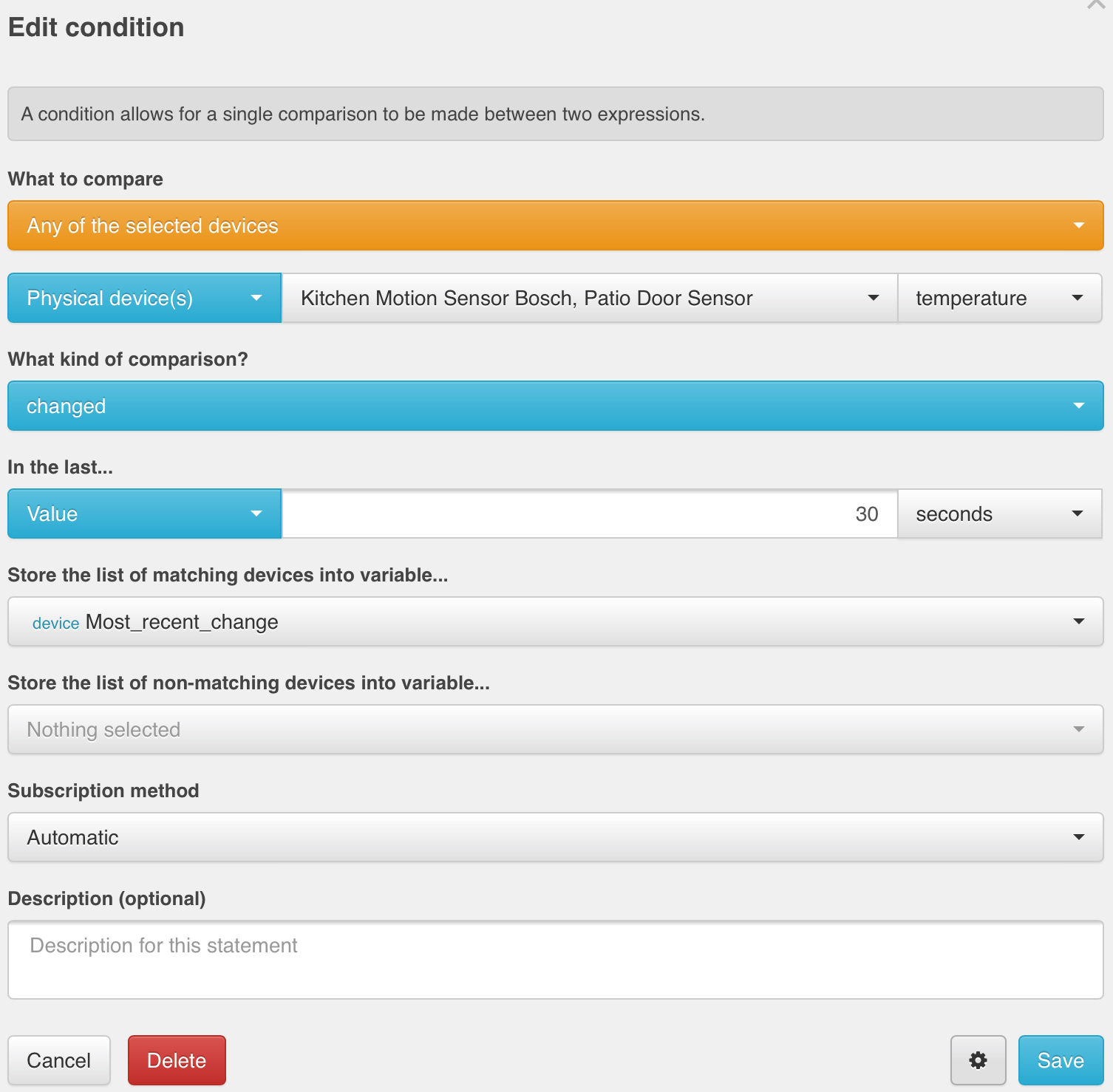

I have two temperature sensors in one room and I want to base the heat on the last sensor that reported the temperature. Is there a way to do that. Can you base a condition on the last time it changed?
(PUT YOUR INFO HERE)
(UPLOAD YOUR IMAGE HERE)
Like this?
The example from @Gopack2 could potentially list both devices in the variable, if both changed in the last 30 seconds.

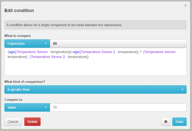

For a more reliable setup i would use the age([device name : device attribute]) function and a ternary operator (C ? T : F) to evaluate and compare the true age of each device and return the one that changed most recently.
(age([Temperature Sensor : temperature])<age([Temperature Sensor 2 : temperature]) ? [Temperature Sensor : temperature] : [Temperature Sensor 2 : temperature])
The example above will find the the device that changed most recently, and check if it has a value greater than 70
In my case, the device that changed most recently has a temperature reading of 69.
Change Temperature Sensor and Temperature Sensor 2 to represent the names of your two devices.
