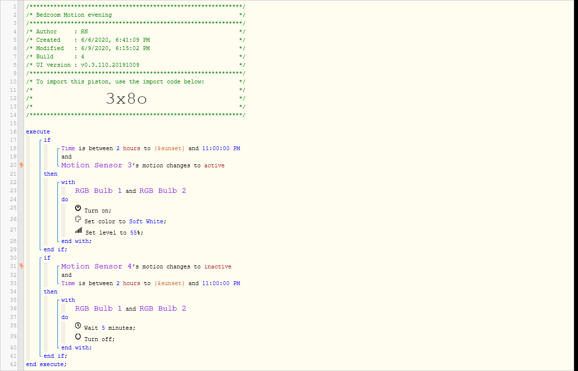

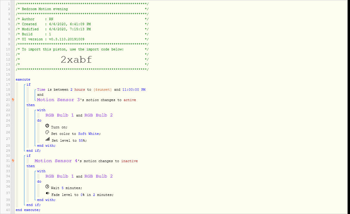

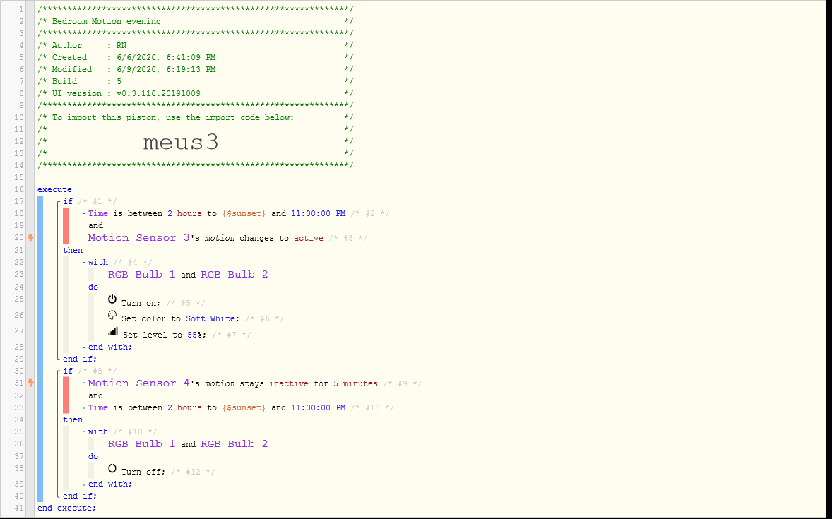

Hi Peeps my partner is starting to get well miffed with our lights turning on randomly throughout the night, any advice help would be greatly appreciated.
2No. hue lights turning on randomly through out the night,
After 11pm the piston should remain inactive until 2 hours before next sunrise.
The piston works fine during the allotted time frame and behaves as expected
