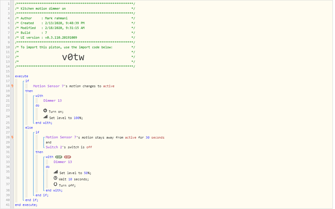

Motion sensor piston not firing when in the process of dimming
Wife is ready to dumb-down our smart house; replacing wife not a real option. This piston turns on with motion, then if it doesn’t detect motion for 30 seconds, dims then turns off… issue is, if motion resumes during the dimming period, it doesn’t come back on.
restart the piston and go back to full brightness if motion is detected
continues to turn off instead of turning back on
working remote so don’t have a valid log of this - but happens all the time:( I didn’t have the task cancellation policies int here initially, but added them hoping they’d help. they didn’t help. is there something wrong with my logic?

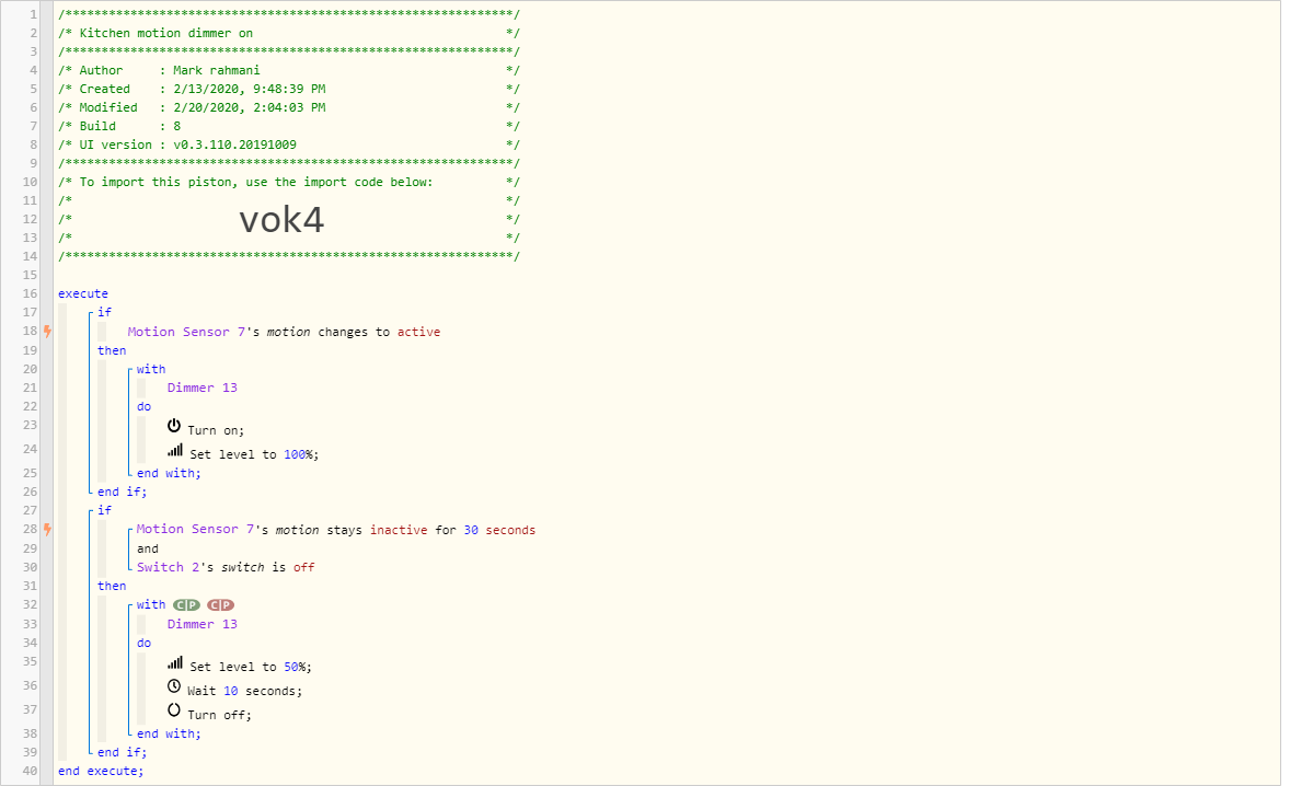

First thing is to pull that second IF on line 27 out as its own statement and not the ELSE of the first IF. After that I would change the trigger for that second IF to “stays inactive for x time” since that is the specific state you want it to reference.
thanks i’ll try the two tips… Look better? What about the task cancellation policies?

Not even sure what policies you have messed with there, but I’d stick to the defaults. The TEP and TSP should be left alone and the TCP default should do what you want.
I like the look of this better. I prefer the ‘stays’ timed trigger on the top level where I just about understand it. Whether it will work is another matter, and definitely one to test rather than think about. The timed trigger is more complex than it might seem.

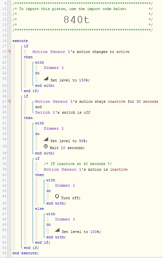

for lights turning OFF i’d never use WAIT
but everyone’s needs are different.
Normally, if you want to be able to cancel out of something, you want TCP set to default.
Personally, I would use a method like this, without any special settings or TCP.
With this method, any activity will cancel the wait, and go back to full brightness.
(lines 46+ should never run, but I added it as a safety net backup)

so a second safety check after the wait to make sure motion is still inactive… i’ll have to try that…
Upon closer inspection of 840t, the WITH on line 31 might need TCP set to Never.
(since we do not want it to cancel until after checking for movement)
Edit
Ignore my previous two lines… I think TCP set to default in this case is still better. The top trigger on 840t should catch any activity and immediately turn the light to 100%.
(IE: If there is activity, it shouldn’t matter if lines 46 onwards executes properly, since the light should be at 100% already)
I’m experimenting with synchronous vs asynchronous. (before it was set to async…) - seems to behave better w/ async, but it also takes much longer to turn off… (instead of 20 seconds, it’s more like 50 seconds; weird…)
#15
I would try pausing your current piston, and importing 840t.
I think you will get very quick response times.
