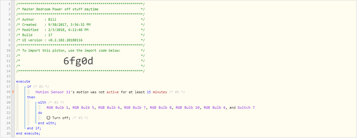

I know that ST motion sensors do not have constant communication with ST. So can someone explain to me how “Motion Sensor was not active for at least 15 minutes” works?
Does ST or webcore keep track of the last time the sensor was active in a variable somewhere?
What I was thinking it did was it would fire if, after some activity, 15 minutes have passed as inactive, it would trigger the piston. Is this correct?
Piston doesn’t seem to be firing as expected because lights don’t turn off after the room is empty for 15 minutes.
The lights turn off when the room is empty for 15 minutes.
The piston doesn’t seem to be executing, the lights are not turning off.
I suspect that I am using the ‘was not active for at least X minutes…’ incorrectly somehow. Does someone have an example of how this should be properly used in a piston?
WebCoRE schedules a wake up x minutes after motion… schedule is reset on each motion event.
Your piston should be working. Have you got any logs?
Might be that you need to be using the trigger (stays inactive) instead of the condition (was not active)
I tried changing it to stays inactive and it doesn’t seem to have made a difference.

I changed it to stays inactive for 5 minutes - how does it know how long the sensor has been inactive? Does the sensor report that information to the webcore piston?
It knows the last active time from ST logs.

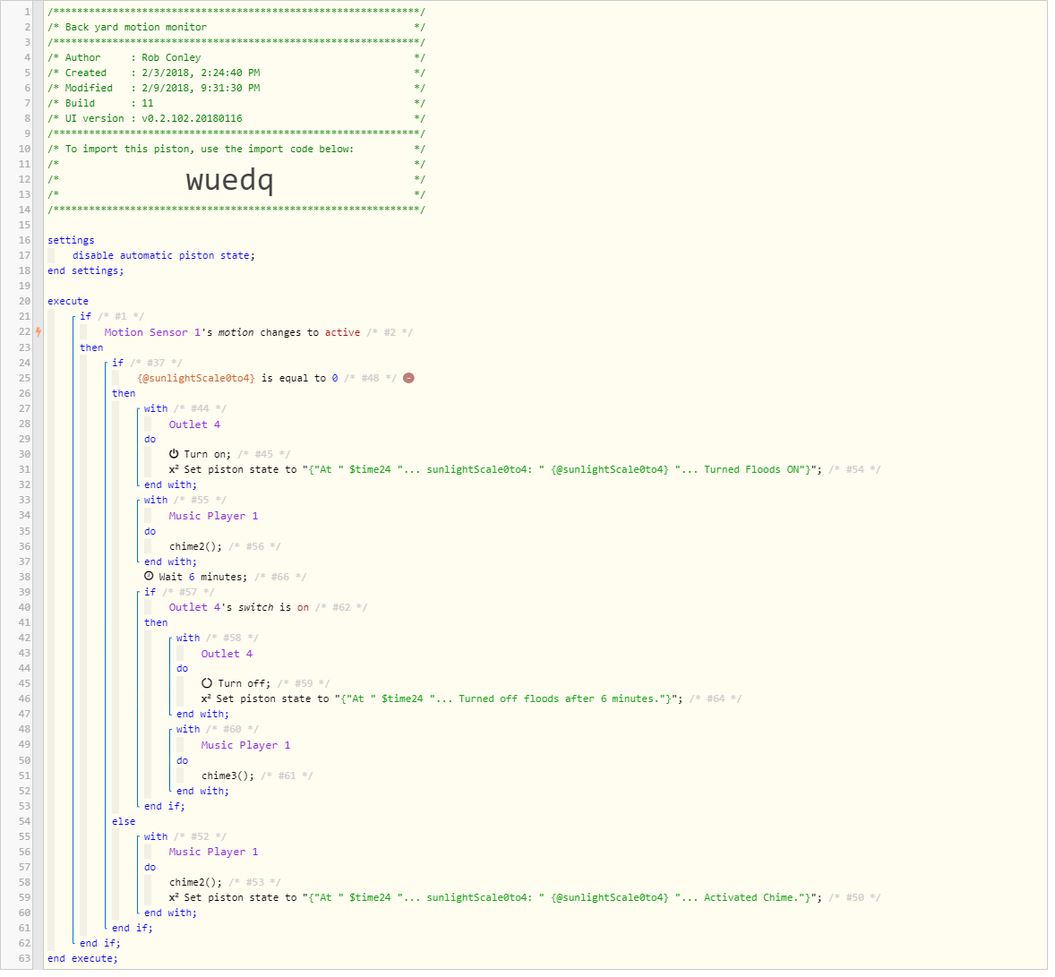

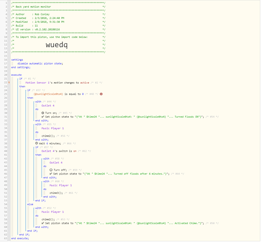

I had the off logic out from underneath the “changes to active” IF, with a “stay inactive for” event, but that wasn’t working either. So then I moved it under the ON logic, with a WAIT, but I’m thinking having it nested like that won’t work.
Waits don’t like "changes to active’…
‘Changes to active’ reverts to ‘false’ about 10 seconds after being triggered, which cancells the ‘wait’
Use ‘IS active’

So, in this one, am I handling “stays inactive for” correctly (with the changes to)?
#17
Test and you will see… looks ok.

Similar logic failed to turn off the light in my previous example. This one appears to be working correctly, but since it’s supposed to stay on until there’s plenty of daylight I’ll need to watch it for a while.
Back to the “if motion is active”, it’s fine then to use conditions as long as one understands what happens when mixing trigger and condition drinks?
