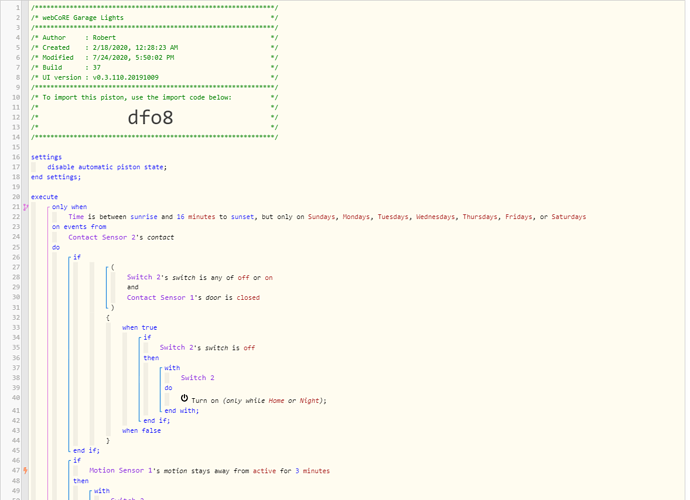

(Motion sensors, lights) This works but I am sure there is a better way
I am trying to make a piston that will turn the lights on in the garage “during the day” (sunrise to 16 minutes to sunset) but only when the door is closed. Also, at “night” (15 to sunset to sunrise) whether the door is big car door is closed or not. Also if motion is detected in the garage and the lights are off, turn them on and leave them on until the motion stops, then turn the lights off. There is no exact problem as it technically works but its a piston that has kinda grown out of control by me slowly adding in more products/sensors/switches over the past year and finally built it up to what I have here. The whole counting the number of door opens was when I didn’t have any motion sensors in the garage so I hacked my way around that till I could get motion sensors so that part can go. I just don’t know the best way to go about setting the motion triggers so that the lights will turn on immediately when the inside garage door is opened but also have the motion trigger the lights if you just happen to walk into the garage through the large door (say after work).
I don’t expect you to re-write the piston for me but maybe a general outline of the best way to go about this? I don’t think I used the ‘while’ loops properly here, they DO work but I am surprised that they do as far as I understand webCoRE the piston is going to basically get stuck at the while loop until there is no more motion but yet this doesn’t seem to stop any other functionality while in ‘the while loop’ if that makes sense.
Just stream line the code and make it more responsive.
As I said it is technically working but I think it might be a happy accident.
I know I should just put up a on event from the inside door sensor to turn the lights on if the proper conditions are met but then should I make another ‘on events from’ the motion detector or what is the best way to use them in webCoRE? I ask because I have seen examples that do not have an “on events from motion sensor’s motion” and just have “If motionSensors motion is active turn on the lights. If motionSensors motion stays inactive for 5 minutes, turn off lights” and I don’t see how that works without an ‘on events’ trigger.

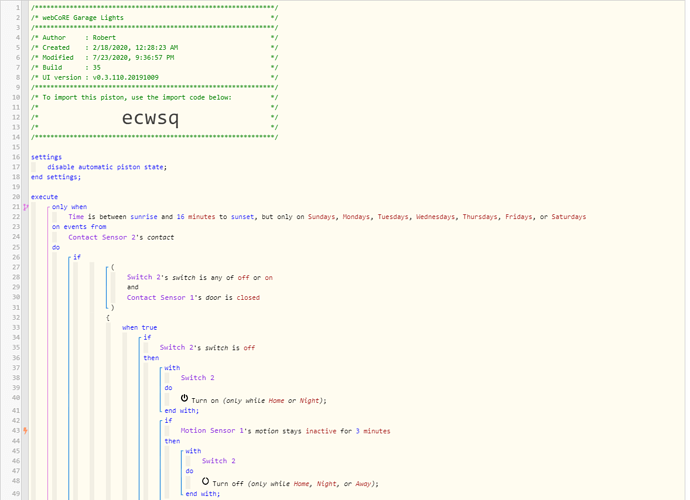

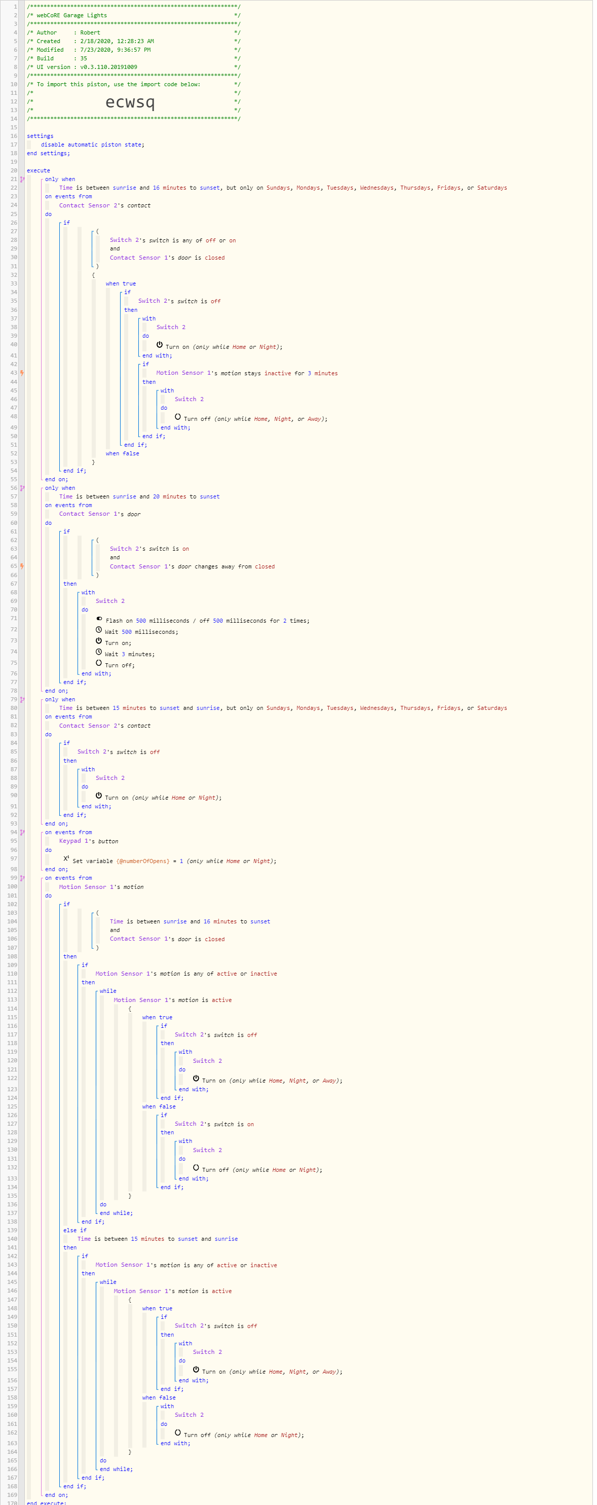

I tidied up your log so it is easier to read.
I made improvements to the code or at least simplified the first part but using an if statement to turn the lights off if motion sensor stays inactive for 3 minutes fails work just as I thought it would without an ‘events on motion sensor 1’s motion’
Here is the updated code
It did seem to work one as seen in the logs but I am not sure why it doesn’t know:

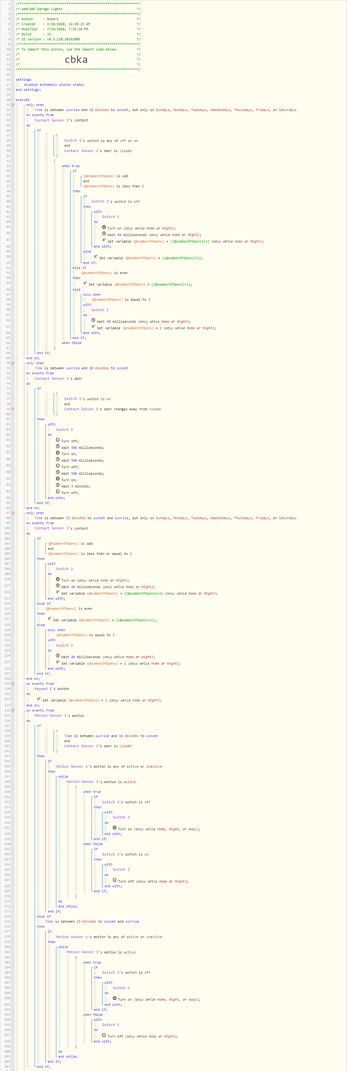

anyone got any ideas?
Here is an updated code and log that seems to work for turning the lights off if activity remains inactive for 3 minutes after turning the lights on but still have the same question about the while loops.
